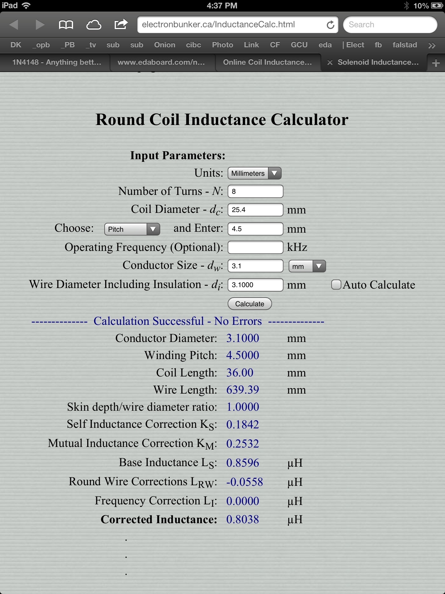

Using several online coil inductance calculators they all give me the wrong answer.
My original coil is, 8 turns, 1" diameter, 1.5" long, wound with #10 copper wire. Wire diameter is .125". Coil diameter is measured center line to center line of the wire. My meter reads .799 uh which is what I want target is .8 uh. Online calculator is telling me, .820, .821, and .820 uh.
My new coil is, 8 turns, 1.250" diameter, 2.875" long, wire diameter is .250"copper tubing, coil diameter is measured center to center like before. My meter reads .850 uh. Online calculator says, .727, 727, and 727.
I am trusting my meter to be correct. I was trying to use online calculator to wind the correct coil on the first try and not have to wind a dozen wrong coils to get it right.

Actually, the calculators are just fine. Your design data is wrong.
"wire diameter is .250"copper tubing"
That is not round solid copper wire. All calculators based on round solid copper wire will give what you consider to be inaccurate results because you are giving them incorrect information.

Interwinding pitch and skin effects with frequency both affect the inductance.
Meter must be calibrated to zero nH on short circuit with probes.
Use this calc instead. https://hamwaves.com/antennas/inductance.html

At these frequencies, hollow tubing is fine and my Calc link is closest one to NIST's formula.
The difference between thin tubing and solid wire is 50 nH per meter of wire. So, if you measure the actual length of wire (or tubing) used to wind the coil, and multiply the length by 50 nH, the inductance of the tube inductor will be smaller by that amount at low frequencies. At high frequencies, because of skin effect, the tubular conductor and solid conductor coils will converge to the same inductance value, because all current will flow on the surface of the wire regardless of whether it's solid or tubular.
The Hamwaves calculator uses Lundin's empirical formula which is much more accurate than Wheeler's empirical formula which is used on almost every other online calculator. My own online calculator uses the exact elliptic integral formula:
