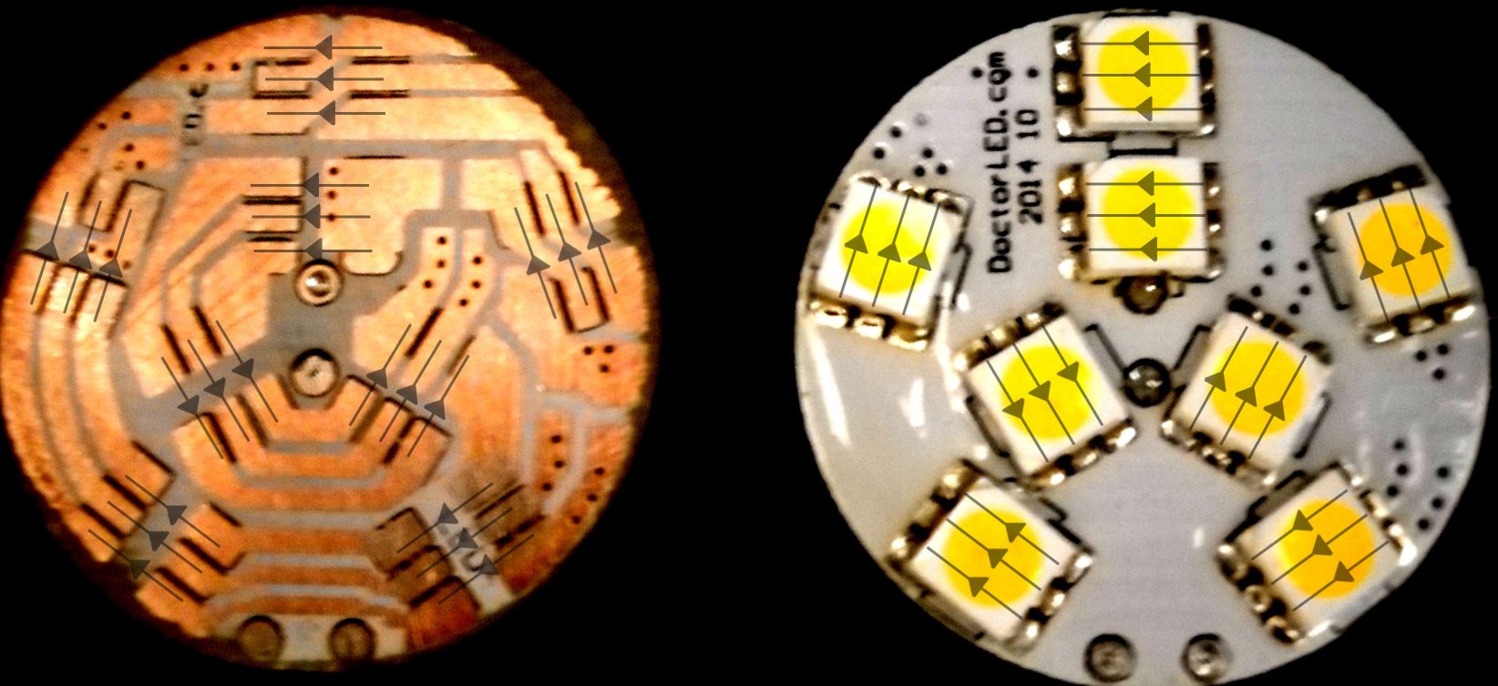

Okay, If you guys really want to sort this out, here is more info.
I realized later that I didn't finish my LED symbols before copying, pasting & rotating all of them.
Its not worth fixing them all now. Sorry about that.

Most likely fault ...
Florida Power Line transients
causing blown diodes from insufficient PIV, line filter and MOV.
Not recommended for Florida.
Florida has the highest frequency of lightning in the United States.

What's the failure rate being seen?
Is that 30/140 failure Rate? Do you want a solution or just a better product? Where installed? with above ground power lines? On a yacht or in marina?
They are installed on a 86 ft Hatteras yacht at a private house on a canal. They went out one at a time. We consider these a fire hazard and are replacing all of them. I think we have better ones now that cost 1/3 as much as the bad ones. We will see.

Unlikely to be much better without transient protection.
edit...
The type of transformer makes a difference how much coupling capacitance it has for transient impulses. Even though the transformer is 120:24 or 5:1, impulses may couple thru at a higher ratio with no capacitive load before the diodes. The 4 SMD diodes are often only rated at 70V or 100V which seems adequate for 24Vac but not ?kV transients.
Thus it depends on the transformer coupling C which means it can be attenuated with a plastic cap across the transformer output and serve all the lamps.
SMD 's are rubbish for this type of application. A set of 1N4007 (1Amp) or 5408 (3Amp) diodes are the better option for rectifying the 120 or 240 Volts mains.
24V AC transformers are often thought as low voltage but with unbalanced loads on loop circuits and transformer xxx pF coupling can pick up significant transients from nearby lightning.
If replacing, I would also add 40V range for minimum clamp level bipolar TVS clamps across each transformer 24vac output. with .CA suffix as voltage peak will be 24*1.4 at full load and add 10% for almost no load (LED) or +/- 37Vp ... assuming this is your situation.
