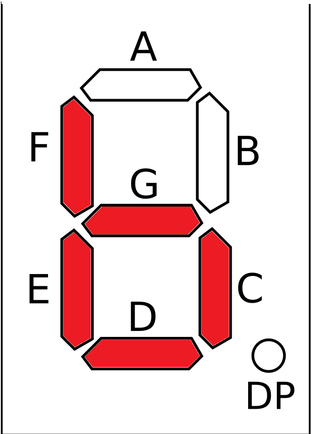

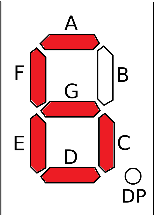

What's a tail???
Tail:
No Tail:
OH!!! I didn't know that's what they were... I always use the tail otherwise the 6 becomes a b..
With the code posted... It looks like the display out function is outputting a BCD value so the digits will be generated in hardware..... What chip drives the seven segment?
Hi all
Thanks for helping me. I check the circuit again and again. Last I found its come from Hardware. The circuit use 74LS47 IC. The 74LS47 has no tail for 6 and 9. So can you please provide a circuit for BCD to seven segment converter with the tail?
