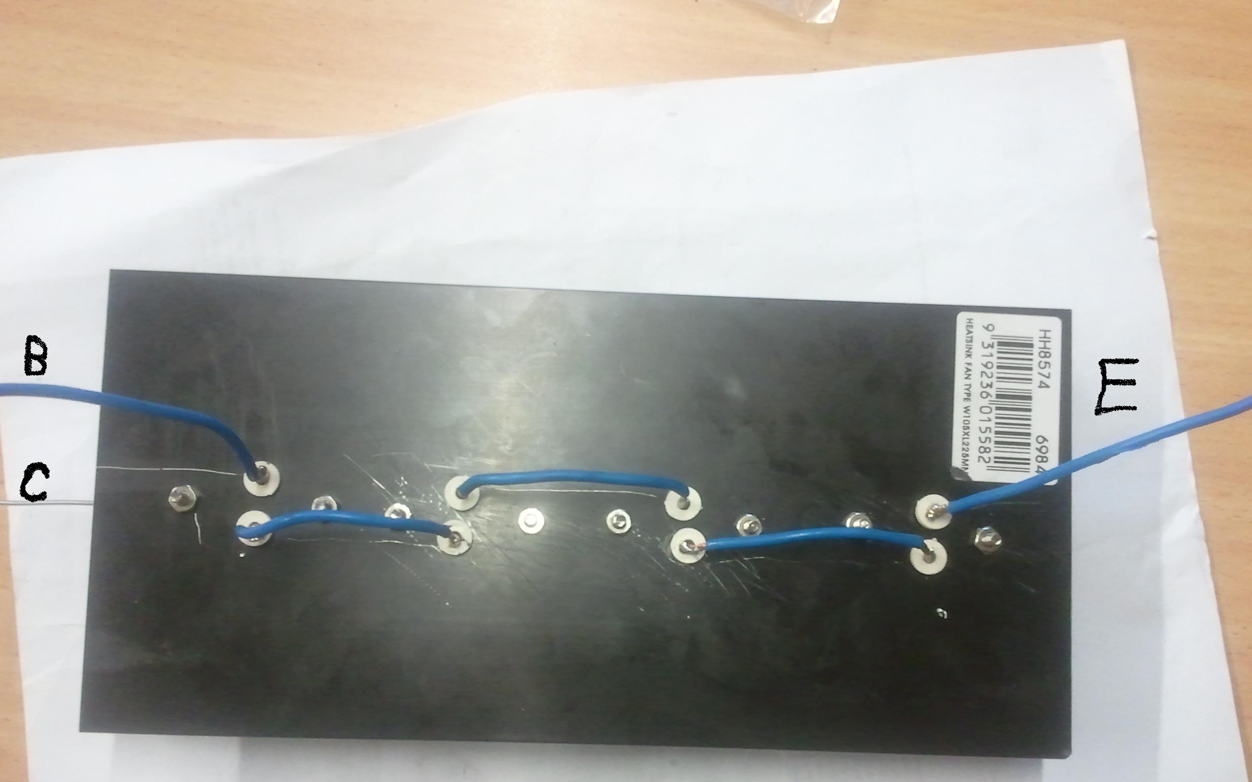

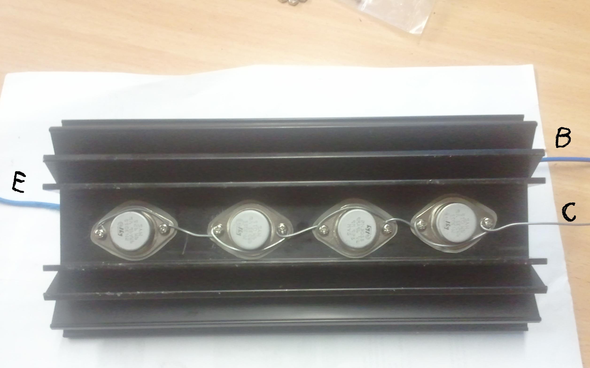

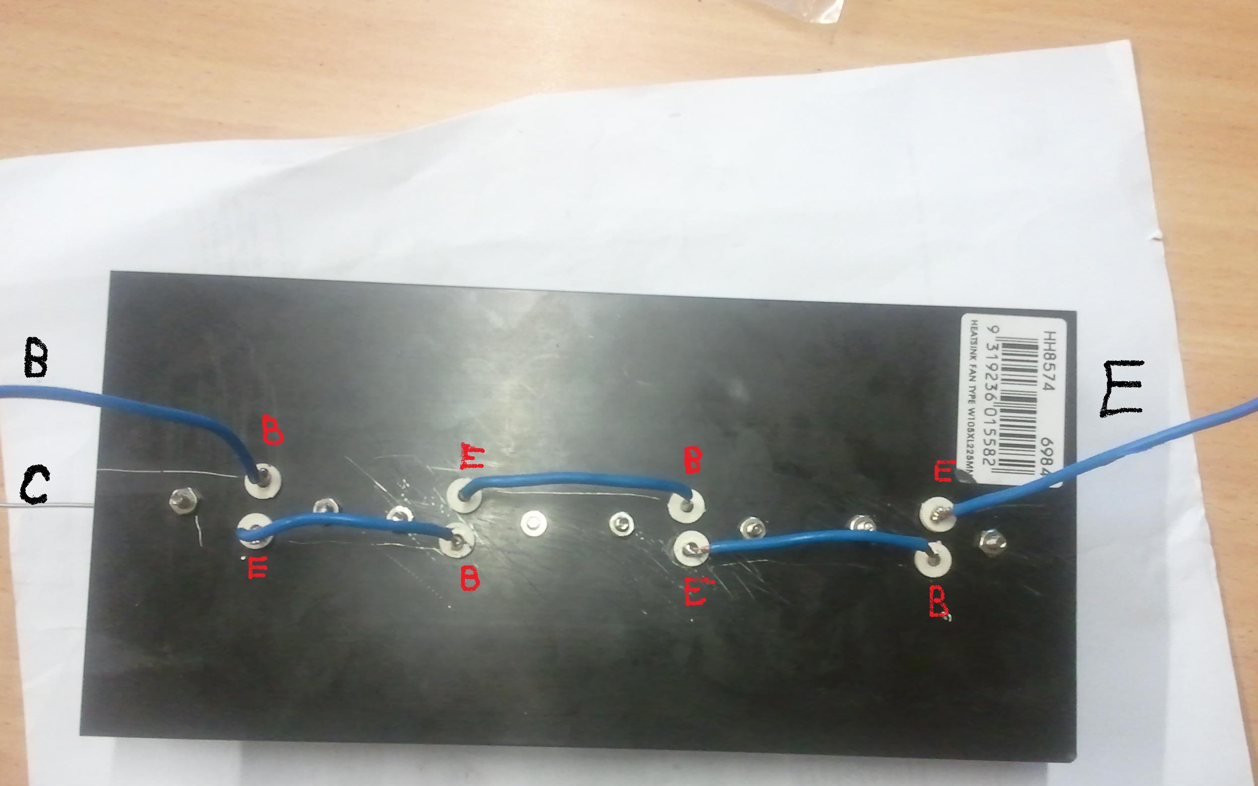

need help with flyback transformer
transistor

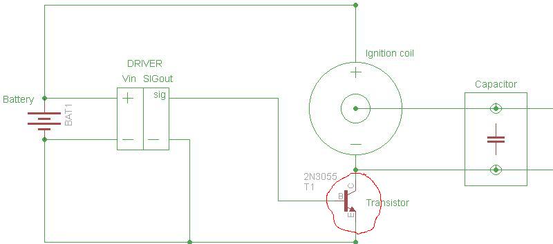

can some one check if this is connected ok
an how to connect all this in that secret diogram
thanks
an how to connect all this in that circuit diagram

Hi, Lev77. It is difficult to tell what all you have connected, but all of the bases should be connected together, all of the collectors should be connected (It looks like you already did that), and all of the emitters should be connected. You are basically building one large transistor out of 4 smaller ones.
this is how they all connected.... is this the way they have to be?
No. The bases and emitters should not be connected together at all. Connect each base to each base. Period. Then connect each emitter to each emitter. Period. Then finally, connect each collector to each collector. Period. Does that make sense now?
I just need to ask--Have you had ANY previous experience with electronics? Do you know what the transistor does and which pin does what?
HI, lev, in your diagram you have created a "Darlington Pair" this is for if you have 2 small gain transistors and need to multiply boost that gain. this is not what you want........
the way DERSTROM says to wire is in a parallel config,, the reason for this is you have enough gain, but you need to split the current between all 4 transistors evenly....so they dissipate heat evenly......

LEV, charging up a cap is simple, put the gnd terminal to gnd, and put the + terminal to the flyback, let it run for a second to charge, then even after you turn off the flyback the cap will still be charged, so take another ground wire and touch it to the +side to discharge it! (get ready for a bang!)
I used 1uF @ 4KV capacitor before i was satisfied, but make sure the cap can handle the voltage
BEWARE OF HV yayaya, touching a charged cap will zap you good, USE PROPER INSULATION GLOVES.
Proper insulation gloves for that kind of voltage aren't sold on retail. The type you would need are what linesmen use, and probably cost a few hundred U.S. dollars a pair. Not exactly easy to get a hold of. I would recommend just not going anywhere near the cap, and to discharge it by shorting the contacts with a long, well-insulated plastic pole. That's probably the safest way you'll find.
