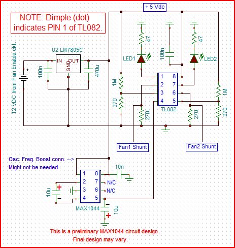

Actually i went ahead and wired the entire thing with both fans and the relay and the first led when both fans are running is out but the second one is on then when the 210f stat is triggered then the led comes on. So wjhen both are running pin one voltage is at 1.9vdc
At half speed run in series led one runs trough 2 shunts.... maybe making them 3feet long? Also what would happen if you increased the resistor rating from the led to a higher ohm? Wouldnt that drop the voltage? i can post pin voltages but when both fans are running at low speed the voltsges are really close to what you said

The resistor(s) in series with the LED(s) are "current limiting" devices meant to protect the LED(s) from damage. While it is true they dump some voltage it's so little that the overall voltage level across the devices is not significantly altered.
Very interesting how the circuit is responding. Might be able to salvage this after all. I'll play some more with the existing breadboard circuit, taking into your account of how it's reacting and see if I can get where we need to be, i.e., LEDs OUT when the fans are functioning properly.
Don't know which verion of the TLo82 you have, but the spec for the TL082C gives the max input offset as 15mV. Could that be causing a problem, given that your design input reference is only 7mV? Perhaps upping the ref to, say, 20mV would help?

As it stands, the sig off the shunt is generating 25 - 45mV +, so that's not being a problem. It is a problem, though, in how I've expected the TL082 to perform/react.
This project looked straight forward but is, as it stands, not something that one can rely of a SIM for a final, working circuit. I'm confident that it can be made to work - just more there than met the eye...

KISS provided a possible workaround (adding a negative 5Vdc to the TL082) that I'm going to try this weekend.
I'll post the results.
Ya you were right the shuts made it worse... burnt out an led as well. So how exactly would you add a negitive supply? Would this supply be going on the inverting input?
It's called a MAX1044. Readily available from Digikey, Mouser (https://www.mouser.com/ProductDetail/Maxim-Integrated/MAX1044CPA /?qs=sGAEpiMZZMtitjHzVIkrqUa/3DrsydEwOqnTvjSnloI= ), etc..
It supplies a -5Vdc at 20mA (from a + 5Vdc source) but used as the negative supply voltage (Pin 4) for the TL082, it only has to suppy <10mA, which makes sense since the +5Vdc supply is carrying the LEDs' load. The - 5Vdc supply is providing the negative rail for the circuit and little else. Being able to get the comparators outputs to drop below 0 (zero) volts makes the circuit work a advertised.
I'm ordering a couple tomorrow. When I get them I'll test it on the TL082 comparator circuit I have breadboarded, and let you know how it goes.
If it works, and I fully expect it to,, this will be a simple fix with minimal alteration (you may have to replace the TL082) to the PCB circuit you have already built.

So, a negative supply, if used, would connect to the V- pin of the OP amp. Certain OP amps are designated as "single supply", but not without issues namely operating close to the power supply rails. In your case 0V and 5V. Voltages have to be above a certain value: e.g. 200 mV and the output can only got to 1.2 V of the supply for one particular single supply OP amp. I picked an early single supply OP amp. Now, you can operate closer to the rails, but not close enough. So, a negative supply allows one to have signal inputs and outputs nearly 0V. In some cases, a "rail splitter" is used, but then the OP amp in your case would have to operate at +-2.5V as power.

Trent,
Here's a revised (preliminary) schematic for the TL082 comparator circuit:
No significant change to the current board you've made.
---->> <EDIT below> PIN 2, NOT Pin 3!
In the SIM, by adding a negative 5 Vdc source to pin 4 and a 45mV sig to either pin 3 or 6, the outputs of the TL082 swung from about + 3.75 to - 3.75 Vdc, fully turning off the LEDs, one at a time. And the load on the negative supply was < 11mA, well within the sourcing ability of the MAX1044.

KISS, Thanks. I tried something like that (although without the diode) but it didn't help. Shouldn't need that with the neg supply to the TL082, right?

Yea, kinda forgot your driving an LED and not a 12 V relay. You might add a IN5404 (reversed biased across the 12 V power) and a 18 V Bidirectional or Unidirectional Transorb or TVS diode just to protect the circuit in general from the automotive electrical system.

Ok. Got the MAX1044s today.
Used one of them in a breadboarded TL082 comparator circuit, as configured in post #70, and the whole thing worked as advertised :)cool:).
I did not check for ripple but should you get some noise (from your radio, for instance) add the lead from pin 1 to pin 8 (as shown) and that should eliminate it.
I used both electrolytic AND tantalum 10uf caps in the MAX1044 circuit and both worked well.
Interestingly though, the tantalum caps provided a very slightly lower output from the +5Vdc input, i.e., -4.80Vdc with the tantalum vs. -4.78 Vdc with the electrolytics. Don't know why. Maybe different ESRs. Of course, that difference has absolutley no effect on the circuit.
