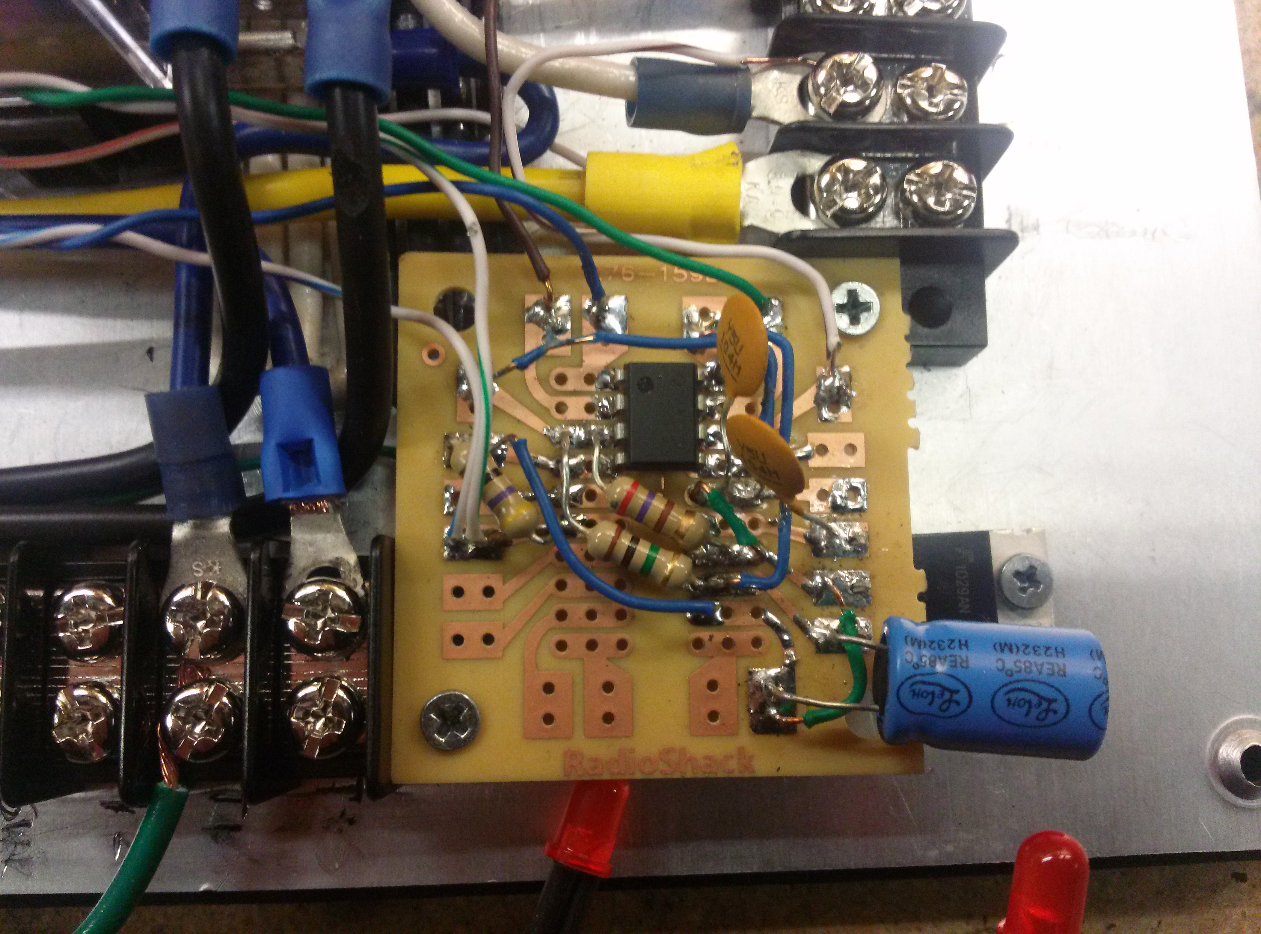

Applied resistors it had no effect. Also is it possible i might have got this op amp in upside down? There was a indented circle on the top left in the plastic which i just assumed was pin # 1. Could this op amp be defective like the regulator? Is there any way of troubleshooting that? attatched a pic of what it looks like so i didnt have the 270 resistors on 2&6 yet.

Trent,

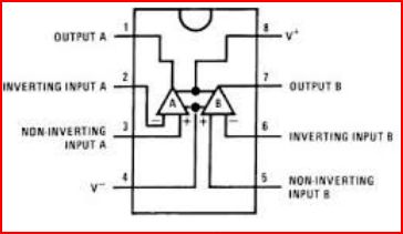

Thanks for the pic. And I now see the problem. And I'm afraid it's partially mostly my fault. I made some assumptions that were in error.
The TL082 is a dual OpAmp package:
Note pinout numbering and description.
The schematic I provided was a representative diagram for only ONE of the two OpAmps in a TL082 and the pin numbering used in the schematic are irrevelant (read WRONG) for the actual wiring of the chip. This is an artifact of the SIM Spice model I have for the TL082.
I will post an amended wiring diagram shortly...
My apologies for this mistake.

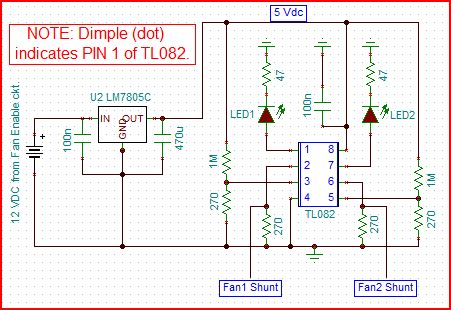

Here's the correct schematic for the TL082 Dual Comparator circuit you need:
<EDIT> I think it's best to build the circuit without shortcuts. Using a larger PCB might also be a good idea, at least for the prototype.
I would suggest that the PCB for this circuit be placed as near as possible to the LEDs (inside the vehicle). Might also be a good idea to use an 8 pin DIP socket for holding the TL082 chip (makes it a lot easier to replace, should that be necessary).

Built this again new parts new resistors to your schematic and the new one does the exact same thing LED's constantly on same readings as before
Ok.
Try this.
Everything powered OFF.
Disconnect the fan shunt lead from pin 2. Power up the TL082 circuit. Presumably LED1 is ON.
If so, momentarily jumper from pin 1 (5 vDC) to pin 2 of the TL082. Does LED1 go OFF?
I'll wait if you're still on-line.
<EDIT> Trent, I know this is frustrating, but the circuit works. Just trying to determine why it's behaving the way it is...

No but it does dim the LED by at least half
Ok.
I know this is frustrating, but bear with me.
Fan shunt still disconnected. Jumper from pin 8 to pin 2. What does the LED do?
Ok.
Soemthing is, obviously, not right.
I gotta hit the sack.
One last thing, if you would - measure the voltage on pin 1 with and then without the jumper from pin 8 to pin 2 and post those values. At this point I suspect it wont be that different, and that's the problem.
I'm going to breadboard the circuit tomorrow AM and confirm. The SIM says "fine" but...
Ain't electronics FUN!! :banghead: :banghead: :banghead:
2.21vdc with jumper and without
Not good. I'll post my results with the circuit today.
