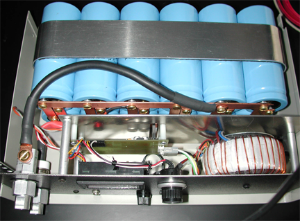

Here is a capacitor bank I made a few years ago:
I used copper rails. They were plenty strong. Brass will work too. Will you be using screw connections to your capacitors or wire? If it is wire, is the wire copper or, more likely, plated steel?
