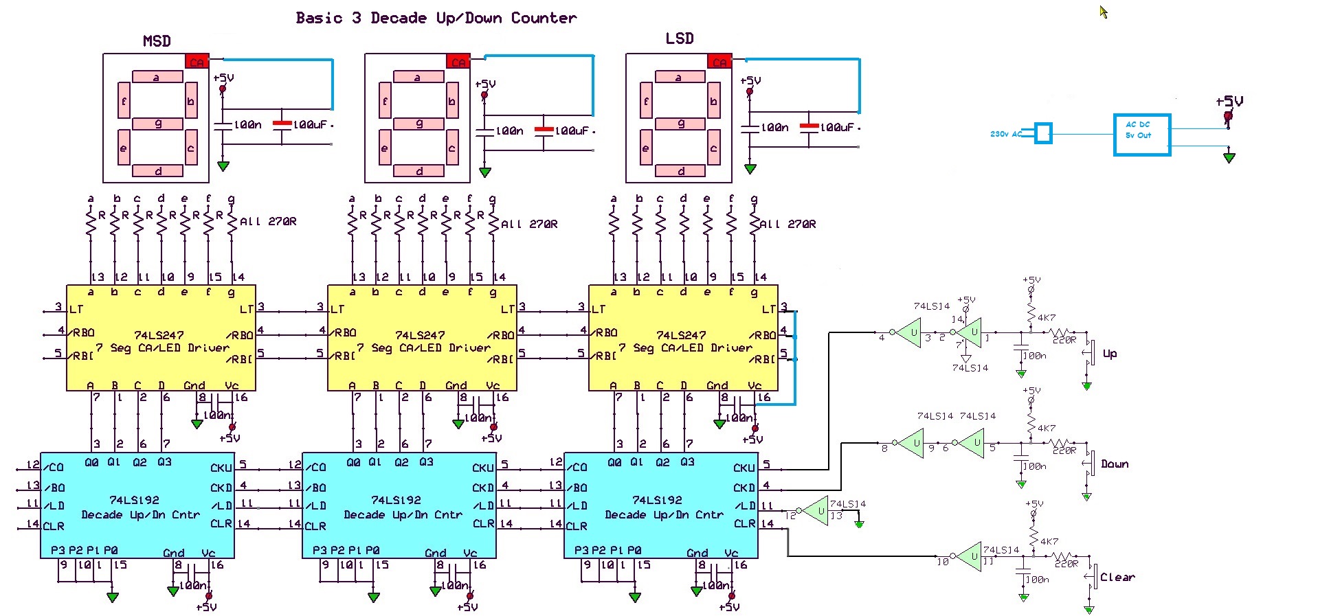

The drawing ist exactly what I need. So thank you for that!
I want to built an up down reset counter with 3 digits. So i´m taking the drawing of the "basic 3 decade up/down counter and combine it with the "two digits up down counter" by using its 74ls14 drawing. that should work, right? I also attached the combined drawing.
I have a question about the 5v Input and the 100n and 100u capacitor. are those two before all the other 5v inputs (on the chips and the 7seg display) or only before the 7seg display (because there the input are not marked red).
the 5v input (on the right hand side) on the 74LS247 isnt "saved" with an capacitor. is that right?
And one last question: beacause here in berlin i can not find the 74LS192 chip. Could i also use the 74LS193 and use your drawing?
here is a link of the datasheet for the 74ls192 and 193 http://pdf.datasheetcatalog.com/datasheet/motorola/SN74LS193.pdf'
Thanks a lot so far,
Paul
No, the'192 is a decade counter, ie it counts from 0 to 9. The '193 is a four bit binary counter, ie it counts from 0 to 15.
I am sure that somewhere in Germany there are some 74LS192 chips!
There is a decoupling capacitor on pin16 of the '247, just connect pins 3,4,5 to pin16, it will be OK.

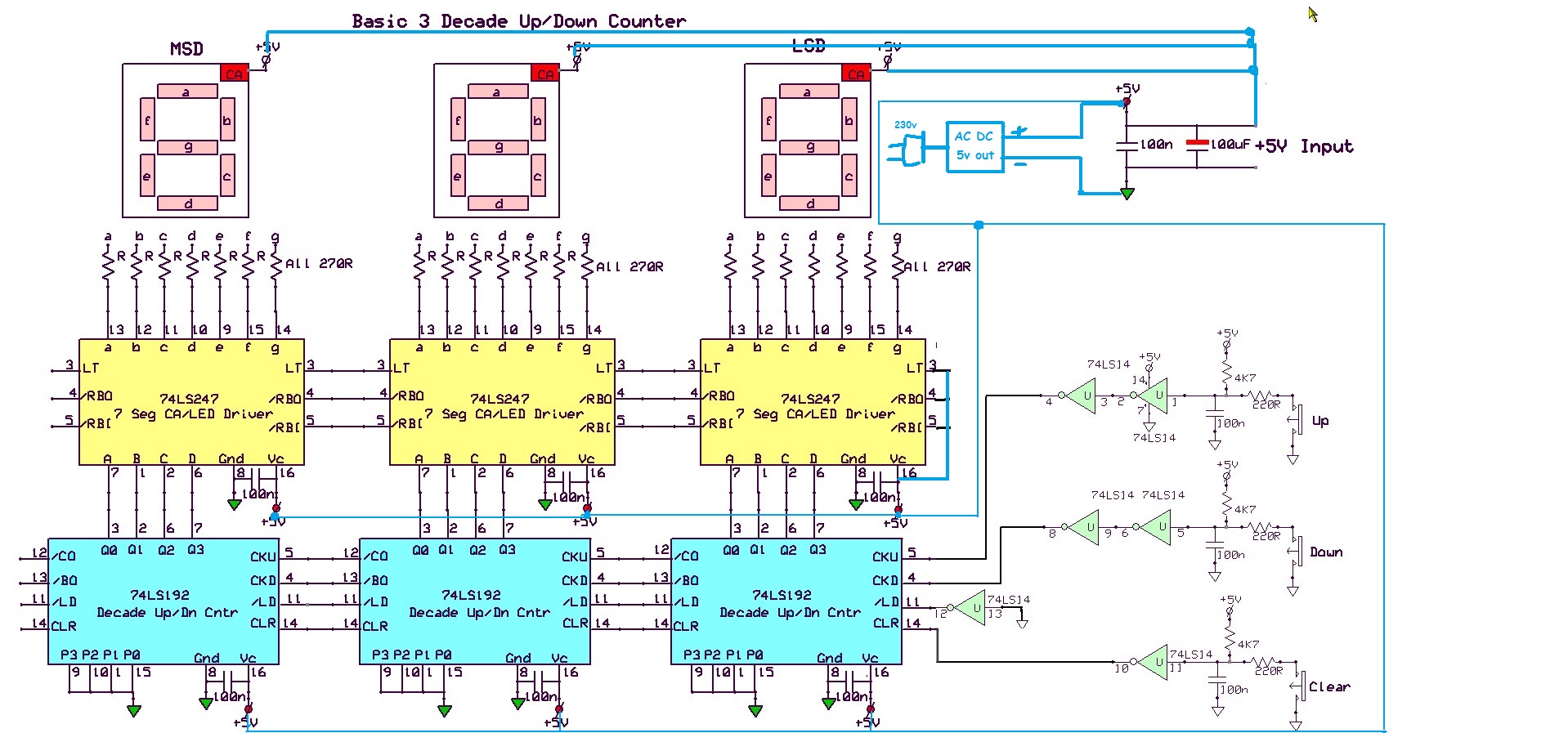

Hey JimB,
thank you for your help!

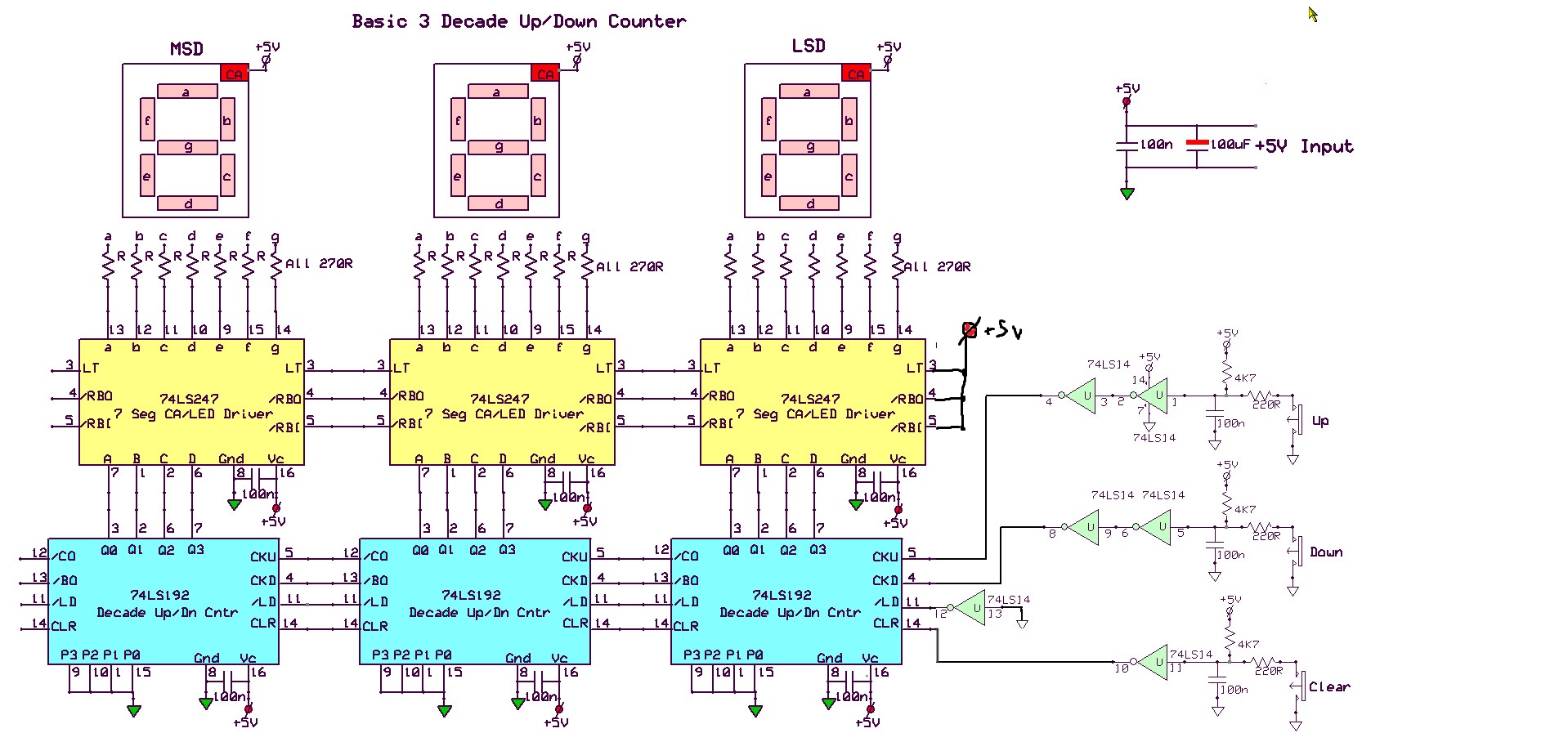

So I´ll find the 74LS192 chip. And connect the pins 3,4,5 as you said (see picture below).
Maybe you can also help me with the power-supply-thing which i´m not shure about.
I did different drawings (in blue so you know what i changed) on the drawing. Because I´m not shure how to connect the powersupply properly to the chips and to the 7seg Display. What do you think, picture (1) or (2) or none of those? does the CA sign on the displays mean Capacitor?
(1)
(2)
Common Anode.
hi V,
The decoupling you have shown in your figure #2 is sufficient.
