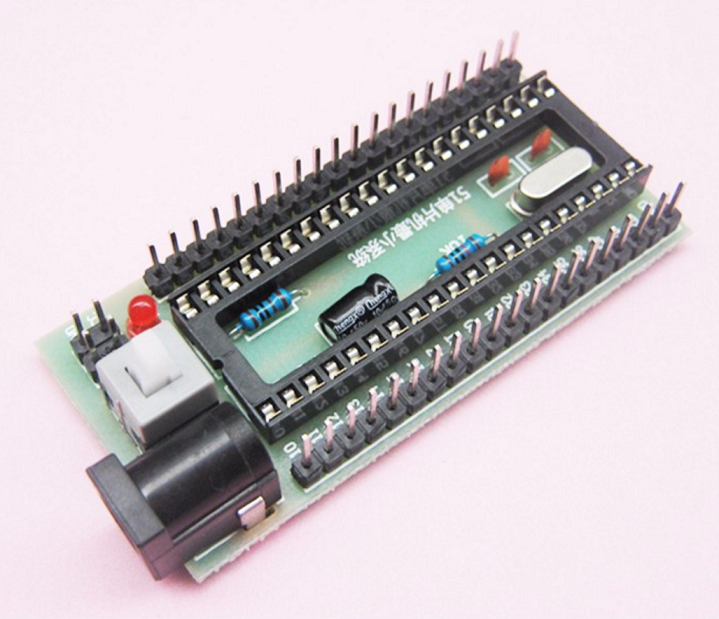

  11. Mike - K8LH
    Mike - K8LH Well-Known Member
    Joined:
    Jan 22, 2005
    Messages:
    3,641
    Likes:
    109
    Location:
    Michigan, USA
    Ian, please, don't worry about it. Let me try these other IDEs.
    Thanks, guys. Cheerful regards, Mike
  12. Mike - K8LH
    Joined:
    Jan 22, 2005
    Messages:
    3,641
    Likes:
    109
    Location:
    Michigan, USA
    • Like Like x 1
  13. Jon Wilder
    Jon Wilder Active Member
    Joined:
    Oct 22, 2010
    Messages:
    859
    Likes:
    82
    Location:
    Fresno, CA
    Now that thing is cool! The only thing that would complete it would be a ZIF socket.

    Hi Jon.
    I've got my AT89S8253 samples, the little 88 cent development board, and I downloaded Keil, so with a bit more research I think I'll be ready for a programmer of some sort. I came across this chaps' Arduino AT89S52 Programmer and Windows app' and I might give it a try. If you get a chance, tell me what you think...
  17. Jon Wilder
    Joined:
    Oct 22, 2010
    Messages:
    859
    Likes:
    82
    Location:
    Fresno, CA
    The AT89S8253 uses a slightly different programming algorithm from the AT89S52. While the AT89S52 uses a 3-byte protocol, the AT89S8253 uses a 4-byte protocol.
    Did your dev board come with any programming software to use with it?
