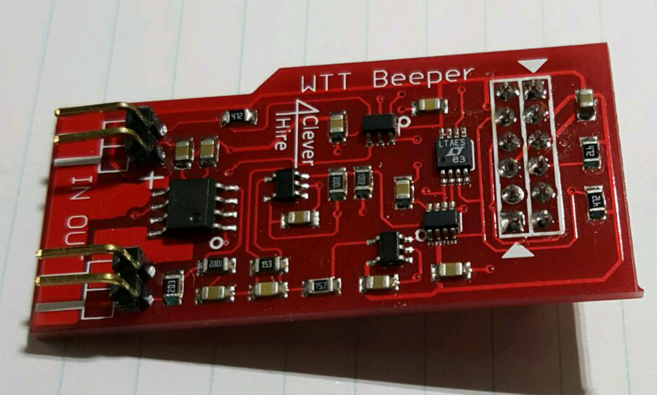

You seem to have read a different set of replies than I see here. Not too long ago, I thought changing the volume on a piezo beeper would be a piece of cake. I was mistaken, and in the end, replaced a piezo beeper with a subminiture speaker and a 6 IC circuit to have controllable volume and frequency.

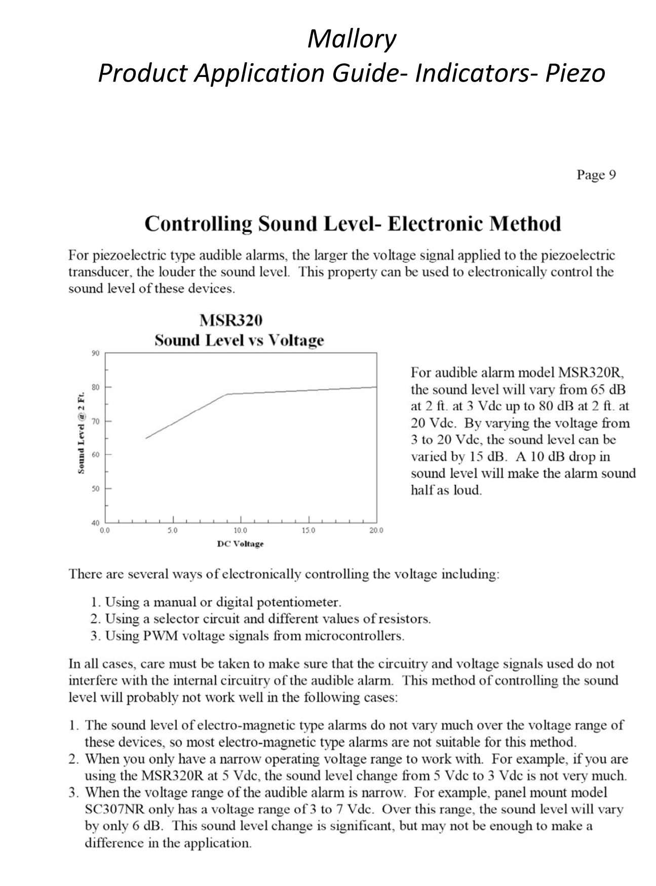

Well into my quest to control volume on a piezo beeper, I came across the following few paragraphs in the middle of a product data sheet. Yes, you can control piezo beeper volume, over an extremely tiny range if you don't care what the beep sounds like.
Have you ever wondered why you can't find a piezo beeper with a volume control? Because you can't change the volume enough to matter.

This photo shows my solution to controlling piezo beeper pitch and volume. A controllable oscillator chip feeds a square wave to an integrater stage that converts the square wave to a triangle wave for a more pleasant tone. A digital pot controls the level of the signal to an amp chip that drives a speaker. I wasn't able to find any approach to changing volume on a piezo beeper in a meaningfull way otherwise and believe me, I looked for easier ways!

Sorry, but you're making a big fuss over absolutely nothing, the volume from a piezo speaker is completely dependent on the voltage applied to it (exactly as a normal speaker), lowering the voltage lowers the volume exactly as normal.
The reason you're confused is that you were using an active beeper, where the electronics are built-in - thus you have no control over anything, other than the power supply feeding it.
It's a simple enough process, a piezo speaker (or any piezo element) bends in direct relation to the voltage applied to it, applying an AC voltage makes it bend back and forth, this produces audio. The higher the voltage the more it bends, and the higher the volume - apply too much and it cracks and is destroyed.
Have you never seen a crystal earpiece?, that's just a smaller piezo disk in a convenient plastic moulding - plug it in your radio and the volume control of the radio adjusts the volume in the earpiece perfectly.
