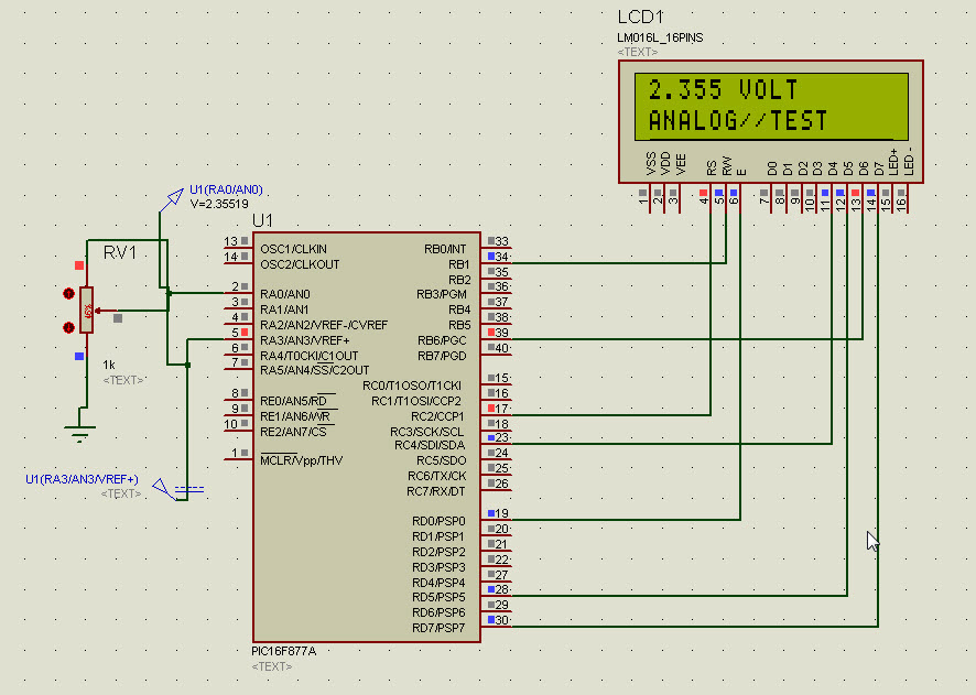

need a help with interfacing lcd with pic16f877a in asm ?!
thanks all for your appreciated effort :)
the problem was in these lines
BSF STATUS,RP0 ;SELECT BANK1 TO
BCF STATUS,RP1; ACCESS SFRs IN BANK1
BSF LCD_D7_Direction
BSF STATUS,RP0 ;RETURN TO BANK0
the last line should be
BCF status,RP0 :(
to return back to bank0
the final lcd.inc

and here is an example to print the analog value on lcd

        addwf   Tens,f
        swapf   NumL,w
        andlw   0X0F
        addwf   Tens,f
        addwf   Ones,f
        rlf     Tens,f
        rlf     Ones,f
        comf    Ones,f
        rlf     Ones,f
        movf    NumL,w
        andlw   0X0F
        addwf   Ones,f
        rlf     Thou,f
        movlw   0X07
        movwf   TenK
                    ; At this point, the original number is
                    ; equal to
                    ; TenK*10000+Thou*1000+Hund*100+Tens*10+Ones
                    ; if those entities are regarded as two's
                    ; complement binary.  To be precise, all of
                    ; them are negative except TenK.  Now the number
                    ; needs to be normalized, but this can all be
                    ; done with simple byte arithmetic.
        movlw   0X0A                             ; Ten
Lb1:
        addwf   Ones,f
        decf    Tens,f
        btfss   3,0
        goto   Lb1
Lb2:
        addwf   Tens,f
        decf    Hund,f
        btfss   3,0
        goto   Lb2
Lb3:
        addwf   Hund,f
        decf    Thou,f
        btfss   3,0
        goto   Lb3
Lb4:
        addwf   Thou,f
        decf    TenK,f
        btfss   3,0
        goto   Lb4
        retlw    0x00
;DELAY 1 SEC ROUTINE 4MHz oscillator
DELAY_SECOND:
    MOVLW .5 ;.10==B'00000101' 8MHz OSC
    MOVWF D3
LOOP3:
    MOVLW .200 ;.200==B'11111111'
    MOVWF D2
LOOP2:
    MOVWF D11
LOOP1:
    NOP
    NOP
    DECFSZ D11,F
    GOTO LOOP1
    DECFSZ D2,F
    GOTO LOOP2
    DECFSZ D3,F
    GOTO LOOP3
    RETURN
END
regards
