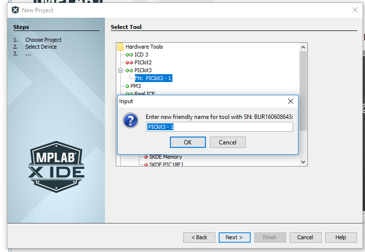

    I don't no if I'm wasting time but I took a screenshot for you how to name your pickit3 when you have more then one

    Hi Burt,
    Thanks for trying to help but the only way to get two clones working appears to be that you have to change the serial numbers somehow. Setting a friendly name doesn't help as they both get the same name.
