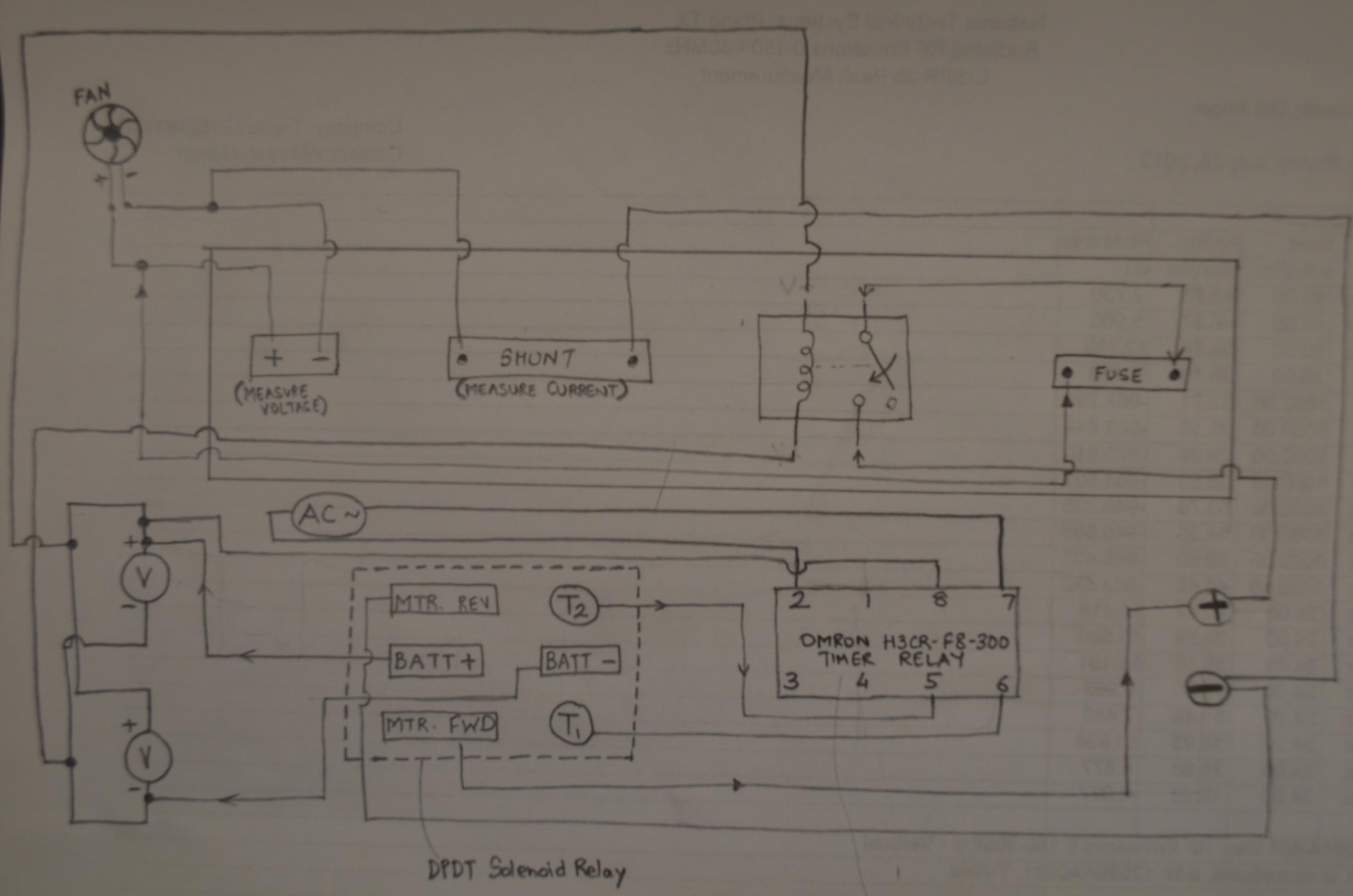

I have an automotive fan that I need to run in the forward & reverse direction. For that I have the 12V Motor Reversing Intermittent Duty DPDT Solenoid. I have the DPDT solenoid coil terminals connected to the NC & NO on an Omron timer relay H3CR-F8-300. I am able to achieve the rotation of fans in both directions.
Issue: The OFF time period for the fan
Duty cycle for the fan.
Forward ON-1.5min, OFF-1.5sec
Reverse ON-1.5min, OFF-1.5sec
I have set the timer relay as per the duty cycle. The fan runs correctly in both directions during the ON cycle for 1.5min, but it does not follow the OFF cycle of 1.5sec.
The DPDT solenoid switches its polarity in less than 1/10th of a sec.
How can I have the OFF cycle adjusted?

I'm confused (and maybe you are as well). Are you not describing a three-state state-machine? How do you expect to put the motor into one of three states (stopped, CW, stopped, CCW) with a device that has only two positions (states)?
Hint, you need to use TWO relays...

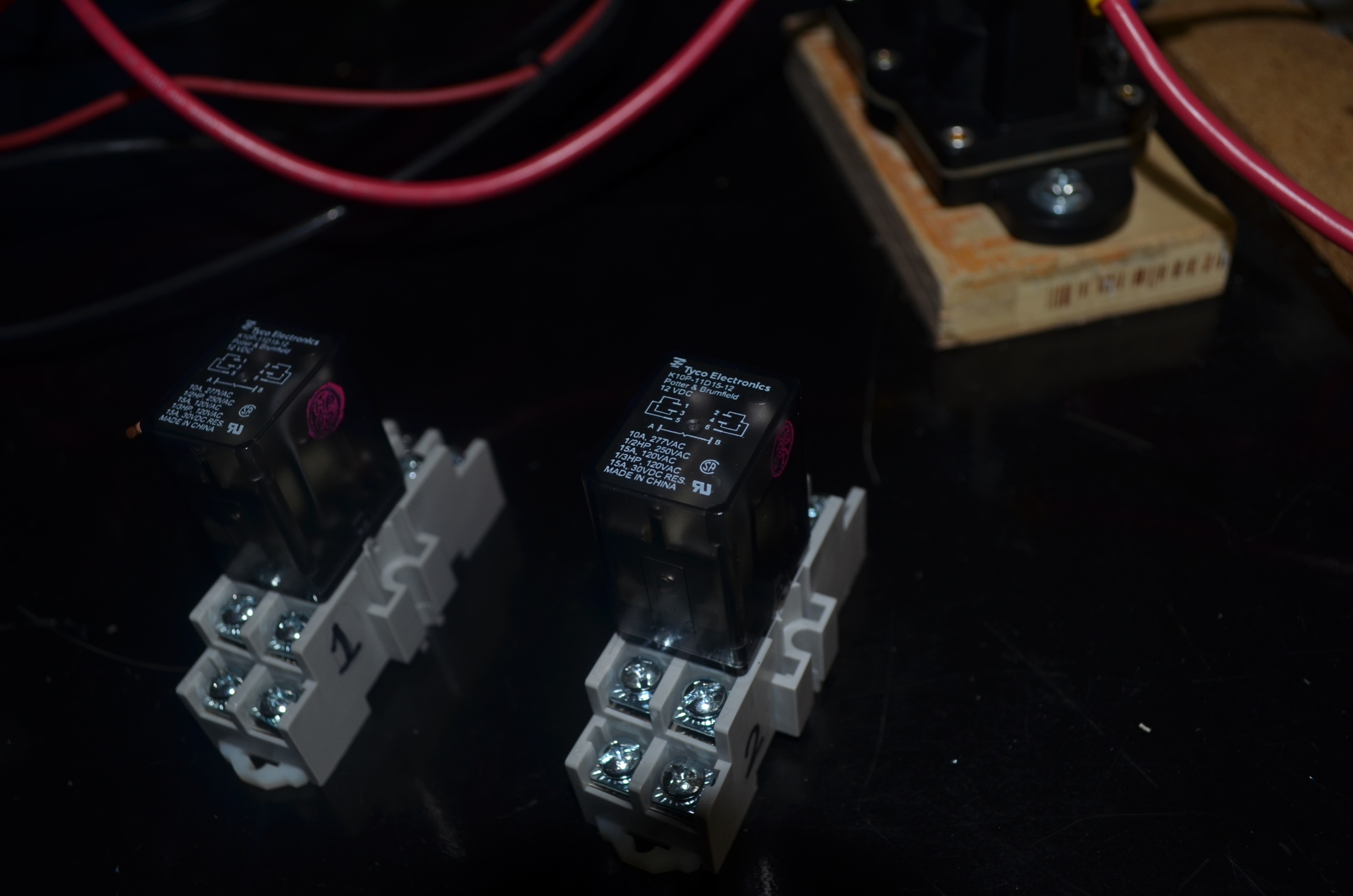

The next step I did was make a latching relay using 2 DPDT miniature relays. I thought that might help in the stop cycle, but it didn't. Most probably I am having the connections wrong I guess. I have a decent understanding of relays and what the terminals do but when it comes to connecting it to the other things in the set up I get confused. I'll try to attach a drawing & a picture if possible.

You need to treat the timer relay as a free-running oscillator, with a duty cycle of 90s On and 1.5s Off.
Use the timer relay contact to apply power to the motor ( so it only runs for 90s).
Behind the timer, you need a "toggle" (a.k.a. Flip-Flop). It can be a solid-state IC chip or a network of relays (search for toggle relay on this site, there have been several threads).
The toggle relay output is used to reverse the direction of the motor. Note that this conforms with my earlier statement about needing multiple relays
It's a very basic drawing. I hope it helps.
Your solution lacks the "divide-by-two" functionallity that the toggle (flip-flop) would provide. The toggle makes it so that the motor can run forward/reverse on every other cycle of the timer.

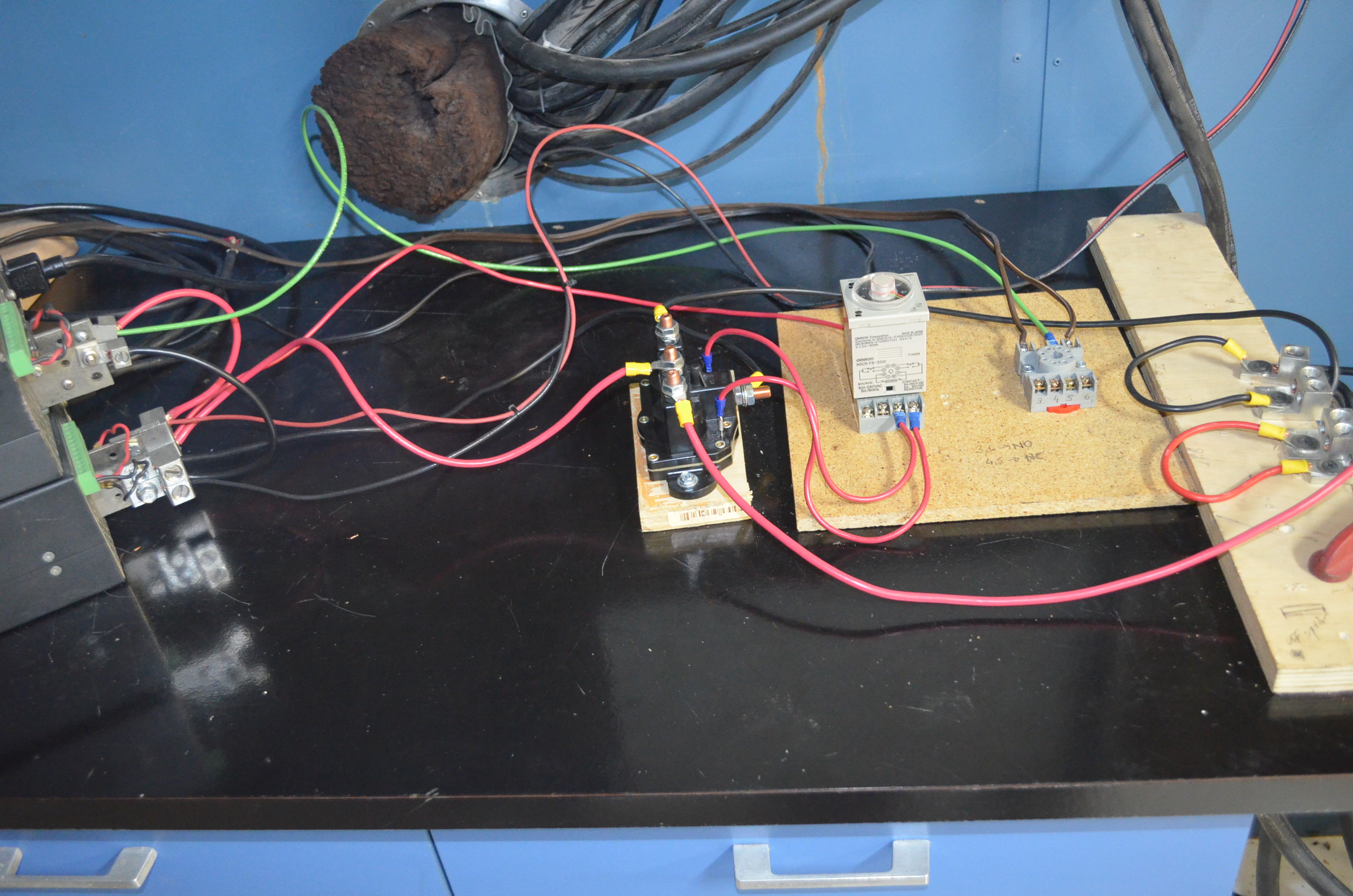

I am attaching a few pics of the test set up. Hopefully that will help a little more.
The first 2 pics shows the test set up. The 3rd pic is the 2 miniature DPDT relays that I had thought of for making a latching relay.

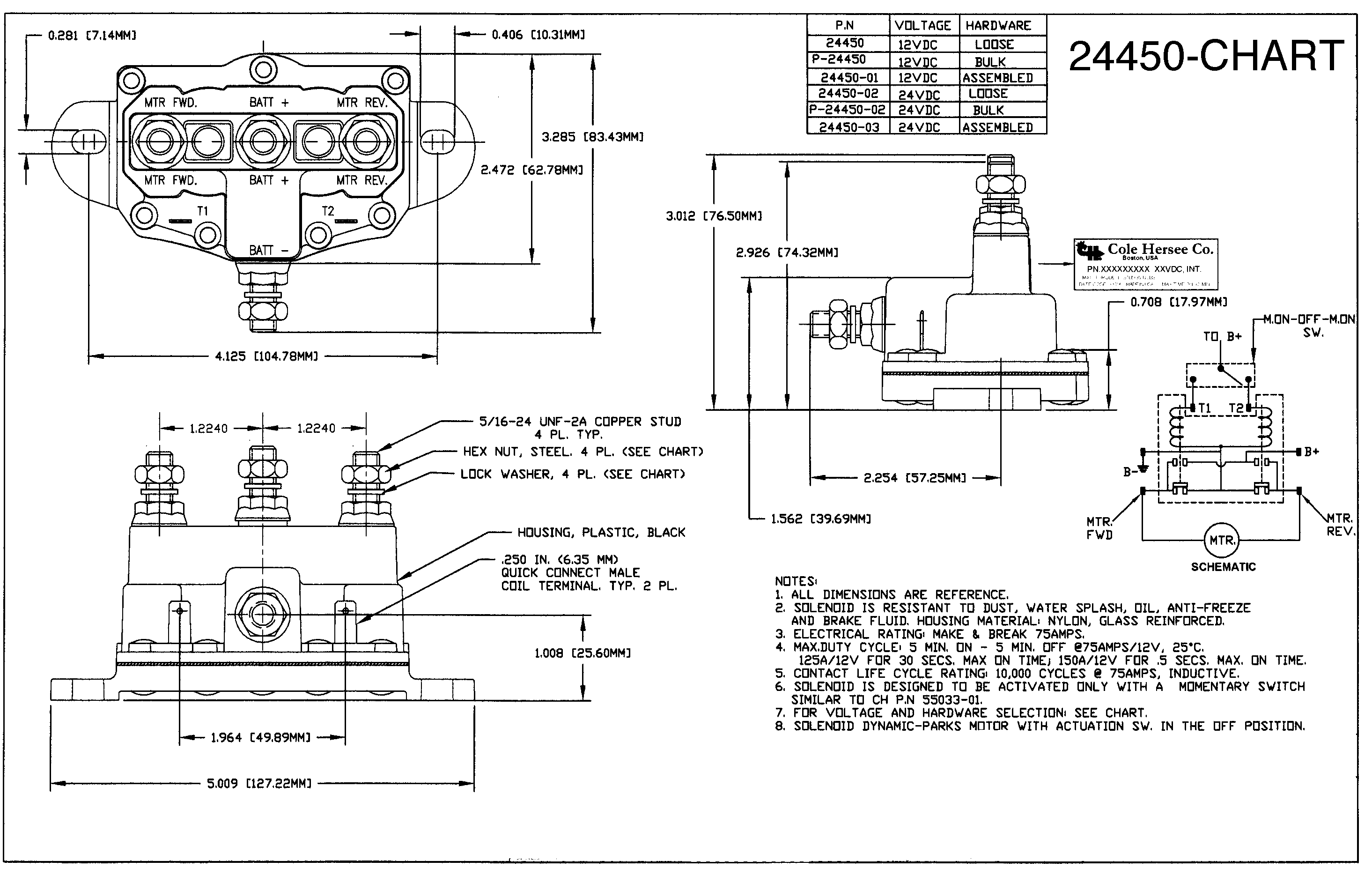

Schematic of the DPDT reversing solenoid
Ok, I see that what I have been saying is correct. The reversing relay you linked has two momentary pulsed coils. To reverse, you must pulse the two coils alternatively. You would have to build a "toggle" to go between the timer output and the two coils. It is up to the toggle to produce the two alternating momentary pulses for the two coils.
In the toggle made from relays that I linked to, there is no reason that you have to use a momentary push-button. That contact could come from the timer, instead...
I just downloaded the timer data sheet. It does NOT have two alternating outputs.

So do I need to use another timer as well or do I need to use a latching relay (3rd pic shows 2 miniature DPDT relays that I thought I'd use to make a latching relay). I find reading the schematics a little confusing.
Reconfigure the two latching relays into a toggle as per the web site I linked.

What exactly do you mean by timer does not have two alternating outputs? How does it affect the set up that you have mentioned?
Thanks.
No. It is because the timer has only one output that you need to add the toggle behind it.
