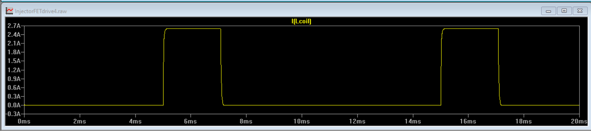

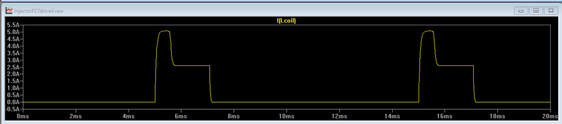

Here's the pulse timing with R3=220Ω, R4 and R7 both 100Ω, R5 removed and Trim2 set half-way:
And here's the timing as above except with Trim2 set to zero:
The 'fire' pulse portion is missing here, because the inductor current doen't have enough time to build up.
I don't advise removal of R5. It's there as a safety feature to keep the M1 FET switched off in the (unlikely) event that the 555 timer output became disconnected. Whether or not R5 is present makes virtually no difference to the pulse timing.
Note that with R3 now =220Ω, if Trim2 is set close to zero then about 50mA could be flowing through the trimmer. Depending on the particular trimmer you have, that could be a tad on the high side.

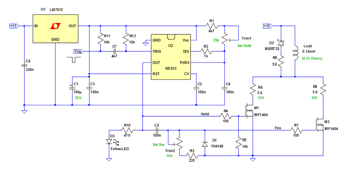

Here's a circuit mod which adds R11, R12 and C7 to ensure the trigger pulse at pin 2 of the 555 is very brief even if the supplied trigger signal from the engine gets stuck at 0V:

If the trigger input (from the opto) is held low, does the trigger voltage at pin 2 of the 555 also stay low?

If pin 2 is staying low then check R11/R12/C7

R11, R12, and C7 create an edge detector. The R12 side of C7 should only go low for about 100 uSecond, even if the R11 side goes low and stays low. So if both sides of C7 are always at the same DC level, then something is wrong. Check for a short across C7.
Or, if there is enough noise on the R11 side that couple multiple edges through C7, then it could be that the 555 is being constantly retriggered.
Time to get the o'scope out and start poking around.
I presume if input at 2 is low, the output to the FET gates would be transient determined by set pot 1.
Your presumption is incorrect. If pin2 is kept low the timer output (pin 3) will stay high for as long as pin 2 is low, so will not be determined by the Trim 1 setting. That's why, as Chris has explained, you need to check C7 (and R11/12 as I mentioned in post # 92).

Of course its the cap!!!
Its not there!

When you say you are now using 12V, are you inputting that to the 7812? (Is so, the rest of the circuit will be getting only about 10V if the regulator is working).
If you are measuring only 4V at pin 4 something is clearly wrong. The pin 4 voltage should be the same as the pin 8 voltage and the regulator output voltage.
Hopefully we can save you a road trip to the wilds of Wales by running a simple test or two. So, first test :
1) disconnect the injector and in its place connect a 1k (or thereabouts) resistor as a dummy load,
2) disconnect pin 3 of the 555 from R4 and C5,
3) make a temporary connection from pin 2 of the 555 to ground (pin 1),
3) with 15V at the regulator input, take measurements of the voltages (referenced to ground) at all eight pins of the 555 and report back. This should tell us if the regulator and 555 are still working.
