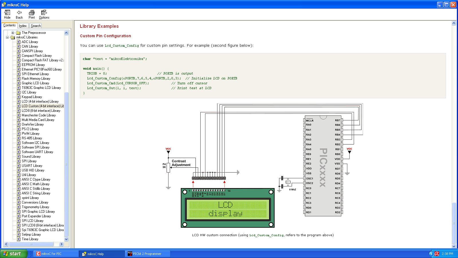

You missed a part the part in red
[COLOR="Red"]char *text = "electronics";[/COLOR]
void main() {
  TRISB = 0;                // PORTB is output
  Lcd_Init(&PORTB);         // Initialize LCD connected to PORTB
  Lcd_Cmd(Lcd_CLEAR);       // Clear display
 [COLOR="Red"] Lcd_Cmd(Lcd_CURSOR_OFF);  // Turn cursor off[/COLOR]
  Lcd_Out(1, 1, text);      // Print text to LCD, 2nd row, 1st column
5 313 Too many actual parameters lcd.c
6 324 Undeclared identifier 'Lcd_CLEAR' in expression lcd.c
I believe that is telling you that the constant Lcd_CLEAR is not recognised, I would try using LCD_CLEAR instead, or you can look in the file lcd.c and see how they defined it there..

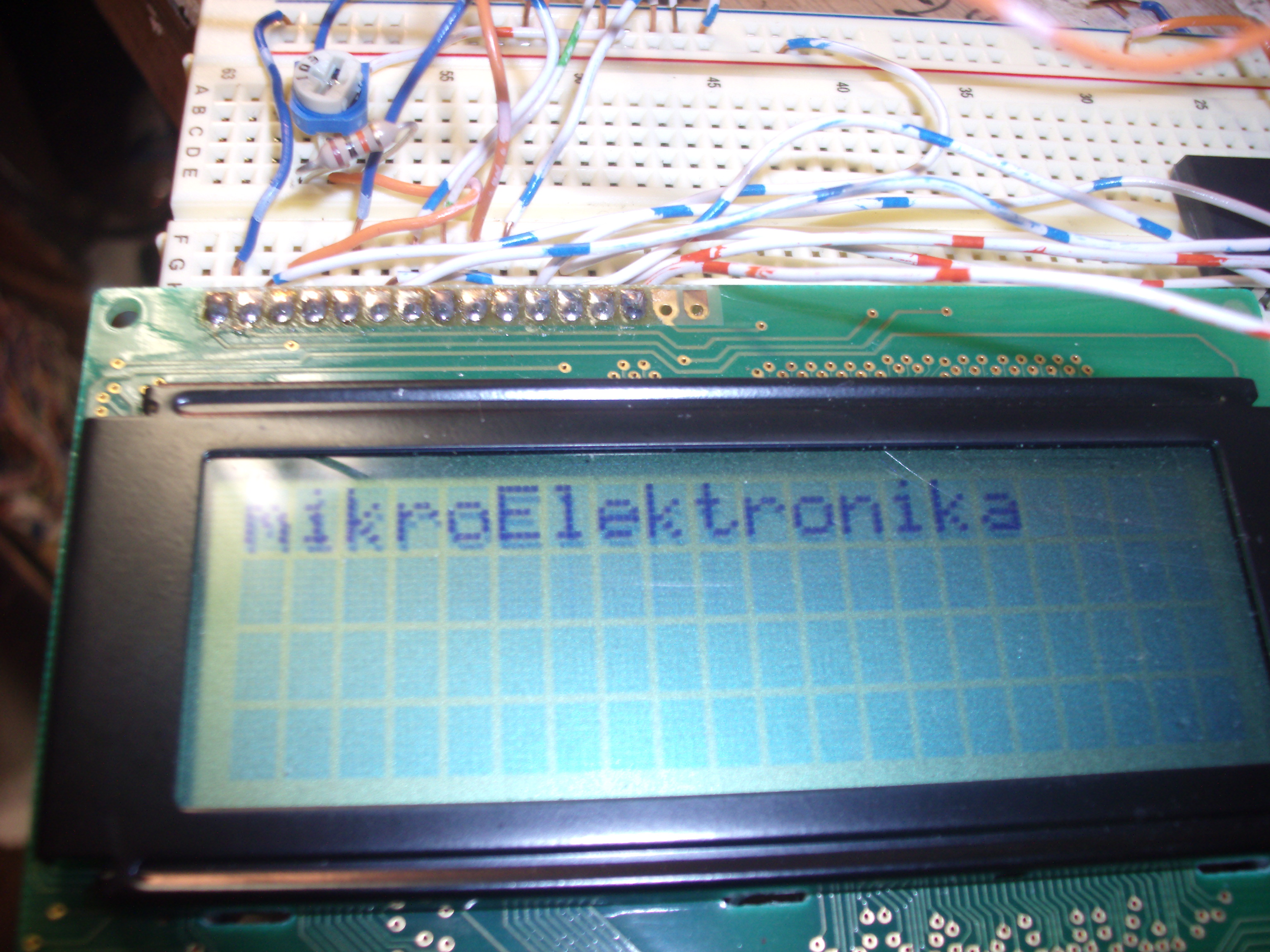

and it's in microC PRO
Here a little video not real good but you can see how it works
[embed]http://www.youtube.com/v/vdww6_fM9L0&hl=en&fs=1&[/embed]

Hey einton / be80be,
I am interested to know if you resolved your issue.
I'm having similar issues with an 4x20 LCD and a PIC18LF4580.
I'm using mikroC PRO (09 version), and PICkit 2 programmer.
I've copied and pasted the sample code, tried both PORT A and B, tried using RB2-RB7 rather than the RB0-RB05 pins that are in the documentation. Tried 2 different PIC18LF4580, tested every wire and rebuilt the circuit several times just in case I couldn't see an obvious errant connection (forest from the trees type error).
The LCD lights up, the contrast adjustment works and I adjust the contrast I see that line 1 & 3 are solid. In fact this is the case if the PIC is not connected at all.
I am buggered if I can work out why I don't get any text on the screen.
Did you get yours working? if so, what was the fix?
It seams so simple, yet I've spent hours trying to work it out.
Any suggestions?
Cheers,
Doug.

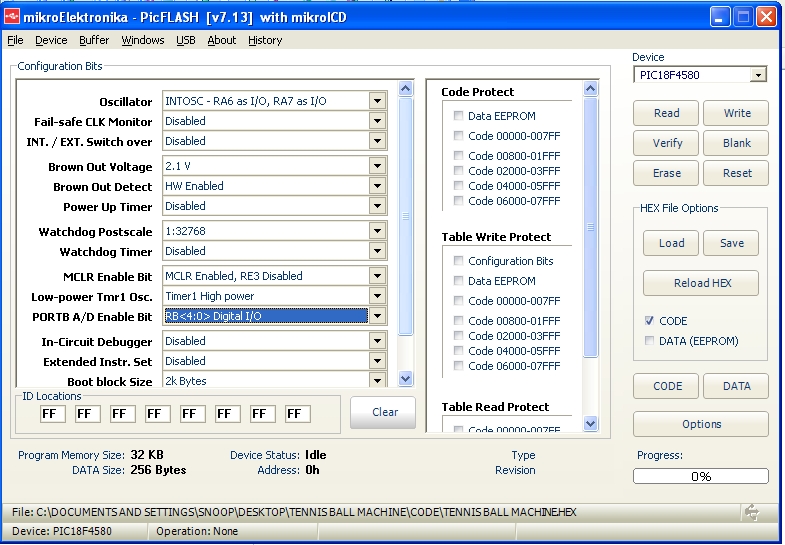

Did you ground all unused pins on the LCD if not all you'll get is the is a bunch of square boxes when the LCD lights up
Yep, pins 1, 5, 7, 8, 9 & 10 on the LCD connector are all grounded.
My thoughts are:
a) I am selecting something wrong when saving the hex file (pic attached) or
b) LCD unit is faulty
The PIC controller is definately functioning, I have tested 2 units and other programs work fine.
I have made sure the power to the PIC is going through a regulator with 2 caps to make sure that its nothing to do with power. (I have heard of people having issues with PICs resetting if the Vdd is not isolated)
Is it possible that this particular PIC requires some other setting or code to get it to work?
