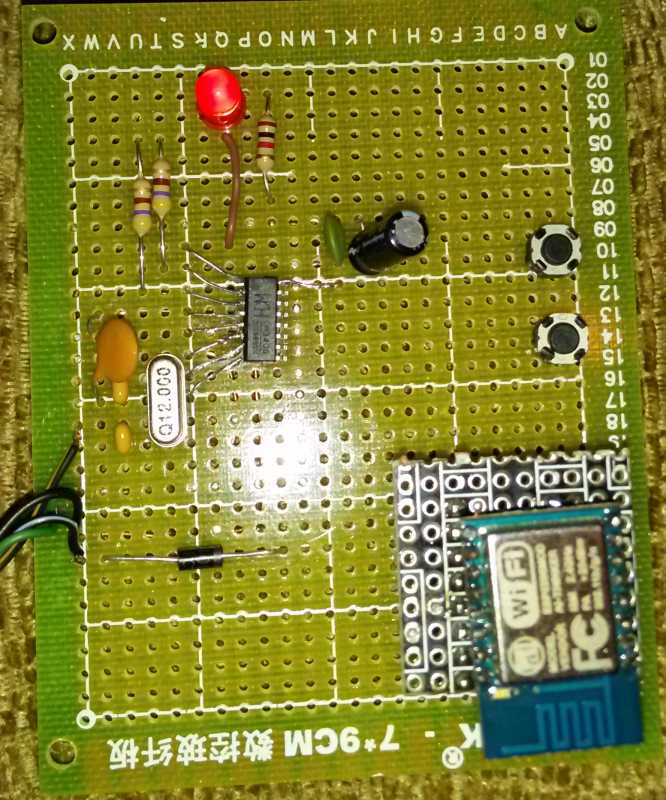

They work good from what I see but to be reliable your code needs to be in firmware. I've used them as web sever and to switch stuff on over the net.
But code in firmware let's you have more space then running lua or arduino code. I put one on a board and added a ch340g chip worked out good just hard to solder the little ch340g usb to tll chip.
Those show you what you can do using arduino and yes they work to a point and the point is it's dark outside your wife logs in to your esp 12 to turn on the lights oh the dang thing offline you say honey it should be running and should of turn on the lights. It's not reliable using arduino code and lua.
there easy to use not reliable. Code thats complied in uses lots of the less ram
