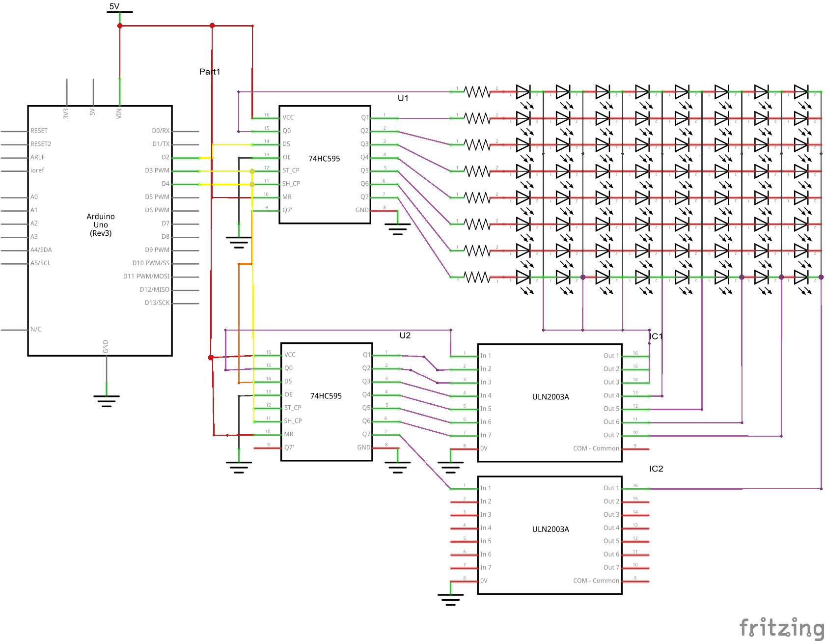

Right, topic says my problem quite well, i managed to build circuit and code for 8x8 matrix to display and scroll 8x8 patterns.....but obviously that's quite limited! I could use pre-made libraries but managed to do this without, but i can't figure out how to make longer chains of text? as now both shift registers use same array and a++ counter, if i increase array and count sequence, columns mess up. i tried to makde x as 16 rows long and clumns would be a / 2 = 8 maxinum but no avail. all i've gotten is mess. any tips? of course i could build bigger square matrix and add more shift register but than i'm again limited by 16 rows of text, that only moves the problem to future....not needed! schematic is as follows and code so far:

Hey Ian, this is what i have so far
what i want, is so i can make longer chains of text/patterns, that scrolls like this:
The idea is... Grab a 5x8 font from the net!! Create a 24 x 8 buffer and draw the string to the buffer ie
signed int x = 24
print at x--,0 " HELLO WORLD!!"
When you bitblit the string only the part in the buffer will be seen!!
ah, so that's the basic idea, hmm, but, what about when i control two shift registers that are chained together? does that complicate things? other controls columns and other rows
hehe, in fact, i made it working, will post it soonish, if you could tell possible improvements like making that ''string'' more neater, it's not in array yet.
only 3 pins from micro! (of course power line too, but they won't count....)
Here we go

Like I said... Grab a 5x8 font off the net..
The font will start at ox20 ( space ) and run to 127 ( ~ ) you can then load them whenever you want..
If you look at the tutorials I did of Nigel's Pic boards ( tutorial 13.2 ). I show how to print a full string to the led matrix.. https://www.electro-tech-online.com/attachments/tutorial13-zip.60067/
You will see how I grab a font character and load the matrix..
signed int x = 24
