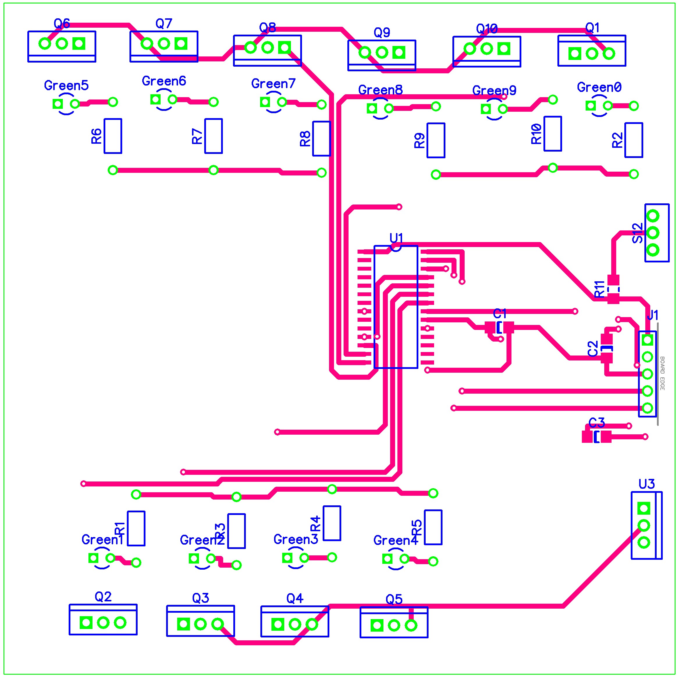

Started cobbling a pcb design but yes it needs work and add some headers to facilitate connecting the leds plus a power connection.
There is room for additional channels. Board is 10cm x 10 cm. Uses smd but room for dip sockets if desired.
I,have lots of free time, what with all the rain we are having to build these boards etc. if M smith wants them built or a diy using dip sockets.

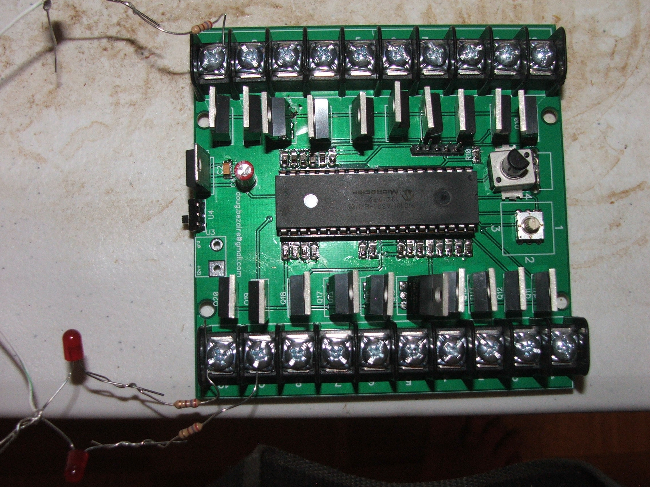

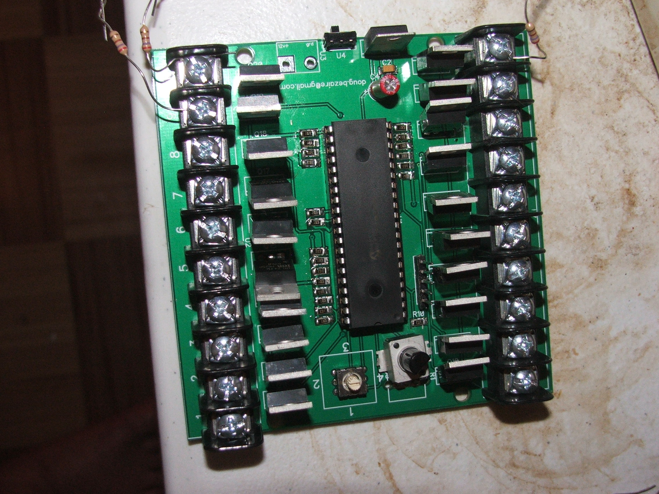

Well, MrDeb took the lead on the project. At this point, I hace loose 3w led lights on my desk and should have the first board on the way. Once we confirm desired operation, the rest of the boards will be put together. I have a new prototype prop to build. The band director revealed the theme of the show, Magnetic. The props are designed to be compass needles, or a representation.
Mike I need an address to send one completed board. Will email you just in case you don't see this.
The board I have completed is ready for shipment but still working on 4 programs but may only end up with two??
Will try and take a pic of completed board for members to view.
I located my sim card for importing camera pics. I don't have and never wanted a smartass phone. Too expensive each month
here are two pics of same completed board. Yes It is a 40 pin dip socket pic. Makes it easier to make desired program changes in the future, Cheaper to ship 10 chips than 10 completed boards. Each board, according to my scale is 5.660 ounces or 160G
That doesn't look right but that's what the scale says.
