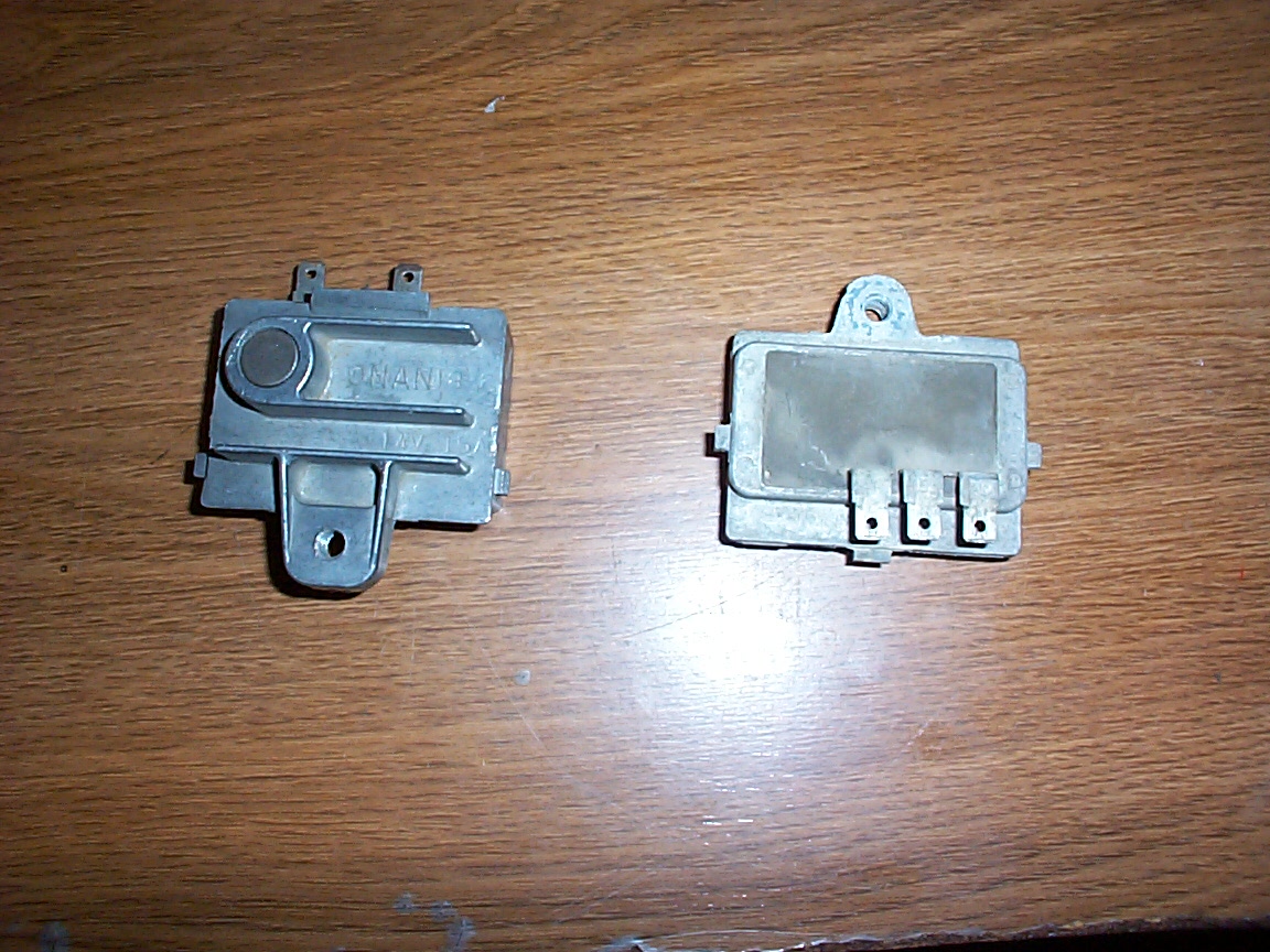

It may be easier to just isolate the magneto leads and then run them to a common off the shelf charge regulator like what is on many small engines. Check with you local lawn and garden service shop or automotive store.
They are about the size of a deck of cards and have a three terminal connection. Onan, Kohler, B&S all use a similar design so just ask for one of those and compare the price.
They run around $25 - $40 and take a two line AC input from a magneto type alternator and convert it to a regulated 12 volts at up to around 20 amps if the magneto can supply that much.

Here is what they most commonly look like.
These are old 14 volt 15 and 20 amp units. I pull them off of junk riding lawn mowers and other equipment at the scrap yard when I find them being they rarely ever burn out.
They use a simple two AC line input and a single positive output line with the case as the common ground. It cant get much smaller or simpler.

So counting the frame ground, there are four connections? Presumably, the battery also connects to the frame ground on the module?
These also require the stator winding to be a two-wire AC output, both wires isolated from ground?
