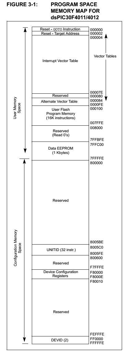

I was studying about the memory of the dpsic30f family microchip. In general also i am finding that there is lot of reserved memory why is it so? Is it a kind of wastage or they are not able to use it? I don't understand this.
Only the memory SPACE is reserved. No physical memory exists for these locations.
I did not understand this you mean to say that they will not actually insert any physical chip in these memory locations. Am i correct?Only the memory SPACE is reserved. No physical memory exists for these locations.
My guess is that these reserved addresses may be for current, or possible future PICs with more memory and more registers.
No physical memory is being wasted.
You are correct.I did not understand this you mean to say that they will not actually insert any physical chip in these memory locations. Am i correct?
Ok thank you very much. Understood.You are correct.
