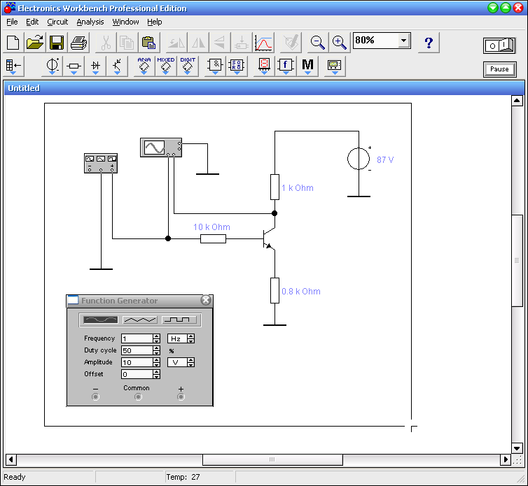

Half managed to print and scan and upload the simple simulation.
The component labels faintly show.
Rb=10K; Rc=1K; Re=0.8K; Rload=10K; Vsupply=87V
With the 'ideal' transistor, it inverts as desired, nice and neat. Real life is very different.
The circuit is wrong but that's the least of your worries, you need to learn how to use the simulation software before you can simulate it properly.

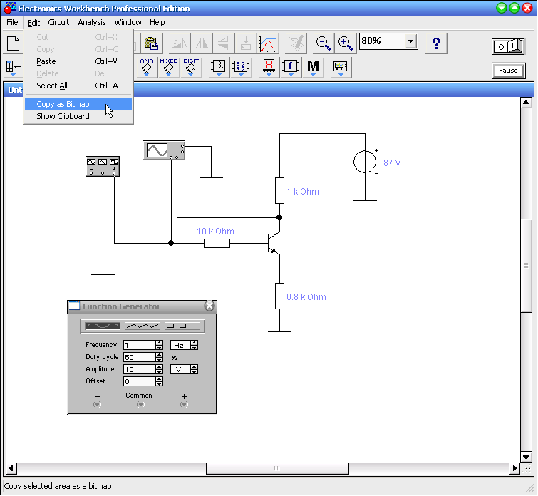

It appears you're using Electronics Workbench which I also have. The only difference is you've got your set to US symbols, mine is set to EU.
To copy the circuit to the clipboard, select copy as bitmap from the edit menu, see attachment below.
The mouse cursor will then turn into a cross, hold down the left button, drag over the area you want to copy and release the left button. If you get it wrong, you'll have to start from the beginning.

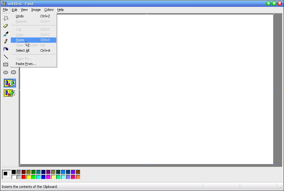

To paste into MS Paint, select paste from the edit menu, see screenshot below. Then save it in PNG format. If you don't know how to start MS Paint or save files using it, ask me and I'll post a tutorial.
I'm assuming you're using XP or Windows 2000 and not Vista.
