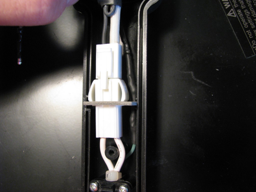

Got parts today for hakko, earth wire was inch too short, but had it fixed also. Works like charm! :)

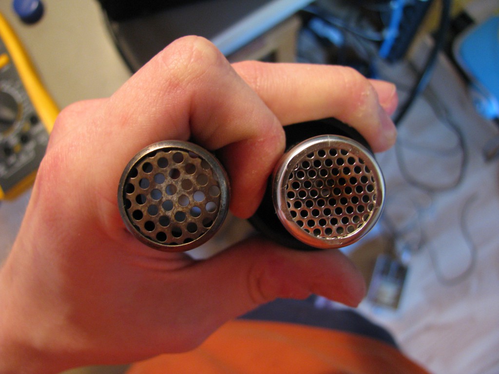

Here's the photos. I know it's not the most wisest thing to add length to earth wire, but at least it is there.
Other thing you might note is that original tube's holes are bigger, but so far it hasn't been issue.
