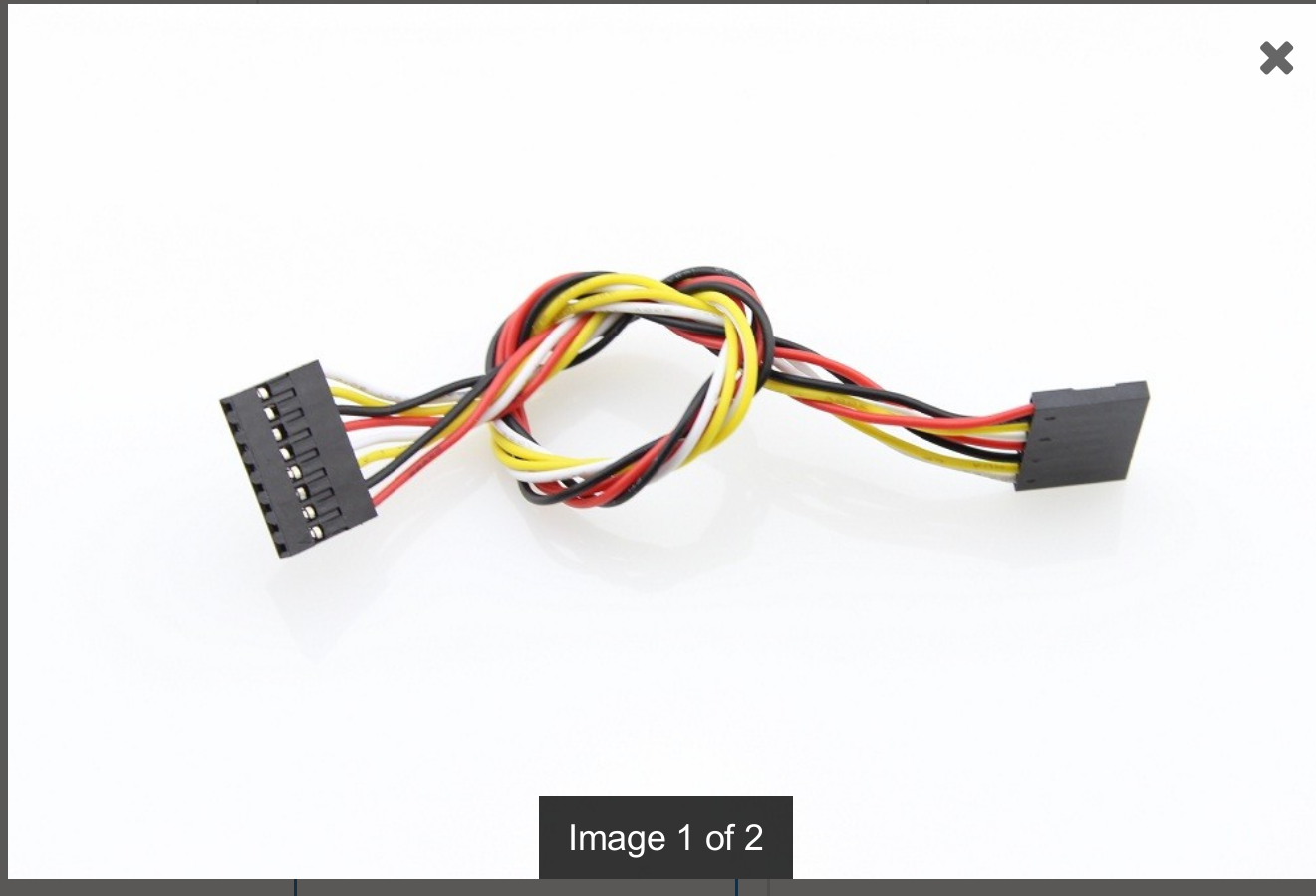

Elecrow has these jumpers in up to 10 pins. You could use 2 eight pin cables to get the 16 pins you need. These jumpers are 200mm in length and 70 cents a piece.
I can make it, I was pondering the idea that it would look better, work better as a ribbon cable. But now I'm not so sure. I found this **broken link removed** at All Electronics. Looking at it further, it looks kind of stiff. So maybe it isn't a good idea. (not to mention it is the wrong gender).
