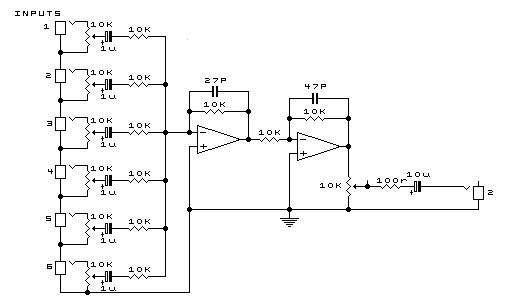

The littlebits website you posted the link to seems about as well designed as the circuit you posted, more a random series of unconnected pictures than anything else?.

Ron, How would it look with a square or saw wave input? Thats what the oscillators that come with it make.
Square wave in.....square wave out.....works "OK"
Saw in....Saw out. "OK"
It is based off the idea that all "audio" starts out at 0 volts and some other positive level. Never a negative level.
example: the output of a 555 is 0 and 5V. If you change the volume it is now 0 and 3V or 0 and 2.39V.
example: A saw wave form from 0 to 3V. and with with a volume control it changes to 0 to 1.5V.
There is this common theme of "o volts". No negative.
Audio from a CD player is positive and negative. A volume control changes the amount of + and - the same amount.
I think it works with these noise makers just fine. As long as audio is defined as a signal that all wise returns to ground and never goes negative.
I don't think it should be advertised to work with normal audio.
My guess is that it does not work the way the inventor think it does. This splitting up the AC and DC then added them back together is not doing anything good, and can be achieved more simply.
With the audio you are getting there are many harmonics. So if the amplifier is clipping, who will know?

Can you point out an audio defect that I should be able to hear?
Unless it's biased externally, which isn't shown on the diagram posted, then it would be extremely distorted, as shown by the sims from Ron. But even if it's biased from the inputs, the bias (and distortion) will vary with the input, and with the settings of the volume controls.
Also the DC through the volume controls will make them crackle horribly when moved.
How hard would it be to improve it? and what advantages would the improvements provide?
Make it a proper mixer - there's no reason not to use actual virtual earth mixers, this doesn't (it uses opamps in non-inverting mode, NOT mixers).
OK I get what you guys are getting at, I suspect that all the models are biased above 0 volts and that the input model that takes audio from MP3 players and the like does level shifting and/or converting to bring its output above 0 volts.
They have not posted the schematics for the input "Mic" model yet.

Would it all make more sense if everything was above 0 volts?
So Vref on the audio opamp sets the center voltage to 2.5 volts, so its all above 0 volts.
Simple mixer: Supply is +6V and -6V
Note input and output is AC coupled to strip off any DC.
It could work with +6 volt supply, and with "gnd" connected to 1/2 supply. (vref)
Ron; Sorry but all the modules in the kit pass DC as well as AC so they all work with the other modules this company makes.
This module works with other things you can and needs to mix DC to.
And yes the speaker will obviously not work with DC but a light or motor output module will.

As I said, it's going to all depend on exactly what's coming in, and where the controls are set - but it's no way to try and design something, it's completely bizarre and shows little understanding of electronics and opamps.
Notice Ron's post #29, that's how a simple mixer should look - and 'could' be made DC just as easily, but as it destroys the operating conditions for AC then it's not something which is ever done.
Would you buy a TV that only works on specific exact inputs and only if you very carefully adjust the controls to allow it to do so?.
