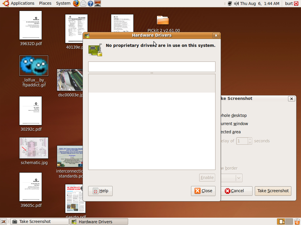

Mike did you try this go to system and then administration then click
hardware drivers and let it install it for you here a pic

But, it broke my connection so I changed it back.
Most new wireless cards use lib that lets it use proprietory drivers
