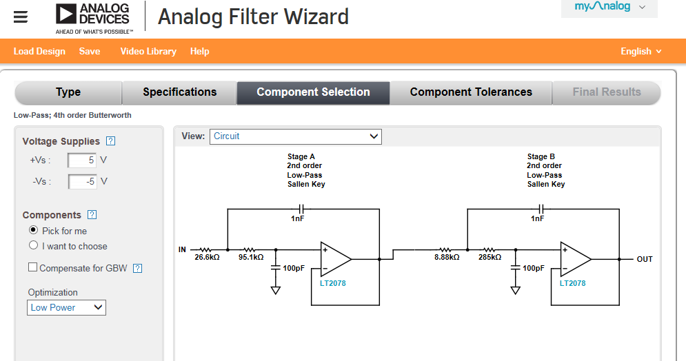

I know that Analog Devices acquired Linear Technologies.
AD's Filter wizard software looks in some instances similar to the older FilterCAD.
Perhaps that is the reason FilterCAD has been deprecated?
As a matter of fact, some of the solutions suggest the use of LT opamps:

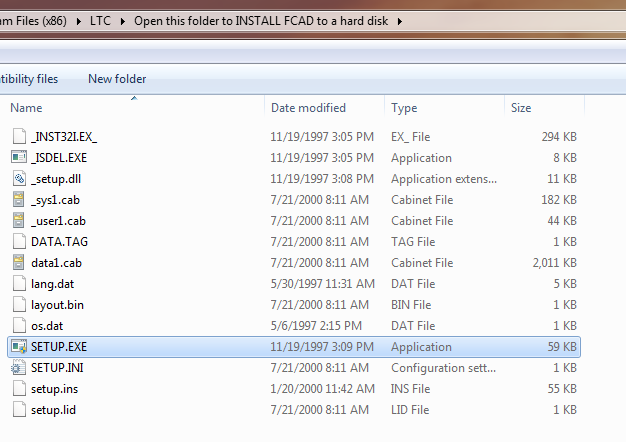

What error message appears? It may just be a permissions problem.
Thanks for the prompt response.
You are correct, it could be a permissions problem.
What happens, as shown in the screenshot below, when I click on the SETUP.EXE file, it will ask for my permissions to install, to which I click YES, yet it will not install anything.
This sounds like a case of Windows trying to protect you from yourself. New versions of Windows restrict which directories you may write into. There is also the probability that it's trying to write into the /programs/ directory, which doesn't exist any more.
Open SETUP.INI to see if it includes a path to where the files will be installed. Take a look in this file as a starting point.
Right problem. Wrong solution.
When it asks for the install directory, specify c:/filtercad or some easy to locate directory.
Open the directory you specified after the extract is complete. You'll see a file that says "Click Here to Complete Installation"
Click it, and you'll see a list of files.

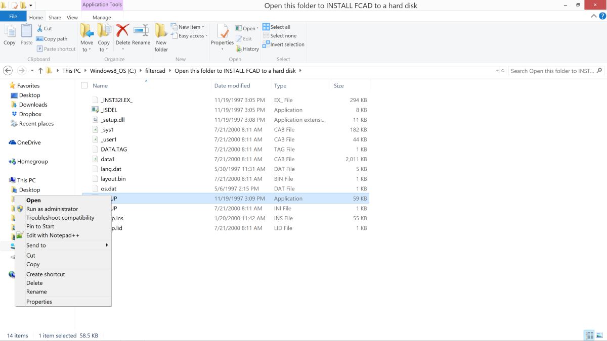

Right click SETUP.EXE and the menu box will pop up. Click "Run as administrator"
