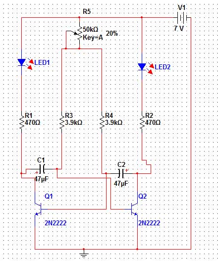

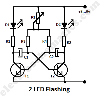

Hi all,
I've been following a schematic where two LED's blink. I was picking the parts carefully, making sure of right power and it doesn't work. In fact, it's working two-three times both LED's blink but that's it. An error appears saying that Multisim will try to fix that error but cannot. See the schematic below. There is one that I followed while the other one is the schematic from Multisim.
What might be the problem? It's a very simple scheme, but maybe there's an error in Multisim? Thanks.

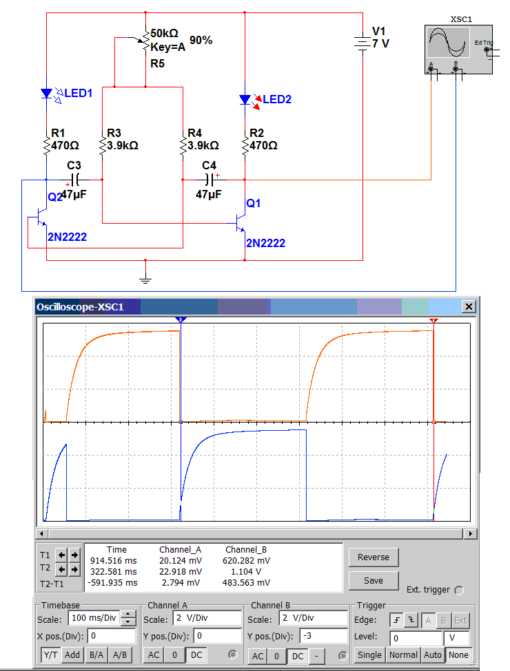

Downloaded your file, but unfortunately my free copy of Multisim from Analog Devices says it cannot open a file created on a different version of Multisim. Bummer.
Can you post a schematic of the exact circuit you are simulating (screen dump of the Multisim schematic)?
I simulated you circuit in Multisim with no error and it oscillated with a period of about 592ms (see below). But I found it would not work properly unless R5 was at 90% or greater. A lower setting on R5 apparently upsets the proper feedback from the capacitors. If you want to adjust the frequency with a pot, you can use a dual pot with separate connections in series with R3 and R4. R3 and R4 should have no connections between them.
Does it work so that the LED's flash in periods? I changed potentiometer percentage to 90% but still as I said, only one flash then it's still.
As you can see from the oscilloscope in my simulation, the LEDs alternately light with the simulation continuing.
Don't understand why yours stops. What time frame are you using (how long do you let the simulation run)? The simulation does run very slowly.
Well even if it does, I leave the simulation for more than 10 seconds and the first flashing is done in less then a second, so I don't suppose that that should be the problem.
Well, your and my circuit appear to be identical, so I'm at a loss as to why yours doesn't simulate the same as mine, unless it's just due to different versions of Multisim. Mine is a free copy of Multisim 11 from Analog Devices.
