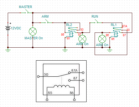

    Hello I drag race jet powered dragsters .
    I have basic knowledge of DC electronics, mainly automotive related and want to build a more complex circuit. I appreciate anyone who is wiling to help.
    Ok I have a 12v electric solenoid = "A" circuit (open/close) I am using a bosch style 5pin relay (SPST) ((actually just am using DPST with one less lead connected))
    I have another separate electric solenoid "B" circuit (right or left) I am using a bosch style 5 pin relay (DPST)
    Operation 1 requires I be able to operate A circuit multiple times while B circuit is in left position
    Operation 2 requires that the very next time I operate the A circuit the B circuit be switched to right simulaintiously.
    I am thinking an ARM toggle switch on the dashboard that once switched then the function of A circuit now becomes A and B
    monkey wrench
    after I ARM then I need to be able to trigger B and if need to trigger A again it then has no effect on B , B need to then stay in the right position
    HELP?!!?

    What would be the impact of a failure? That may dictate a specific design using a failsafe approach

    if this design fails it wouldn't run so it would fail safe

    Sorry but I can't quite follow all the requirements. :confused:
    Could you make a sort of table that shows all the options (switch positions) and what you want to happen in each case.

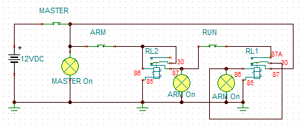

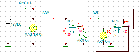

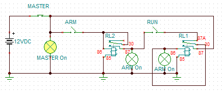

    This will require 3 switches: MASTER, ARM and RUN:
    System OFF:
    MASTER ON:
    ARM ON:
    RUN ON:
    ARM OFF:
