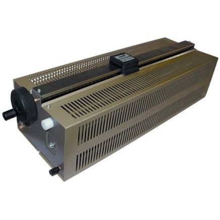

At work we used giant wire would variable resistors for dummy loads. They looked like they were made in the 1930s. If I remember correctly a 2KW version would be about 3 feet long and 9 inches in diameter. They had a large cast metal wheel at the end coupled to a threaded bar that ran the full length of the wire wound resistor and moved the wiper when you turned the wheel. The heat was conducted via the core and also by convection. They had some abuse, even had parts of the wire glowing, but they were dead reliable and never failed. I think similar rheostats were used in plating shops and cinemas.
Just speculating, but for your application I would investigate a bank of rotary rheostats in a case with the control knobs in a row so that the load could be continuously varied from min to max.
