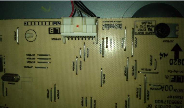

My problem is intermittent on Sharp mod: LC-52D65U. The TV will work OK for a period of time (different), than the screen go black, with sound. When you turn the TV OFF and ON, it comes back OK again, than after some time the screen goes black and so on and so on...
The unit is not so “young” and I can't get any information (service manual, trouble shooting, etc.). This is what I observed:
On the inverter board DAC-60T012 Master (see picture), the nine (9) pin connector has the following voltage, when I HAVE and do NOT HAVE picture:
Picture: Pin Voltage No Picture: Pin Voltage
2 3.3V 2 3.3V
5 3.0V 5 0.0V
8 2.84V 8 2.84V
Pin 5 has an “ERR” designation.
The second connector (three pin, not in the picture) coming from the power supply board has the following stable voltages in both “Picture” and “No Picture” states: pin 1: 60.7V; pin 2: Ground; Pin 3: 11.94V, all stable.

I would suspect it might well be a faulty CCFL tube (or more than one) - it's normal for the set to shut the inverter down completely if it detects a faulty tube.
With some Sharp models you could get replacement tubes, and it wasn't 'too hard' a job changing them - but the difficulty is finding which tube (or tubes) it might be - and you should always change them in pairs anyway.
Replacing all the tubes isn't cost effective, and as all the tubes are the same age I suspect that's really what you have to do - or they just come back a few weeks later with the same symptoms (with a different failed tube).
In my experience the most common failure of these sorts of TVs is the inverter transformer itself. I had a TV with a nearly identical problem and it was fixed by replacing the $6 transformer. They fail much more easily than the tubes do.

Only on the cheap junk makes, and while Sharp isn't a 'great' make they haven't commonly had transformer failures in the UK.

Either way I would try replacing the transformer before I try replacing the tubes. Much cheaper and much less effort.

It's a 'middling' make, but they have a habit of fitting sub-standard transformers and electrolytics - so on the 'transformers failing' front, they are a junk make.

Assuming you can even get a transformer?, and bearing in mind there will be multiple ones on a screen of that size (only 'portables' have a single transformer).
