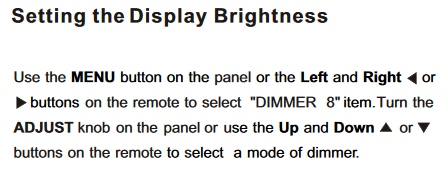

Did you try this (from the Insignia Model #IS-HC040917 manual):

I did: The problem is that the display will not illuminate enough to even allow me to see when I've gotten to "Dimmer 8" mode of the setup menu. I've tried switching modes one at a time and then turning the "Adjust" knob for each one, but can't tell which one I'm adjusting and can't tell when I'm in "Dimmer 8" adjusting mode. Does that make sense?
... but can't tell which one I'm adjusting and can't tell when I'm in "Dimmer 8" adjusting mode. Does that make sense?
Yes, it does. And you took the steps I would have as well. Thus, sadly, I don't have a solution.
