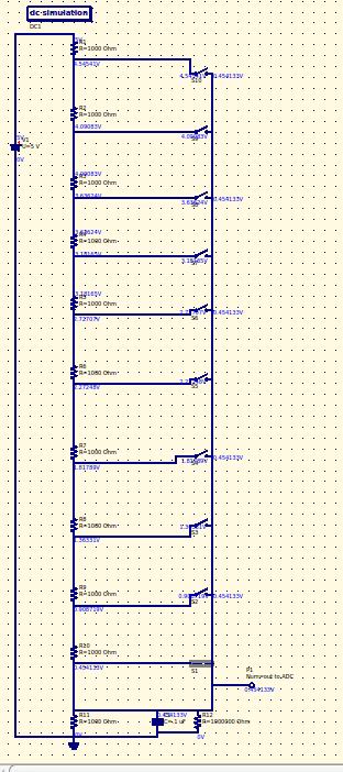

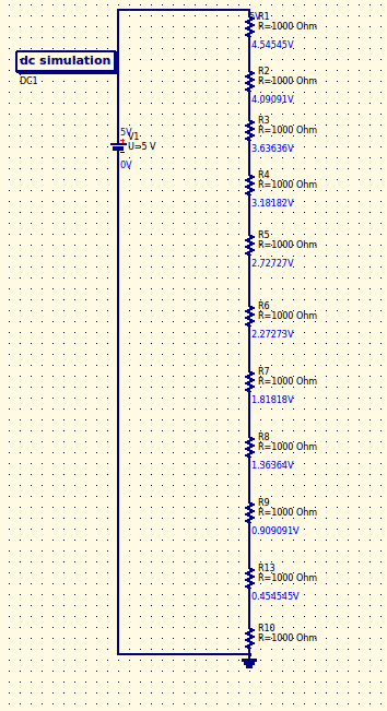

I simulated all on one output but the voltage output varied by as little as .2 volts. Wanting to avoid marginal errors for indicating which switch was depressed so I found using the posted schematic worked well.
voltage output goes from 4.17, 4.00, 3.75, 3.33, 2.5.
When I posted Burts Schematic was not included. Will take another look at your circuit Burt.

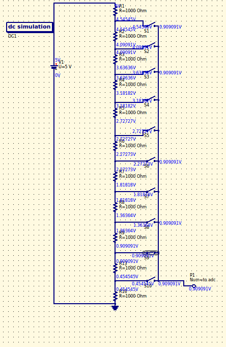

I think this is what Burt was suggesting? I just may go with one ADC input. Am wondering WHY the simulation shows 2.54volts with no switches closed?

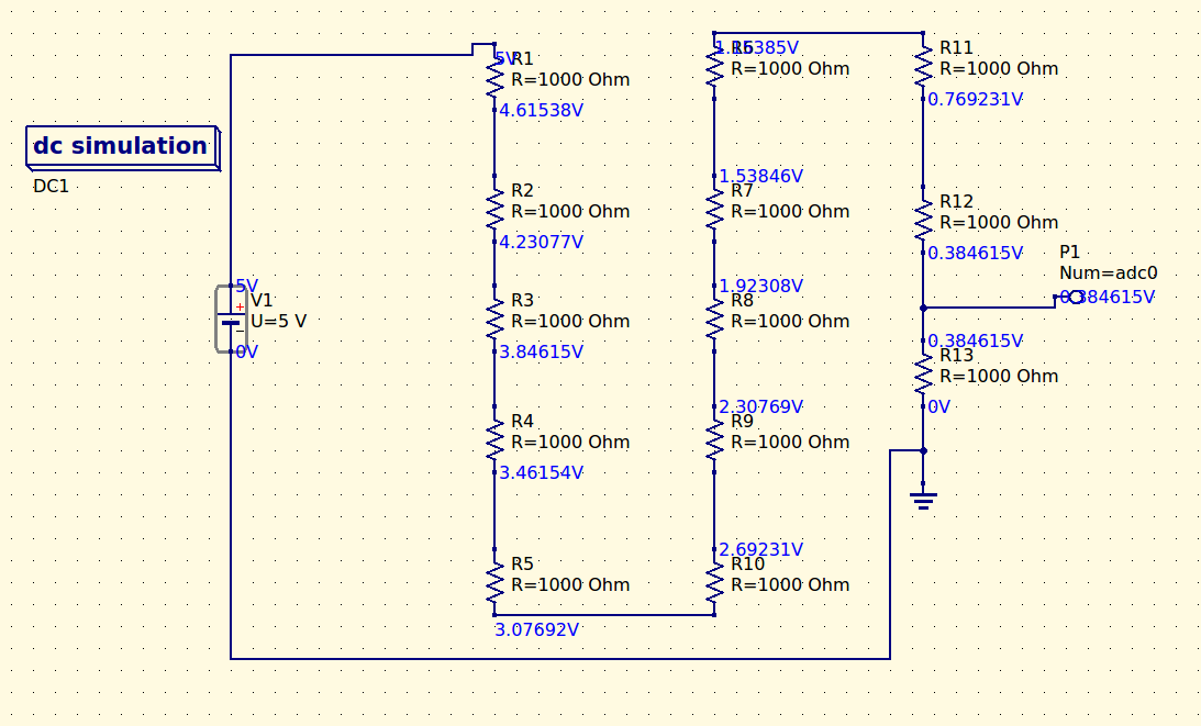

Your input is floating, unless you have a weak pull down or pull up attached to it..

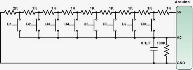

This is a bit easier to understand. Add as many 1k resistors and switches as needed. Add the 100k resistor and 0.1uF cap to ground to avoid noise pickup.
Calculate the expected range for each step using the voltage divider equation, using minimum and maximum values based on 1% resistor tolerances. Make your life easy by using 1024 as the input voltage; that way the steps are the ADC values you will read.

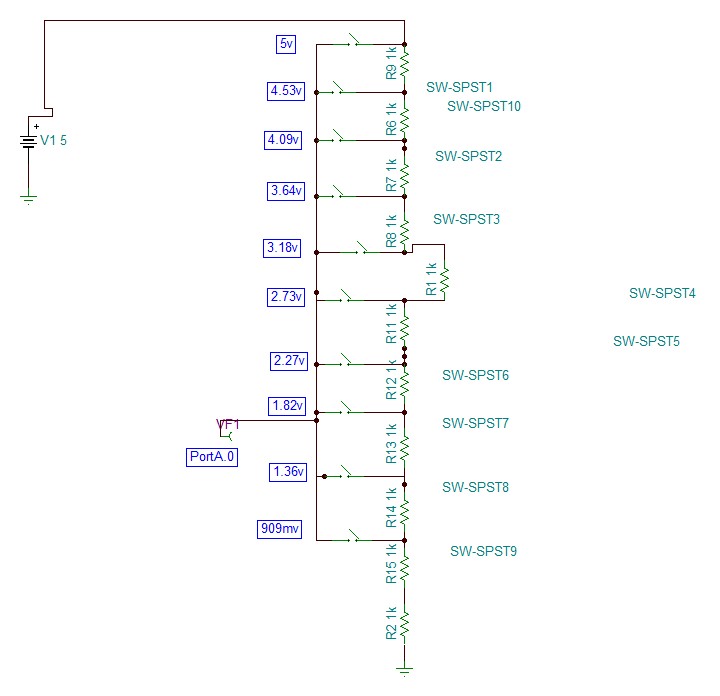

What i posted is there is 400 mV between each point on the ladder easy to read

As for the floating input?? not sure if I need to worry about it since it is an ADC input
Why worry about a floating input? You are depending an an ADC reading to tell you what switch is read. When you tested it above, it was reading mid scale with no switch pressed because it's floating. That will wander around depending on electrical noise, humidity and the phase of the moon, so how will you know what's noise and what's a button press?

Burt, you missed off the 100k tie down resistor to the input pin.
