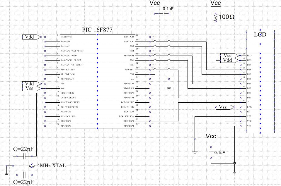

I did test the LCD with the programme that you provided, it not work; means that the possibility for LCD faulty and LCD wiring is faulty. So, I have to use your programme to test in the new LCD. If work in new LCD, I'll know the result, am I right?
Erm... could you help me to double check again my connection of LCD? I've attached it above.
Thanks!!

You can't just connect VEE to gnd, it generally need to be adjustable and some LCDs require a small negative voltage.
Put a 10K pot bettween pins 1 & 2 with the wiper going to pin 3.

Ok, thanks!

futz said:
I'll draw up a quicky schematic of how I wired it and post tonight.
Bah! Too much work. Here's the LCD connections.
LCD Pins:
Pin 1. Ground (VSS)
Pin 2. 5V (VDD)
Pin 3. 1K resistor to ground (VSS).
Pin 4. RD2 and also a 10K pullup resistor
Pin 5. Ground (VSS)
Pin 6. RD3
Pin 7. RB0
Pin 8. RB1
Pin 9. RB2
Pin 10. RB3
Pin 11. RB4
Pin 12. RB5
Pin 13. RB6
Pin 14. RB7
Pin 15. 5V (VDD) (Backlight)
Pin 16. Ground (VSS) (Backlight)
I determined the resistor value for Pin 3 by first putting a 10K potentiometer in using one leg and the wiper from pin 3 to ground, adjusting it till the display looked good, removing it and measuring the resistance and putting that value of resistor back in place of the pot. LCDs vary from model to model. If you just put in the resistor there's a good chance you'll end up with maladjusted contrast and have a "blank display".
Silly questions:
You ARE using a 4MHz crystal as the schematic shows, right? If you aren't, that would explain the the blinking LED program working but the LCD not working. The LCD delay durations depend on the PIC running at that 4MHz clock speed (or lower, but not higher). If you put (for instance) a 20MHz crystal on the PIC the LCD is not gonna work until you change either the code or the crystal.
Is your MCLR pulled up properly? If not the chip could possibly be doing something weird like restarting over and over, giving the illusion that the blinky program is actually running when it's really not. Try making some changes to the blinky prog and see if it responds correctly.
Got enough juice? Not enough power can cause LCDs to not work properly. I found this one out the hard way a couple times. Backlight seemed to be working, but couldn't get the display to work right. Got better power to it and it took right off. It had been working all along but I couldn't see it.

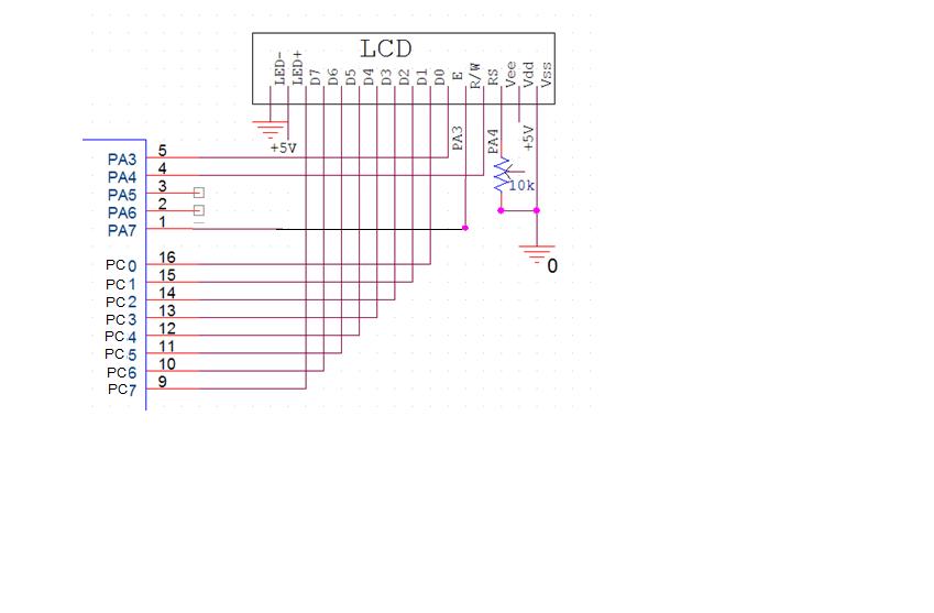

My LCD JHD162A cannot display any characters
I have checked many times of my circuit connection of LCD with my Microcontroller MC68HC11E, even the programming code I have edited many times, but the LCD still can't display any characters. I have to summit my project by next week. Anyone can help me please!!! Pin E I connected to PA3, Pin RS connected to PA4, Pin R/W connected to PA7 and DB0-DB7 connected to PC0-PC7. The following is my programming code:
