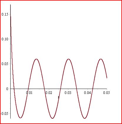

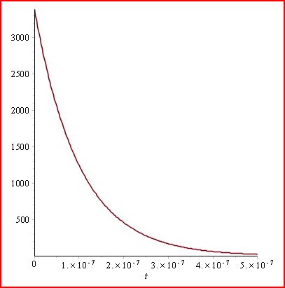

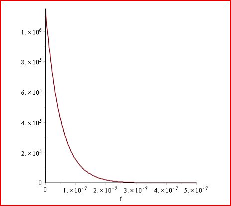

I don't think you have to have a resistor or worry too much about the inrush of current. Here is why. Let's assume that the voltage is 120 volts at 60 Hz, the capacitor is 1 uF and the total resistance of the everything is 0.1 ohms. Furthermore, let us assume that the cap is energized backwards so that it aids the voltage which turns on at the worse possible time in its sinusoidal cycle. What do we have?
We have a voltage of sqrt(2)*120 volts peak. Double that for the voltage from the cap gives 2*sqrt(2)*120 volts peak. Dividing by the resistance gives (2*sqrt(2)*120)/0.1 = 3394 amps peak into the diode. Ouch!
But look at the time constant, RC = 0.1 usec. How much energy will be dissipated in the diode for, say 5 time constants, after which the inrush will be finished? Since the period of the sine wave is about 17 msec, and 5 time constants of the inrush current is 0.5 usec, we can assume the sinusoid will not change much during that time. Anyway, it turns out that the diode accepts 11 nanojoules of energy during that short period of time. Any worries?
Ratch

Would you mind helping me understand how to get that math?
What all variables did you look at? I understand cap charge to max and and mains starting on peak, 2 * sqrt(2) * 120, but where did 100 mili-ohm come from?
I used 0.1 ohm as a guesstimate. 1uf was the value of C.
First we find the current in terms of Laplace expressions.
Then we find the inverse Laplace.
We can plot i for 5 time constants.
We can also plot the power for 5 time constants
Integrating the power with respect to time over 5 time constants we get about 60 millijoules.
Changing the value of R does not change the energy of 60 millijoules much because a higher resistance lowers the current and increases the time constant.

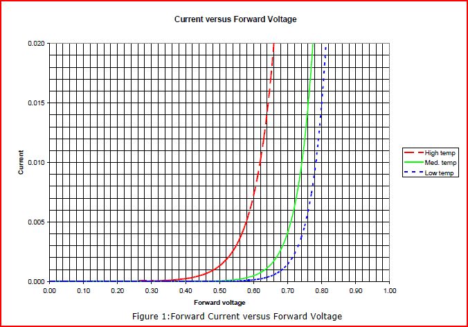

If you look at Vf curves the Vf may go up .1 volts for each 10 ma of increase in current so the high Vf are not unexpected. Just very painful (for the LED)

Why is the Vf even considered?
Because the high Vf limits the peak current.
The transient is finished in less than a microsecond, and 60 mjoules in not much to worry about. 60 mjoules is the energy, not the power. Looking at the power curve, its peak is over a million watts for an infinitesimal amount of time.
No it's not because the Vf goes way up. Depending on the LED it can be 35 40 usec. But it is still 60 mj. This seems to break down the LEDs around the bond wires. Cree has some write ups.
Now that really puzzles me. The Vf of a diode is never high. Only a few volts at best. 340 volts is not even going to know it's there. See the Vf curve below.
Vf is measured in volts, not time or joules.
