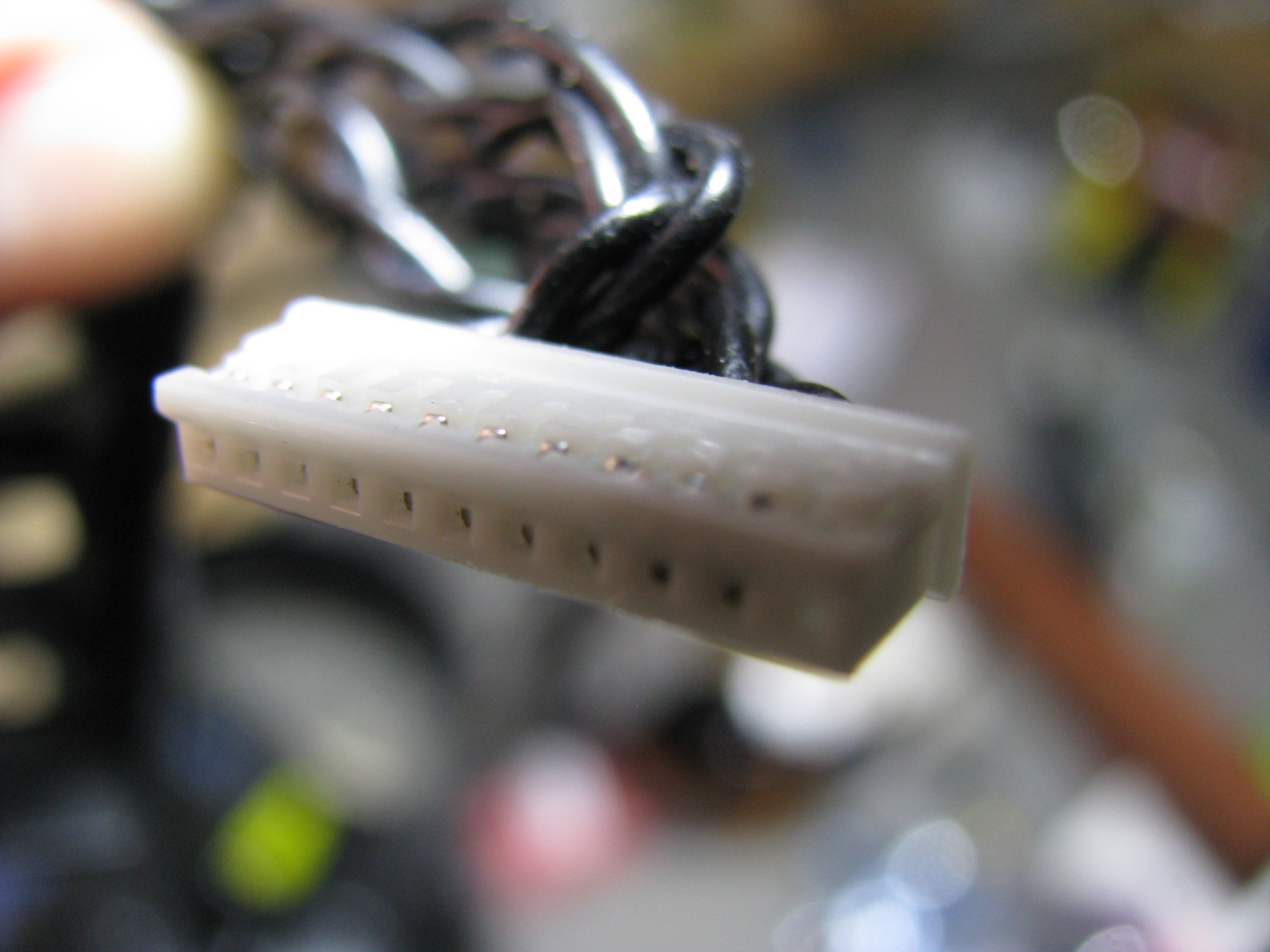

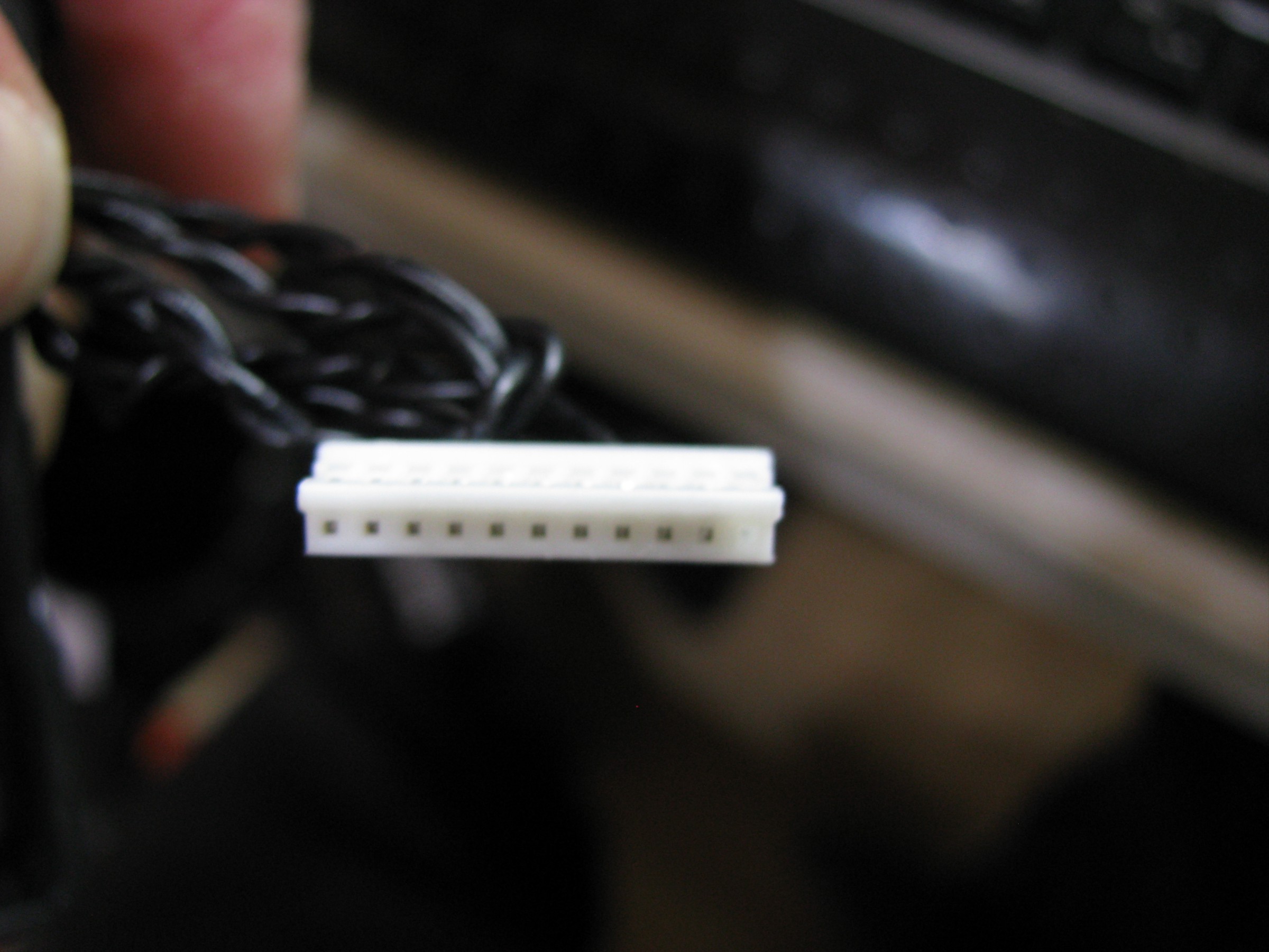

Yeah, again i stumbled on unkown connector. It's from old nokia cellphone MCU420-01
Google didn't help for finding suitable cable, but if again you could find housing/pins, rest is much easier for me, to assemble cable that is.
But, even after that, there's still work of reverse-engineering to find/figure out pin assigments!
so, for now:
what connector, housing & pins. (i suspect it has separate pins from housing)
ask for better pictures if you need

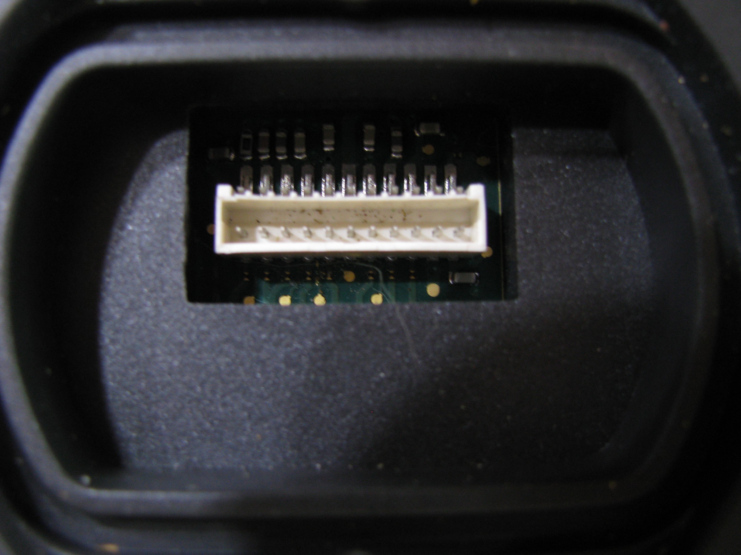

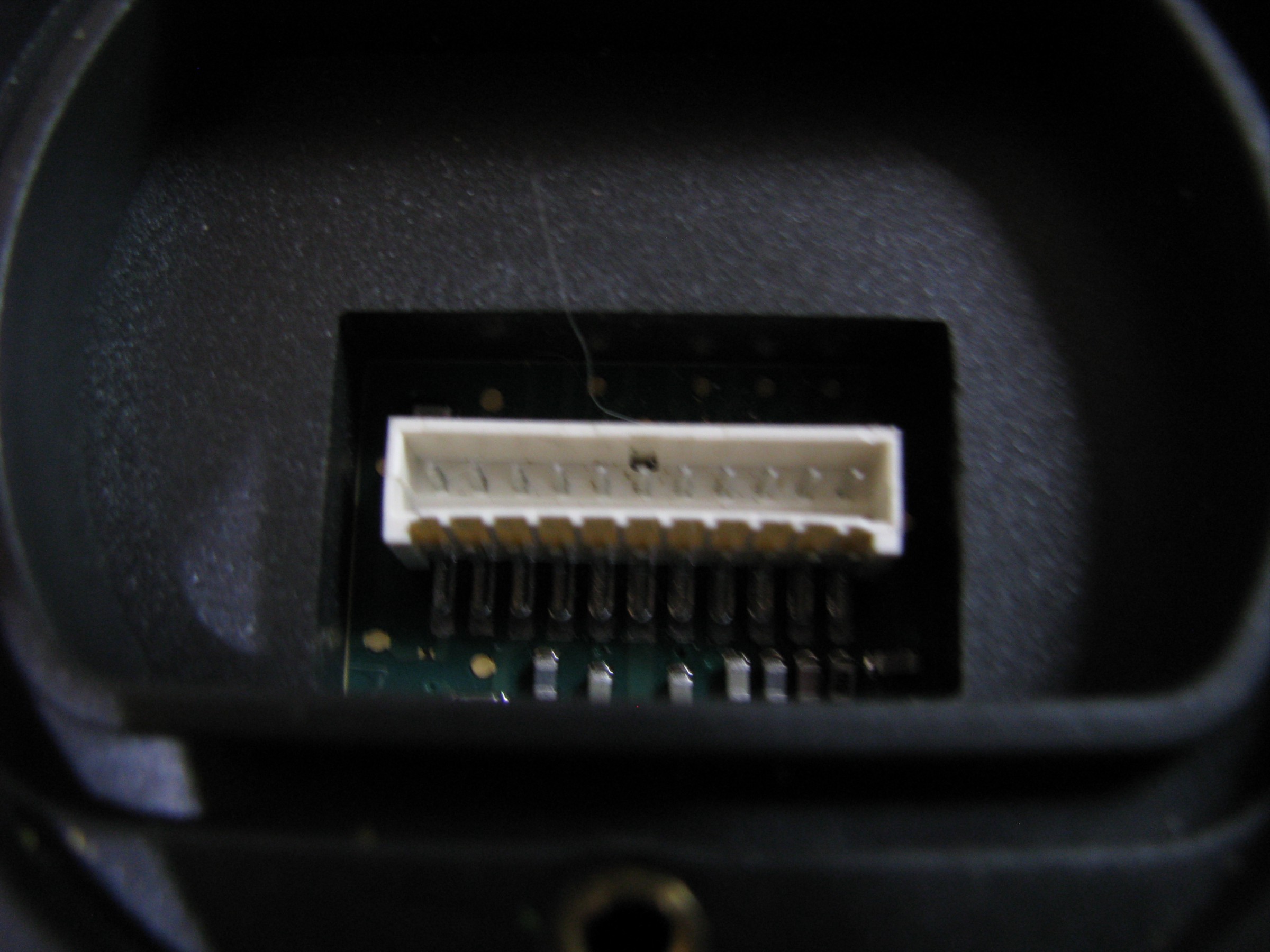

I opened it more, there was actually connector/pins i'm looking for, if it helps any way:
they look lot like picoblade and its variations....

I thought pico-blades were more blade like rather than square, for example Molex 53261 :
If you can get or estimate the spacing, that would be a great help. I ususally measure the distance between several pins/receptcales and divide by the number of spaces.

oh, seems i was wrong about pico, truth is, there are so many connectors that look like one another....
but, seems i totally forgot to mesure pitch hehe...could'nt find my vernier, but from ruler 1.5mmm, but probadly 1.54 as it's standard no?
and housings lenght is 17.5mm total

I spent the weekend looking at Molex and TE connectors in the 1.5 mm pitch range. There are, of course the 0.05" (1.27 mm) ones and others to worry about.
If it is 1.5 mm, take a look at the Molex Pico-SPOX, e.g., 87438-1043 :https://www.digikey.com/product-detail/en/0874381043/WM7654CT-ND/699168 That device does have square pins. Another 1.5 mm offering by Molex is Pico-Lock, but I don't think the shroud in your device matches that device's shroud.
Very similar to the Pico-SPOX is the TE 292227. If you can see the crimped female pins, that should help tell the difference. Also, the TE unit comes in both a crimped pin and IDC design for the female coupler, but the Molex, so far as I could tell, comes only with crimped pins. So, if its IDC, then it may well be the TE device.

Yeah, they look indeed the same. i'll try to open housing to see pins.
Pins are on phone, these are sockets or female crimps for single wire and square post into a round hole. :rolleyes:
well i managed to open it, and from i measured, pins are match.

Two corrections:
1) I said female pins. What I meant was the female crimp or IDC terminals/contacts used on the hanging wire, which you show in your second post.
2) I was looking for RT angle connectors, yours is obviously a vertical connector on the board. TE and Molex make both versions of the part numbers I gave. Of course, the actual part numbers for the vertical versions are different.
