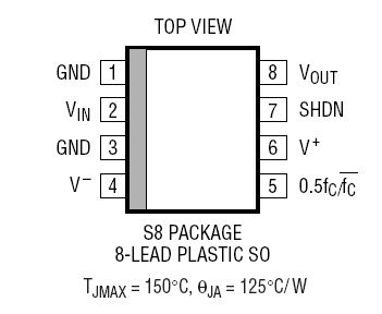

A datasheet would be helpful. I suspect the chip looks like this:

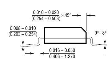

The shaded area is not colored, but rather, it is more beveled. Both sides will have some bevel, but the #1 pin is on the side with more bevel. This example is the LTC15601.
Recheck the datasheet for your device. You will probably see some indication for a bevel. If not, please post a link to its datasheet.
John
As John's image shows the chamfer, photo shopping your image shows the chamfer.
