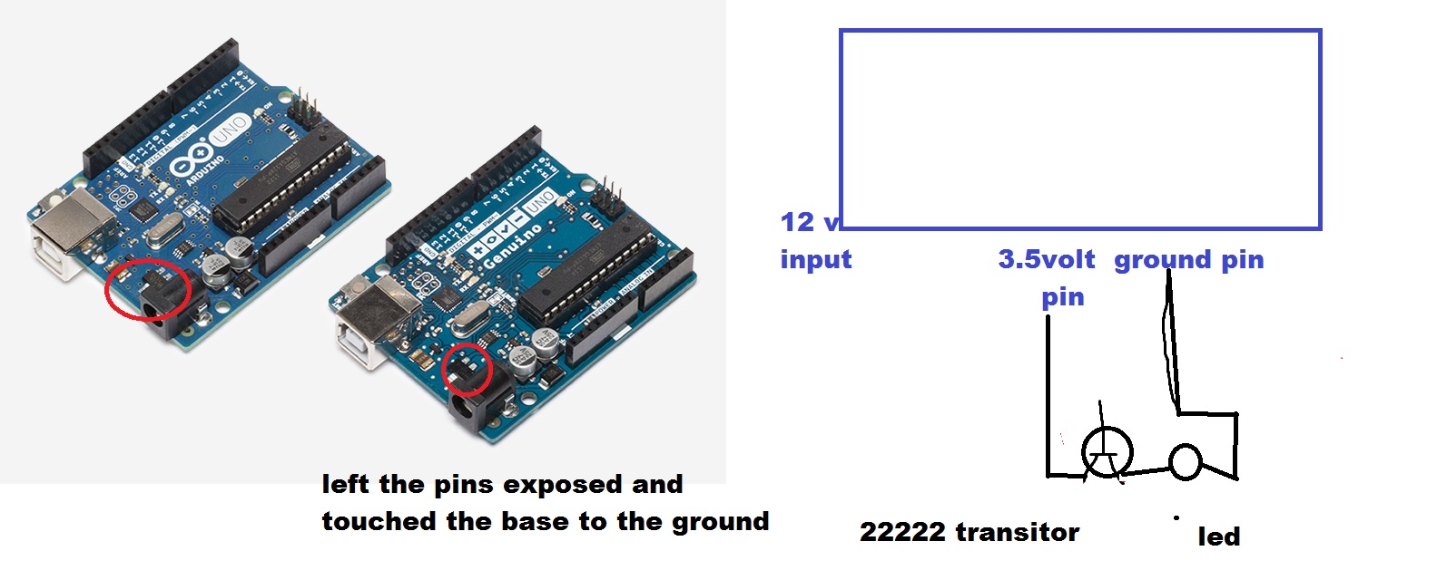

I am a noob in electronics.So I was messing with a transistor and an led on my arduino uno.I messed up .I fried the board and saw smoke coming out of the transistor next to the power plug .It won't work.Does anyone know the part and knows how to fix it? I'm on the literal verge of tears because it was a gift and I can't afford a new one.Thank you.
Thanks for all the responses.View attachment 104128
the transistor in the red circles is bumped and started sending up smoke.
Im in the US
Another edit , I have connected a 5 volt usb and the code I had on it still works.The problem is that I tried to upload new code and my computer does not recognize it .
Hi oro, I just read this thread as well as the responses here. Now for your specific problem: I had exactly the same problem as you have, albeit due to a different cause.
I sent 15V into the power supply socket and blew the regulator you mention. That is an AMS1117 5.0. I bought a set of them on Aliexpress to repair my board, cost me less then 1USD but it took 6 weeks to arrive. If you are good at soldering and have ever done SMD soldering I will send you one of my spare regulators so you can fix that. Make sure you have a 1mm tip soldering iron.
Nothing else on my UNO was blown, so chances are your board will be fine.
To check this you need to plug it into your USB and verify whether the device manager sees anything at all: describe to us what you see happening on that window (which Windows veersion do you run?).
If your pc does not recognise your board it may be that the device manager is not recognising the board because the driver is -for some reason- not installed properly (anymore?): reinstall the Arduino driver and retry.
As spec says: your USB ports are overcurrent protected; somethings wrong, just restart your pc and it will be fine.
Let us know what you find now?

Hi Oro,
Sorry to hear about the mishap with your Arduino.
I am assuming that when you say transistor you are in fact referring to the voltage regulator chip U1 in the schematic below.
Afraid to say that your Arduino may be a write-off, but there is also a good chance that the voltage regulator chip, failed short-circuit to ground and saved the rest of the board.
Arduinos can operate from a non-regulated supply of about 6 to 14V: I would guess that you exceeded 14V and that blew the voltage regulator chip. On the other hand if you connected more than 5V to one of the GPIO pins on the Arduino that is liable to write the processor off but you may be lucky.
Arduinos can also operate from a regulated 5V supply line from a USB power source. You could try this and your Arduino may still work. But the chances are that you will have to remove the damaged regulator chip and then see if the Arduino will run from a 5V USB source.
If you don't have the proper equipment and you are good with your hands you can simply cut out the damaged voltage regulator chip with a small craft knife, but you must be very careful not to damage the printed circuit board that the regulator chip is soldered to.
Alternatively, you can smash the case of the regulator with a small pair of pliers. It does not matter if there are bits of the regulator still attached to the printed circuit board so long as there is a gap between the three or four legs of the voltage regulator chip.
If you are thinking of replacing the regulator chip, it is normally part number: NCP1117ST50-3G but there are many similar regulator chips used, so look for the 1117 50 bit in the part number (the 50 means 5V regulated output). AMS1170-50 is a common part number. 1117 50 voltage regulator chips are available on the net for around $1US with free post and packing; make sure you get the 5V version and not the 3.3V version which is more commonly available. But you will need to get someone with the right equipment to remove the old voltage regulator chip and fit the new voltage regulator chip.
But, as the other members have stated, Arduinos are so cheap, depending also on the specific Arduino that you have, that it is hardly worth repairing a damaged Arduino.:)

I have a 'duino where I overloaded and blew the 5v reg, the one that regulates the dc jack voltage, I just removed it and use the board on usb only, I think i had to link something out to make that work.
No you don't. Either USB supplies the board Vcc, or the jack plug; you can also have both USB and the jack plugged in with a 6 to 12V supply: that way you get a stable 5V supply through the 5V regulator and data can be transmitted through the USB connection.
You only have to adapt your board if you change the 5V regulator to a 3.3V one, then you have to remove the fuse near the USB on the Arduino and replace it with a diode. But this scenario is only necessary when you use 3.3V actuators with the Arduino (because the analog and digital outputs going to 5V might destroy 3.3V actuators). Thus rare.
The current 3.3V regulator is there to provide voltage to for example GSM modules or Wifi modules operating at 3.3V.
Im in the US
I use clones myself. There is little to no difference besides board color (sometimes) and identification. I suggest avoiding the clones with the CH340 chip though.
I'll also note that one can program an Arduino from an Android phone using an OTG adapter cable (https://www.amazon.com/UGREEN-Adapter-Samsung-Android-Function/dp/B00LN3LQKQ) and the free ArduinoDroid app in the PlayStore (https://play.google.com/store/apps/details?id=name.antonsmirnov.android.arduinodroid2&hl=en)
