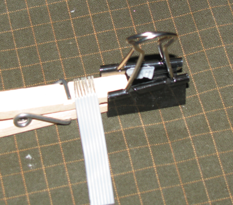

In the past I've used crimp tool to clamp connectors to ribbon cables. But I got an interesting project where space is very limited so connector is out. I would need to solder ribbon cable directly to the PCB but my wire stripping tool is meant to do one at a time, I am wondering if there is a tool that can strip off ribbon cable, 20 lines at once so I could have neat and clean solder connection without gap in wire cable.

If you want simple ribbon cable, just get a razor knife and lightly score to and bottom (full width), then grab firmly and pull off the insulation. It strips well if you are doing 4 to 6 mm, removing more at a time gets messy.
By the way, keep the tip of the razor knife off of the copper, let out a long enough section of blade to distribute the pressure across the full width if the ribbon. Gentle sawing action without grinding the pointy tip on any copper.

Presumably the insulation on your cable is PVC. Have you considered using heat?
I simply used a heat gun to blow air up the channel of the spring clip. Flipped the handles to push with and to keep them from getting too hot. There is no residue on the wire. I have the clip pried open so you can see the removed insulation.

Can you do a video of that? I'm not sure I understand what you did. Or, most clarification needed is, did you just heat and snap off the PVC end, or did you score it first?
gophert
Are you kidding? I can't do a video. I am not Michael Moore. You are lucky I didn't post a Kodak Ektachrome 2X2 (https://en.wikipedia.org/wiki/Ektachrome ). I clamped the wire in the clip, blew hot air up the center and pulled/pushed the clip off. Try it. PVC is low melting -- like it is only rated to 85°C to 110°C or something like that. The clip is blued spring steel. Nothing sticks to it. First time in my life, as I never faced that challenge before.

If you seriously need the steps, I will try to write something up. Let me know. Actually, I was a little surprised it was so easy. I expected a little smear from the PVC, but it came off very cleanly.

This is interesting. I usually take an exacto knife and will run along the line I want to score spearing the tip between each wire pair. I'm going to give the clip / heat gun thing a try.
