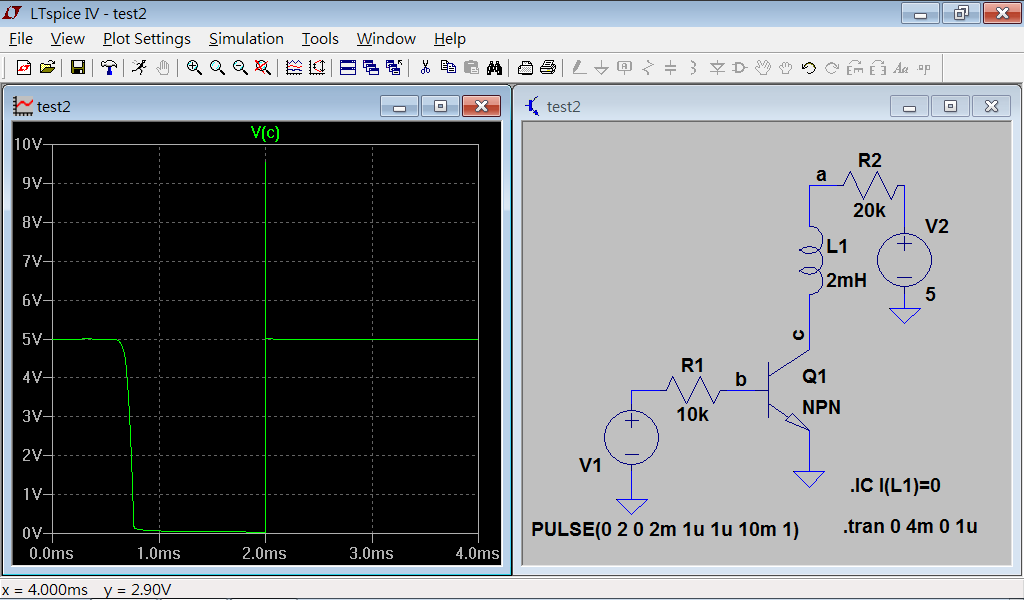

Before you give the answer to the question in the title, could you please tell me whether the BJT in the circuit below will be destroyed by the inductor's large negative voltage when the switch is opened? I mean when a large voltage is applied between the collector and the emitter while the base is floating, will a BJT be destroyed?
Here's what I know: at time of 2ms, when the switch is opened, the inductor is trying to maintain its current by giving a large negative voltage which is applying between node c and ground. There are capatances between B-C and B-E junctions of the BJT, when leaving the base not connecting to anything, only a large voltage between C and E would cause damage to the BJT? If so, how does it work?

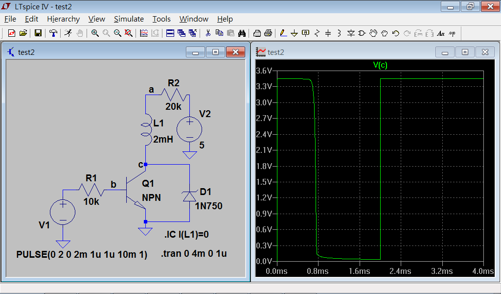

When I add a zener diode in parallel with the BJT, the 1N750 has a berakdown voltage 0f 4.7V at a testing current of 20.245mA,
will it work?
Thank you.
Yes, many a transistor has been destroyed by inductive spikes.
You can use a zener from the collector to ground but it should have a breakdown voltage greater than the supply voltage or it will conduct all the time (if you check D1's current in your simulation you will see this).
For your simulation it should have a breakdown greater than 5V.
Alternately you can put a standard diode across the inductor (cathode to supply side). This will provide a path for the inductor current when the transistor turns off and prevent any spike.

Thank you very much crutschow. I understand it now.
The inductor does NOT cause a negative voltage at the collector of the transistor when it is turned off. The voltage spike is positive and is only +9.6V that will not harm the transistor. Usually an inductor causes hundreds of volts.
The base of the transistor should never be not connected to anything. Its drive is +2V or 0V through the 10k resistor.

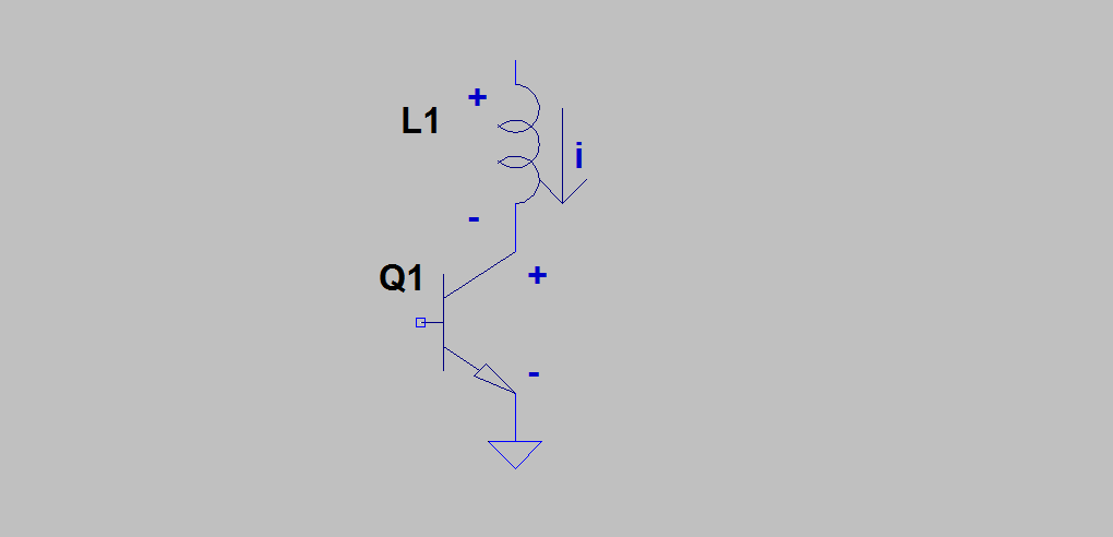

At the collector of the transistor, it experiences a positive voltage when the current is cut off. For the reference directions shown below, the inductor's voltage is turned to negative when the BJT is turned off, because di/dt < 0.
I agree that the collector has a positive voltage spike but I do not agree that the inductor's voltage is turned to negative.
It depends upon how you look at the inductor polarity.
When you are applying voltage to an inductor, the terminal where the current enters is positive with respect to the terminal where the current exits.
When you remove the voltage source then the inductance cause the exit terminal to become positive with respect to the entrance terminal, a reversal of polarity across the inductor.
But, of course, the voltage across the transistor stays positive for both scenarios.
It depends upon how you look at the inductor polarity......
I understand what you mean. The collector terminal of the inductor goes negative when the transistor conducts and the flyback voltage makes it go positive (well above the power supply voltage) when the transistor is turned off.

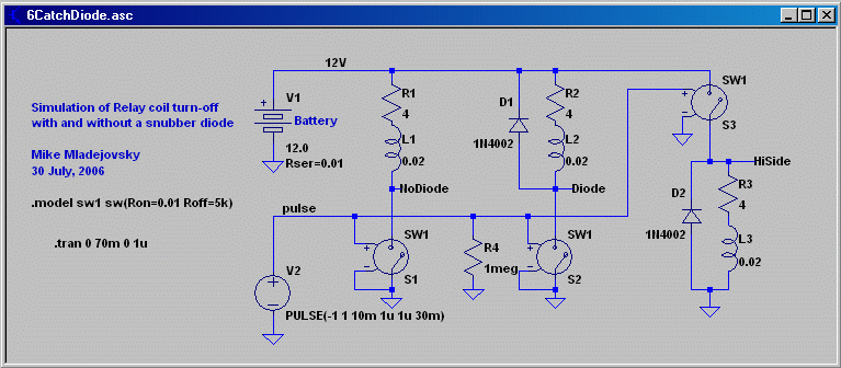

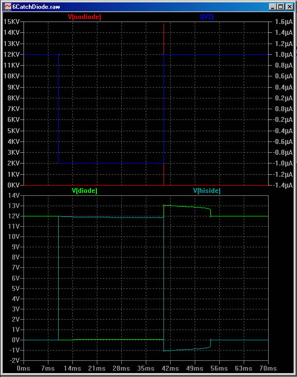

Here is something I did to illustrate this principle way back in 2006....
