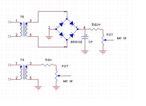

Hi mdorian
I also add a 2nd transformer thing.But still I'm not satisfy its voltage behavior.
I have attached two diagrams.1st one isolated & 2nd is non isolated.
What are the modifications to do to get a smooth DC AD input?
Its ok if it is non isolated I need a good reference detect circuit.
Also note I'm sampling DC not AC.I need a DC input for AD input.(Because I'm not continuously sampling AD & finding the peak,I just sampling AD & checking if its greater or less than the reference so I need a DC input for AD)

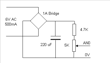

The second schematic isn't good , you will have to many errors because the bridge works at low voltage , use something like that instead:
To approximate the error given by the smoothener use this formula
ΔV ~= V*0,006/(R*C)
Where R is Rdiv+Pot,
V can be ADC-in, or the AC voltage
For example :
ΔV = 2volts (AC )
V = 220volts ( AC- same as ΔV)
R = Rdiv+Pot = 14,2K
Then C = V*0,006/(R*ΔV) = 46uF
ΔV>2volts ==> C>46uf
Check the VDD for PIC if it's stable enough , otherwise it will alter the internal reference.

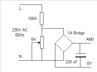

Hi mdorian thanks for your new diagram thats the one I was looking for.
I understood your formula.That means to maintain 2volts AC the smoothener must below 47uF.If smoothener > 47uF then the error will be more than 2volts AC.
Is that formula only for AC?
One more thing!
R is Rdiv+Pot that means 220K + 2.2K = 222.2K isn't it?
No , if C > 47uF then the error ΔV is proportional less then 2V. The formula can applied to DC to. Is not a very accurate formula because i approximated the discharge of the capacitor as being linear which is not , ΔV can 3 or 4 times higher, just put a capacitor large enough for the worst case. The bad side of putting a too large capacitor is that when the AC voltage drops from 240 to 220 the the smoothed voltage does not drops as fast as the AC voltage , this means you will have on the ADC-in a delay proportional with the capacitor.
As I told before, another source of errors is the voltage dropping on the bridge , witch falls with 2mV for each celsius degree. This is significant only for low AC voltage.
And again , don't rely on the 7805 that will give the same voltage at any time , use a digital voltmeter to check with and without loads ( like LED relay , etc). The AD conversion is relative to Vdd , so will give different results for Vdd = 5 volts as for Vdd = 5,1 volts.
The time for ADC conversion is ~ 150us, for an accurate result (without a bridge and a smothener) you need to take a least 20 samples in a semiperiod (10ms) -> a sample in 500us. You just start AD conversion and do something else for 500us or use ad interrupt and do something else in the main program. If not , use a bridge and a smoothener for the second transformer. The load (a resistor , can be the divider) for a response time can be calculated (approx) like that : time = 0,025ζ, where ζ= RC
for time = 0.5s and C = 220uf -> R = ζ/C = 40*0.5/(220*10^-6) ~ 90Kohm
(including the ADC-in divider)

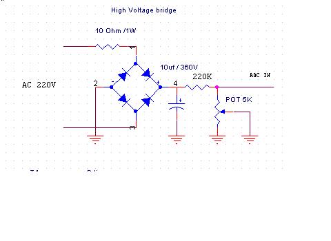

hello mdorian, i have problem in simular situation. can u help me?. i have measure 230v,50hz ac.i rectified ac with bridge,then use potential divider to dive to below 5v,(without using filter capacitor)then given to the 10bit adc pin of pic16f877a.i take sample on each 1ms(since for 50hz, period is 20ms,using timer 1) add then,average on 10 sample, multiply by form factor(1.1) then display.my problem is display value change between 208-230. i don't think it is because of supply variation
There is another way.Detect zero cross (waste another external interrupt pin).When ZX occurs turn on a timer for 5mS.At each mid of semi period you get the peak value.@ 5mS time sample AD & calculate RMS & show on display.
If still display varies then you need to over sample & make the average.
The problem is that the samples are not synchronized with zero crossing, let's say you take a sample of 10V before zero crossing and one of 10v after the zero crossing , gives you an average voltage of 10v which obviously is not true. Worse, the samples position is changing in time relative to zero crossing and so your result . If your project requires this solution ( taking 10 samples/ semiperiod) then wait for zero crossing or use an interrupt to detect the zero crossing, start timer interrupts, take 9 samples ( because the first one is zero) stop timer interrupt and wait for zero crossing again. I wouldn't recommend taking only one sample per semiperiod like Soyza says because it's fitted only for perfect sinusoidal voltage, some loads widely used like SMPS are cutting the peak voltage modifying the result.
thanks for reply. i agree u said correct reason for drift. but i am using full wave rectifier, my freq is 50 hz, means 20ms period. since using fullwave rectification both negative and positive half cycles are same.so have to take only one. so take 1 sample for every 1ms .so 10*1ms=10ms(half period).then take average for ten. i beleive that i am taking consecutive 10 sample with 1ms interval. i don't have to worry about the zero crossing. sorrry for any mistakes

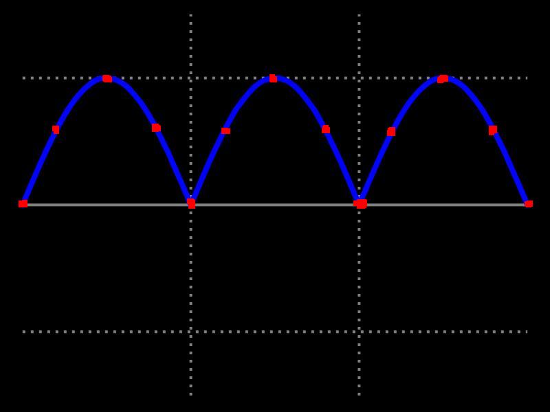

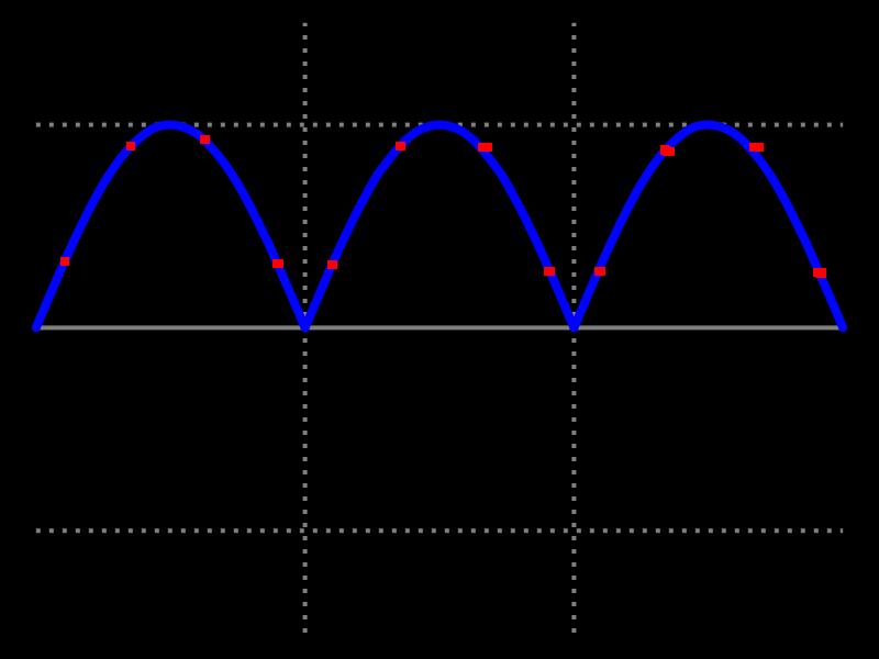

Hi , look at this pictures , the red points are the sampling points , I took only four samples per semiperiod but it applies to ten samples to. Using the samples in the second picture you will obtain a highest average than by using the samples in the first picture with the same signal. That's why you need sincronisation, of course in the rectified voltage there is no "zero cross" it's about the sincronisation with the zeroes in voltage.
thanks for reply.but i am taking even number of samples at regular intervel like on this picture. average of 1,2,3,4 is equal to 3,4,5,6 .that is reason why i chose, not to care about zero crossing . sorry for any mistakes. keep replying
If you use aritmetic mean U = correction factor * (s1+s2+s3+s4)/4 then certainly your trouble comes from the position of sampling points. If you were sincronized with the zero you would have at least a proportional result with the average voltage.
If you're using quadratic mean U = Umax*√((s1^2+s2^2+s3^2+s4^2)/4), I think it doesn't matter the offset of the samples , for my example the the quadratic mean is the same in both examples U = Umax/√2 = 0.707Umax ,but the aritmetic mean is 0.603Umax and 0.653Umax for the first and the second picture. I hope you have enough resources to perform a quadratic mean in the interrupt.
