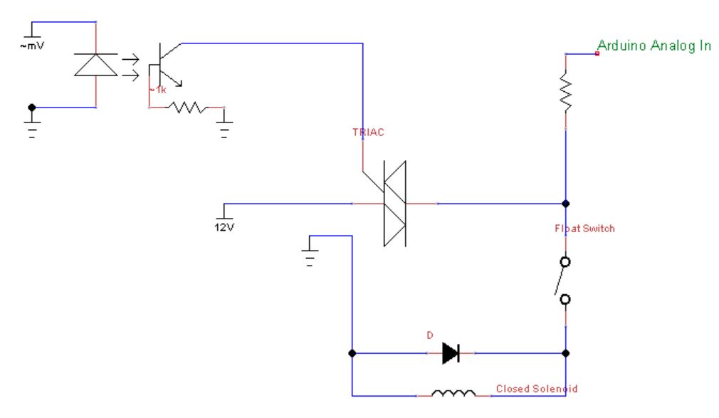

I'm building a backyard aquaponics system that has 4 beds that flood and drain one after the other continuously. I'm controlling it with an arduino, but I'd like to daisy chain the solenoids together so that they don't rely on the arduino to function. The arduino would then just be responsible for starting and stopping the system and monitoring other signals.
Step by step:
  1. Arduino outputs small voltage to optocoupler
  2. Optocoupler triggers triac -> triac conducts
  3. Solenoid opens -> tank fills
  4. Water opens float switch, breaking current flow ->triac stops conducting
  5. Float switch opens -> arduino stops voltage to circuit -> arduino applies voltage to next circuit.
  6. When circuit shuts off, solenoid closes -> tank drains via siphon

Your polarity is incorrect on the opto isolator input for a positive control signal.
The input LED needs to be forward biased.
There should also be a resistor in series with the opto input to limit the diode current to the desired value.
And for Mike's circuit, the opto transistor collector would go to 12V with the emitter to the 4.7kΩ resistor.
Leave the base connection open.
... the opto transistor collector would go to 12V with the emitter to the 4.7kΩ resistor.
Since Peter has to tie the Arduino-GND to the 0V-end of the 12V solenoid supply (so that he can sense the state of the solenoid), then why even use an opto-isolator?

I would run the Arduino on the 12V supply (let the on-board regulator do it's thing). That way, the GND takes care of itself.
Thanks so much for your advice! I tested the circuit, but unfortunately it's not quite what I need. The solenoid needs to open (filling 1 of the 4 tanks) until the float switch is flipped. Then it closes (and the tank drains completely) until each of the other tanks has flooded and drained. The way it's set up now, the triac is constantly conducting. The triac in Tank(n) needs to stop conducting when the switch opens, trigger Tank(n+1) to fill, and then not conduct again until it is triggered by Tank(n-1).

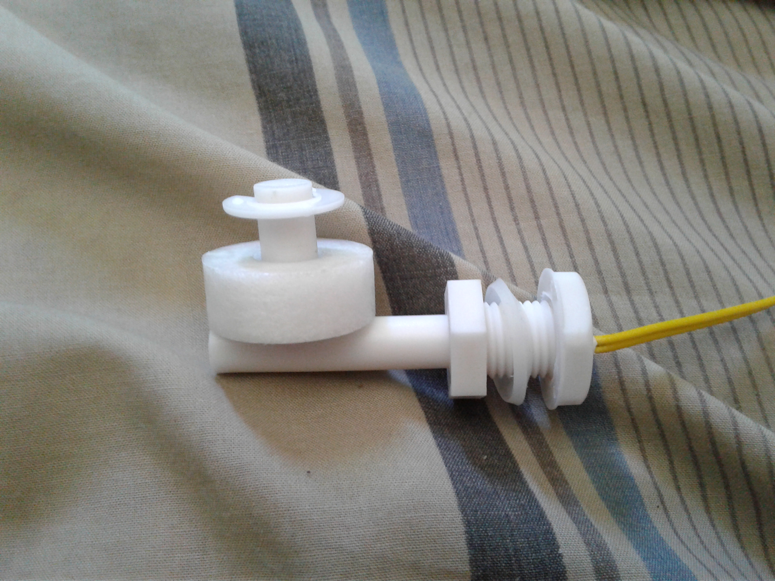

I'd like to have the solenoids autonomously trigger the next in line to start filling when the float switch is flipped (tank is full). Fill time is about 15 min and drain time is a bit faster.
Does your float switch have both N.O and N.C contacts?
It can be either N.O or N.C depending on the orientation.

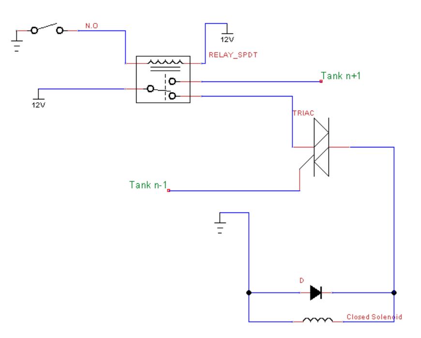

I could buy relays. So the relay would be N.C when the tank is filling, then the float switch would flip it to N.O when the tank is full(changing the next tank to N.C), and when the system got back around it would flip back to N.C?
If we use one relay per float switch, we can also make the relay latch and eliminate the SCR/TRIAC.
Would something like this work(no latching, w/ triac)?
What you suggested would be better since it's simpler, but I can't figure out how it would work with no triac.
The triac or SCR is the "latch". You have to come up with a way of triggering it on (the n-1 tank water level became "full"), and then you have turn it off (the nth tank just became "full").
A ring counter made this way has a lot of hazards. For example, what happens if more than one triac/scr comes on when power is first applied. Will it sort itself out and settle into "only one on at a time" cadence? Not easily.
A ring-counter made from four "latches" is a state-machine with 16 states, only four of which are useful to you, specifically 1000, 0100, 0010, and 0001. It needs an Arduino (or lots of discrete steering logic) to detect the 12 illegal states so as to put it into the legal sequence. This gets more complex than letting the Arduino sort it out...
