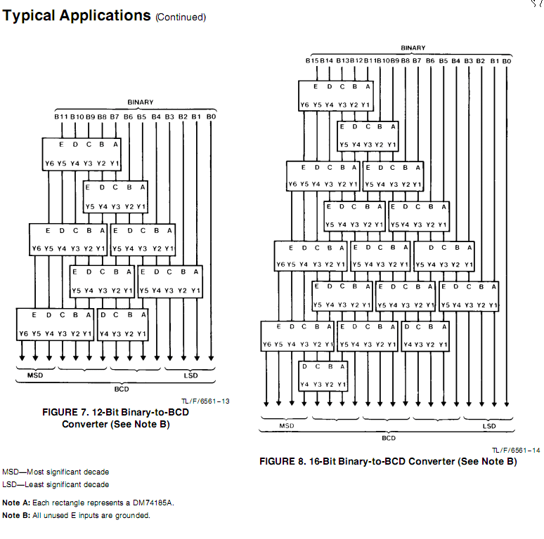

If you are able to get some 74184 or 74185 IC's you could make this circuit.

Good evening everyone :)
I had to make this account to thank MrAl.
You send me in the right direction to learn to make logic diagrams.
I have fun in solving Boolean expressions. Thank you so much!
I learned how to make the 4 bit binary to BCD converter, but now I would like to make it 16Bit.
Though writing a truth table that goes up to 720859 is going to take some time.
I think there might be a better way :p
Im guessing with shift registers? Ive try'd to google it but I cant find a good start
Could someone please point me in the right direction?
Thanks in advance
Teddy
