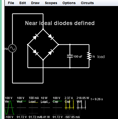

I dropped Vf and ESR on Diodes to near 0 but left capacitance so negative current spikes. ( high due to low ESR of 1 uΩ which is about right.)
I displayed V, I, Watts for both parts, where cap is VAR
Note: peak Cap current is due to duty cycle and ripple =/-4% Vp and cap 2.4 A-p and 218 VAR peak
Since Diode surge current is same as Cap, these are critical parameters in choosing rectifier parts for peak currents or ripple current.
Compute your results for Max and min levels and report back using 50Hz 1K 100uF
Note linear relationship between peak VAR of Cap and Pmin to load is 26:1 and Vripple is inverse of that or +\- 4%
Adding realistic ESR to diodes and cap adds a somewhat amplified sine tip to charge ramp voltage which resembles a fast rising triangular wave, (peak sine-following V to max then slow droop decay, so reality says with non-linear devices and no R or L filter, theory cannot be realized in tests.

My plots read
for R I = 100 mA max 91.7 min .. subtract 2 diode drops agrees with your 90 mA or ~ 10% drop with RC=10T ( inverse relationship agrees with my initial assumption. This should be close for 3T and more accurate for 50T but then Cap surge current is excessive
For C I = 2.37A peak during charge.. discharge will match V/R ( peak power ratios VAR/Pload seem more accurate than Ich/Idischarge linear inverse with Vdroop%

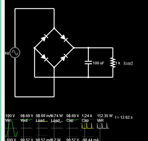

Adjust the diodes to 0.7V @ 1A or an ESR of 0.12 Ω approx.
Thus I cap= 1.24A max and min -98mA
I get this
Zooming into Cap current on startup for above.
We see Ic is 32x the load current of 0.1A and that's best case from 0 deg.
I get this

Only if you want to understand my Rules of THumb for Duty cycle, droop and peak current or power ratios. of charge vs discharge with a linear load.
As far as droop. I think my sim agrees with your calculations. at least close enough for government work...
Both charge and discharge currents for steady state and startup added
