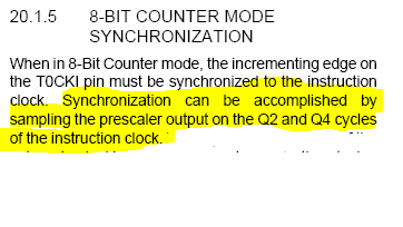

The datasheets recommend "synchronizing" the TMR0 counter to the chip oscillator when in counter mode.
Up to now, I have ignored doing that. A Google search on the procedure yielded non-helpful datasheets, such as DS51682A (not worth looking at). Basically, how do you sample anything at less than a full Tcy? How do you do the synchronization, other than accounting for the two instruction lag?

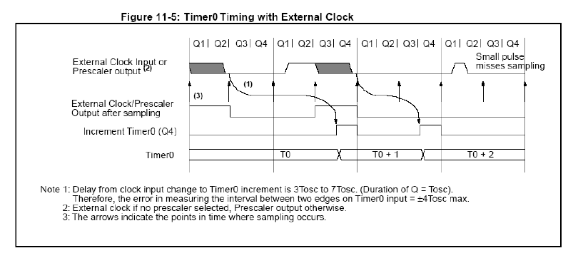

I'm not sure exactly what your question is but I have a vague recollection of a procedure to work out what the 2 LSBs were (past tense) of timer0. It was something like switching the prescaller incremented the 2 LSB and you could work out what they were from how many times you had to switch it before timer0 incremented. I've googled it but can't find anything.

In the past, I just ignored that and have usually used TMR1 for counting, capture, and compare. What caught my eye was the imperative just before the highlighted comment. It seems the user has to do the synchronization, so I searched on that and came up empty. Moreover, my recollection of the Fosc versus instruction cycle was this:
I didn't have a clue about how to "sample the prescaler" at Q2 and Q4 and do anything about it, if I could.

Again thanks for the information. After review, it appears the Ohio.edu lecture describes the "problem," but doesn't say what the user can do to effect synchronization.
I have a feeling most users just ignore that imperative in the datasheet to do something about it. And, so will I. My current plan is to count about 1000 cycles (2 ms), which makes the math easier. Target for the AS3935 is 500 kHz ±3.5% , so being off by a few ticks of the clock won't make a difference (MCU = 32 MHz with 8 MHz ceramic resonator for accuracy and 4xPLL). Tuning of the AS3935 is done by adding or subtracting fixed capacitors (a few pF each) with software, which limits how close to the target one can actually get.

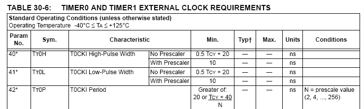

That section, in a rather poor way, describes why the signal you're counting must adhere to timing parameters 40, 41, and 42 in the timing specs.

I suspect this is the right table:
I don't know the exact pulse width put out by the AS3935, but will take a look once I access that mode of the chip. Since the 500 kHz is divided by the AS3935 by a minimum of 16 and maximum of 128 as a prescale (software selected), I suspect its output pulse width will not be a problem.

Your Tcy is 125-nanoseconds with a 32-MHz clock so the 2-uS period of that 500-kHz signal easily meets the (Tcy+40)/prescaler spec'.
Actually, the minimum period of the AS3935 output signal is 32 us (16*2) -- hardly a worry, unless it is a narrow spike, which I doubt . :)

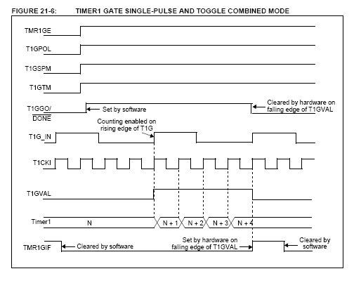

The simplest approach is to use the rollover to start and stop TMR1 to get the period and frequency. But, I want to be more elegant than that, if possible. Using capture directly with TMR1 is another option, and I have have used that quite a bit in other projects. It is Plan B.
My initial idea here was to use the overflow pulse from TMR0 to create a capture-like event while allowing TMR1 to run continuously or be gated by hardware. My interpretation of TMR1 timing is that the rollover event should be no different than any other event as T1G_IN is a common path:

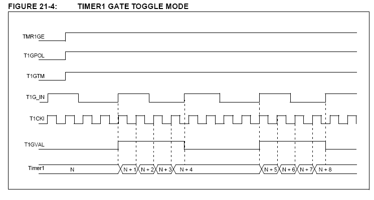

Initially, I was attracted to using the "toggle mode" or the "single-pulse and toggle combined mode," described below:

EDIT: 11:56 AM local Set up hardware simulation (signal generator + ICD3). Have only tested the single-pulse and toggle combined mode. Works as expected with input to TMR0. That is, on first rollover of TMR0, TMR1 starts and on second rollover, it stops. Monitored both TMR0 and polled T1GVAL.
Using MPLab SIM I got nothing. For example, T1GVAL never changed.
Since the subject came up here, I thought I would post some code rather than start a new thread. The following works, but is just one of several versions that can be used. Refer to the timing diagram for the "single-pulse and toggle combined mode" in my post #13.
