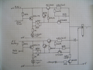

Summarising, I have two probs at present. One, if I reduce the Time for "Fire", the solenoid doesn't Open the "mushroom" and I need to increase Time to about 4 ms minimum. It should act much, much faster. (The mushroom describes a small ferrite piece - the solenoid acts on the flat top, and pulls a "stalk" up within its cylinder housing, exposing a bleed hole to a neck in the stalk).
Two, it is slow to close, so too much fuel goes in. (Two)is what we are dealing with in this dialogue and I think you have solved it for me.
The hard part will be finding a zener that will handle the current. Most are only about 5 watts. You need to be able to handle about 1.25 amps (50% duty cycle) Lets just pick a zener of 24 volts. So 30 watts. That leads to 6 or so 4 volters in series. If we knew the inductance we could use a snubber - The RC like you drew.
Inductance: of course this varies with current but an experimental injector, claimed to be good, built in the Univ New South Wales was said to be "rather high" compared to the Bosch unit, and was 2.3 mH.
Maybe L ~2 mH would approximate our coil.

Talking about getting rid of the induced current spike on switch-off, as fast as poss to allow quick end to fuel delivery, does the Zener go between the "bottom" of the coil and ground (supposing a Zener DID work ok) ?
I think it should - but you have put it between the 24 V source and the coil. That's wrong, surely?
NB My problem is to shut off the fuel injection when it should end. In the injection unit, fuel pressure is about 7 tons per sq inch !! This causes very rapid response from the tiny piston. But to act, a bleed hole needs to be shut and that's what the solenoid does. So it has to discharge very fast to collapse the field.
Current Generator - change
current-gen.jpgI have just realised something. When the coil is switched off, its polarity reverses. Of course, that helps close the bleed, because its acting on a ferrite actuator. (Bosch, FIAT, Ferrari, Delphi are clever folk).
Please help with this bit (Reply 87) : The "lower" circuit is the Hold circuit.
I will drop the Hold current right down to range between about 1 and 3 A. What do I do??? (What resistor do I change?).
You should be able to adjust the 220 ohm pot.. But, You may have trouble keeping it open at low RPM.
With my circuit, would that bring the HOLD current down as far as ~2 A ? Surely I would need to increase the fixed Resistance in parallel with the pot. And if so, to what?

Next, I found a very low value for the injector Resistance. Its about 0.15 Ohm - exactly the value found in a Russian (?) workshop manual for this injector. Also, the Inductance is also low, about 0.15 mH.
We think (again as you collectively divined) about 5 Amp FIRE lifts the plate fast, and the HOLD can be much lower - exact value - not known.
We found (for whatever reason) we needed >15 V to make our circuit do its job. MOSFETS would (I am told) allow a 12 V input (why, I do not know).
But does anyone want to have a go at altering the circuit in Post 4, using MOSFET(S) ?
