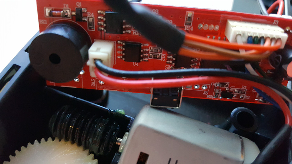

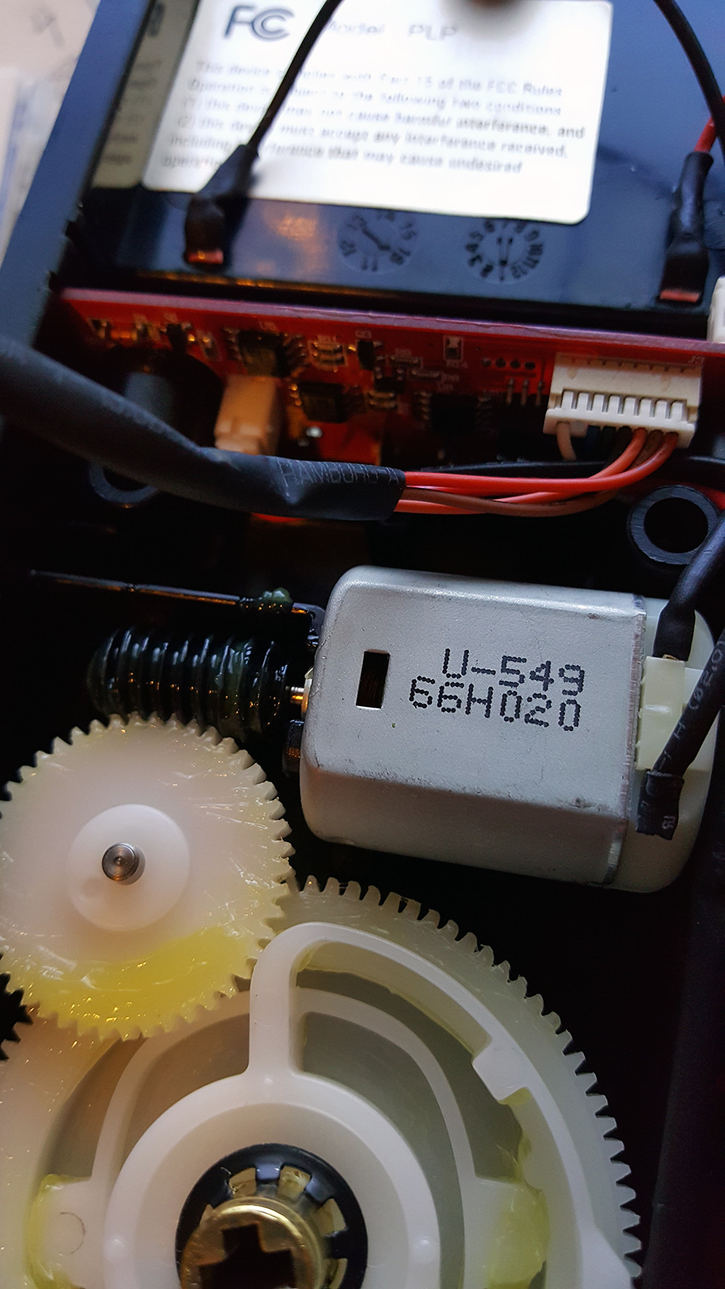

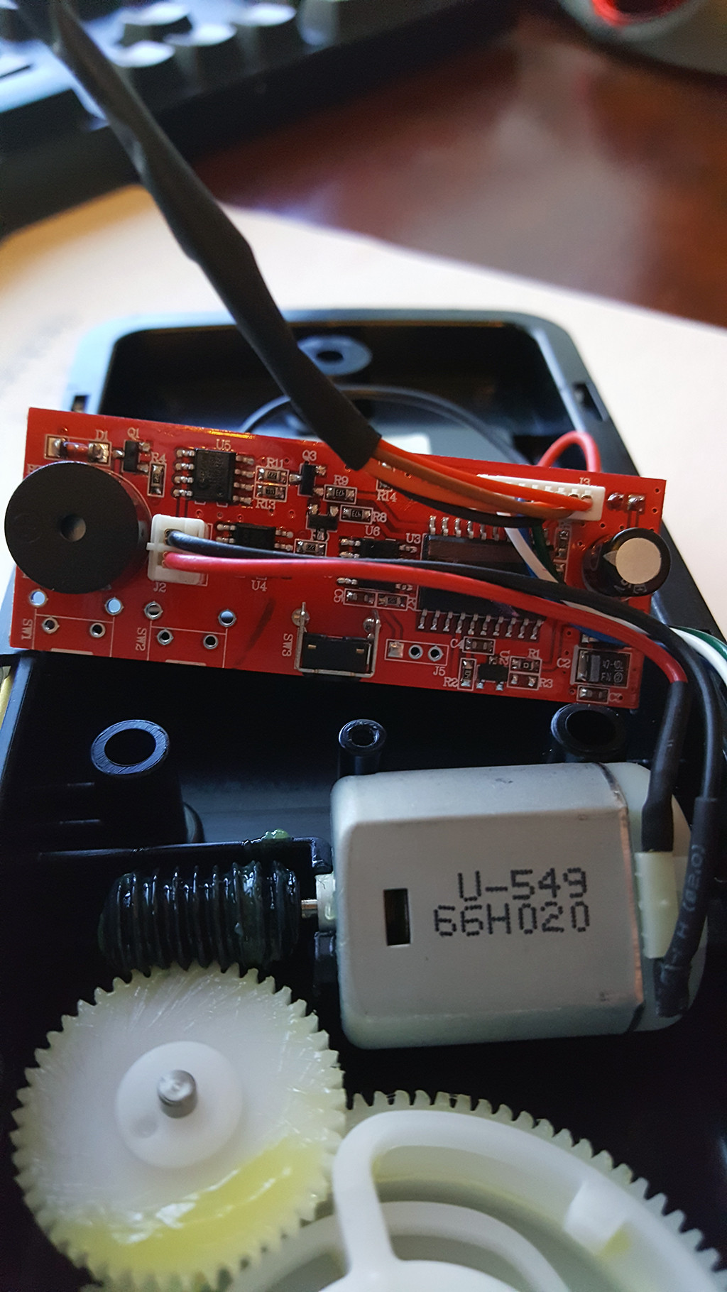

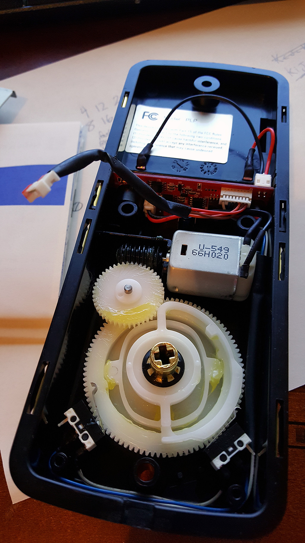

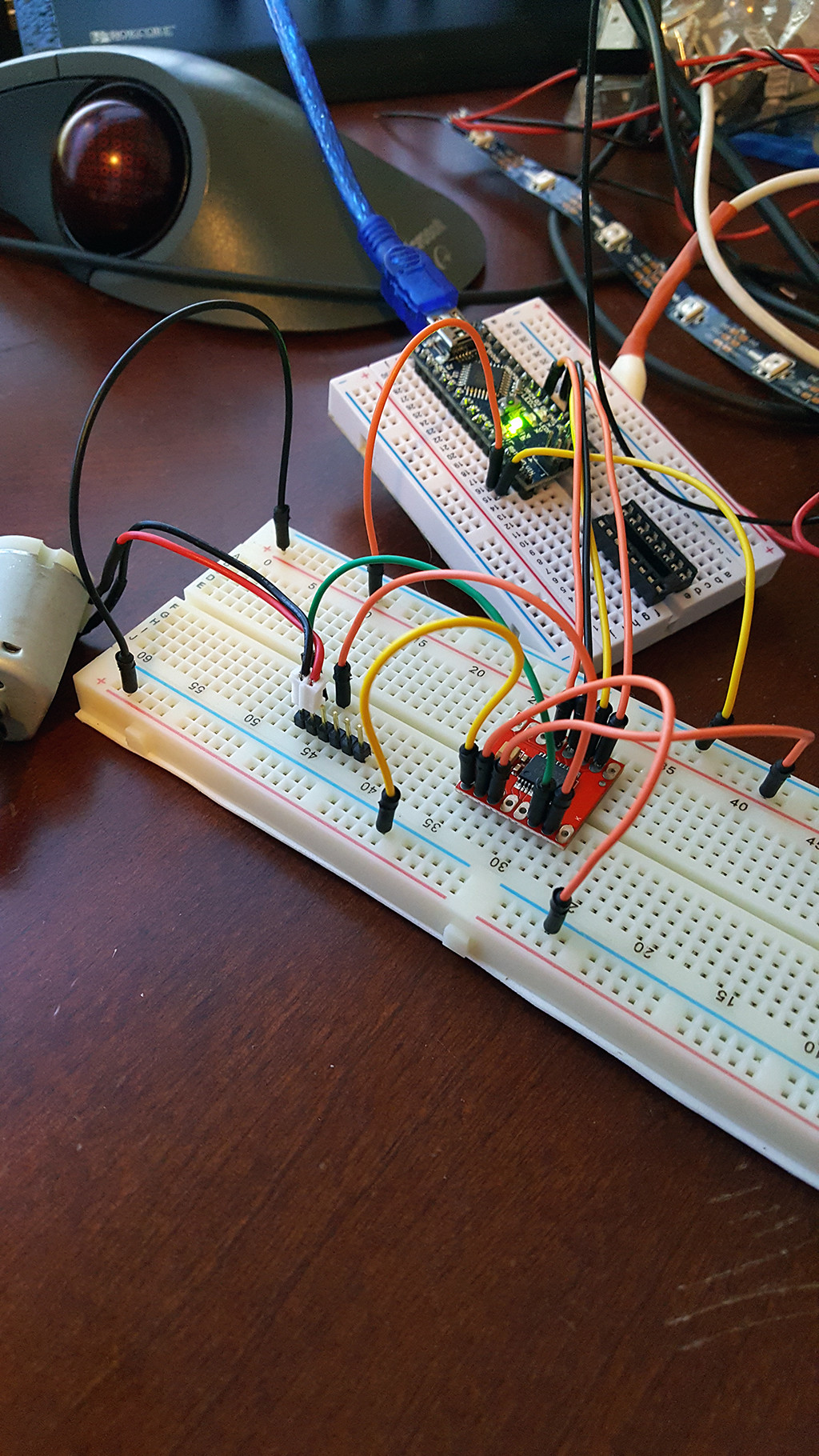

Hey all I am in need of some help with hooking up this little motor to the TB6612FNG Stepper Motor Drive Controller that I purchased. I am wanting some feedback on how to go about hooking it up to this deadbolt motor so that I dont mess up the motor. This board will be controlled by an Arduino.
The deadbolt insides look like this:

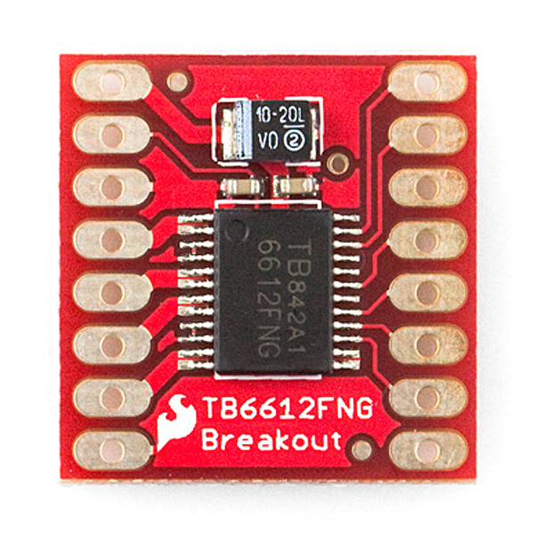

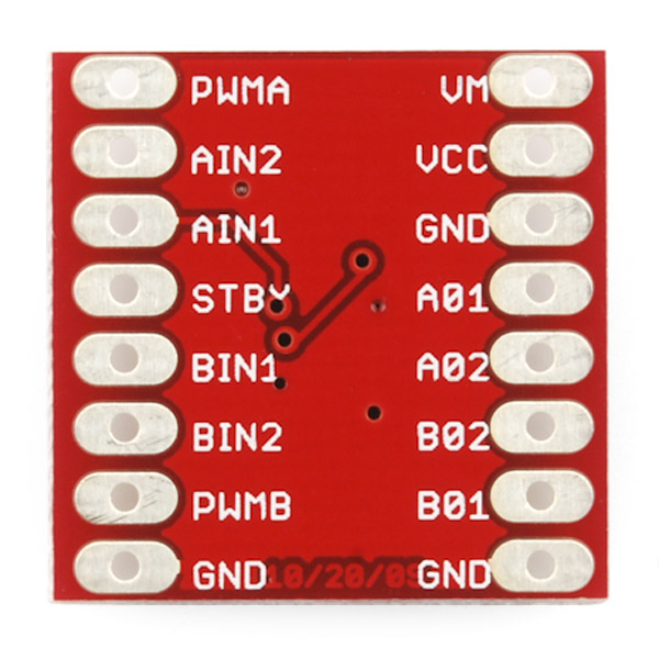

And the TB6612FNG is this:
Back of the board
Each pin and its function is covered in the table below.
     Pin        Label                      Function    Power/Input/Output Notes
     VM         Motor Voltage              Power       This is where you provide power for the motors (2.2V to 13.5V)
     VCC        Logic Voltage              Power       This is the voltage to power the chip and talk to the microcontroller (2.7V to 5.5V)
     GND        Ground                     Power       Common Ground for both motor voltage and logic voltage (all GND pins are connected)
     STBY       Standby                    Input       Allows the H-bridges to work when high (has a pulldown resistor so it must actively pulled high)
     AIN1/BIN1  Input 1 for channels A/B   Input       One of the two inputs that determines the direction.
     AIN2/BIN2  Input 2 for channels A/B   Input       One of the two inputs that determines the direction.
     PWMA/PWMB  PWM input for channels A/B Input       PWM input that controls the speed
     A01/B01    Output 1 for channels A/B  Output      One of the two outputs to connect the motor
     A02/B02    Output 2 for channels A/B  Output      One of the two outputs to connect the motor

And the data sheet on the TB6612FNG is https://www.sparkfun.com/datasheets/Robotics/TB6612FNG.pdf.
I found a great tutorial https://bildr.org/2012/04/tb6612fng-arduino/ but want to make sure I hook up the wires correctly for this deadbolt motor and thats why I ask someone whos more knowledgeable about these types of things to help me out.

Hi Ron,
That was my first thought when looking at the picture of the motor. I suspect that he just wants to us the H bridge to drive the motor in forward and reverse. As there was no information supplied on the deadbolt I did not reply. The picures appear to show limit switches but there seems to be too much electronics in it for it to work just by supplying power in one polarity to close and the other to open. Mayby he will post the information on the deadbolt.

You are correct. I just want to be able to open the lock and close the lock with the arduino.
The deadbolt is the Kwikset Powerbolt 2 Touchpad keyless entry. https://www.kwikset.com/products/details/electronic-locks/907-2-3.aspx

Start by defining all the "interface and power surge/steady and average requirements and power fail thresholds, signal immunity etc. fault detection etc. Then decide how to implement. Test it if there are no good specs with variable voltage range etc.. i.e. use a 50mV sized current shunt on gnd to measure I and V vs load force with your finger or some friction and how to avoid stall currents which will always be 10x max rated and same for full speed accleraton from start.

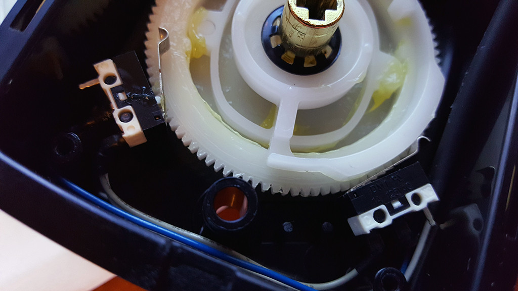

See if active current limit is used or detected with suitable external current limit protection. i.e. LDO current source to a voltage source for test purposes only. Check for max hot spot when testing with your finger or thermocouple, thermistor.thermometer. If too hot to touch, its too high. Current = motor torque and excess friction (jammed) will stress the plastic gears. The two gear tooth sensors tell me it should be well-protected and they are out of phase with gear-tooth position for quadrature sensing.
SHort Brake means the bridge shorts out the coil back EMF (either + or - V, so it stops fastest. STOP means it coasts to a stop with inertia and open circuit on bridge driver.
The motor is a DC brushed by the look of it, and the TB661FNG is for controlling two DC brushed motors according to specs.

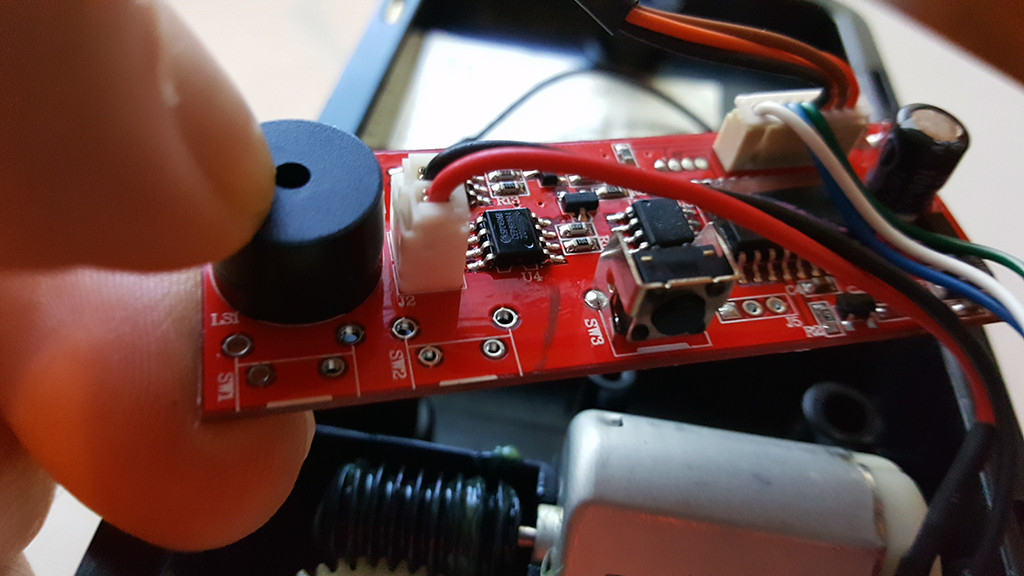

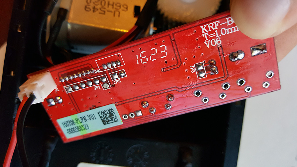

Are you connecting directly to the motor or using it with the electronics shown in the pictures of the deadlock ? Is the keypad shown in your link still going to be connected to the deadbolt ?
Les.
You will have to ensure that the existing drive to the motor does not conflict with the H bridge output. You will also have to add extra limit switches unles you can find a way to get signals from the existing limit switches. If I was doing this I would use two DPDT relays so the motor was disconnected from the internal electronics when your interface was being used.
Les.

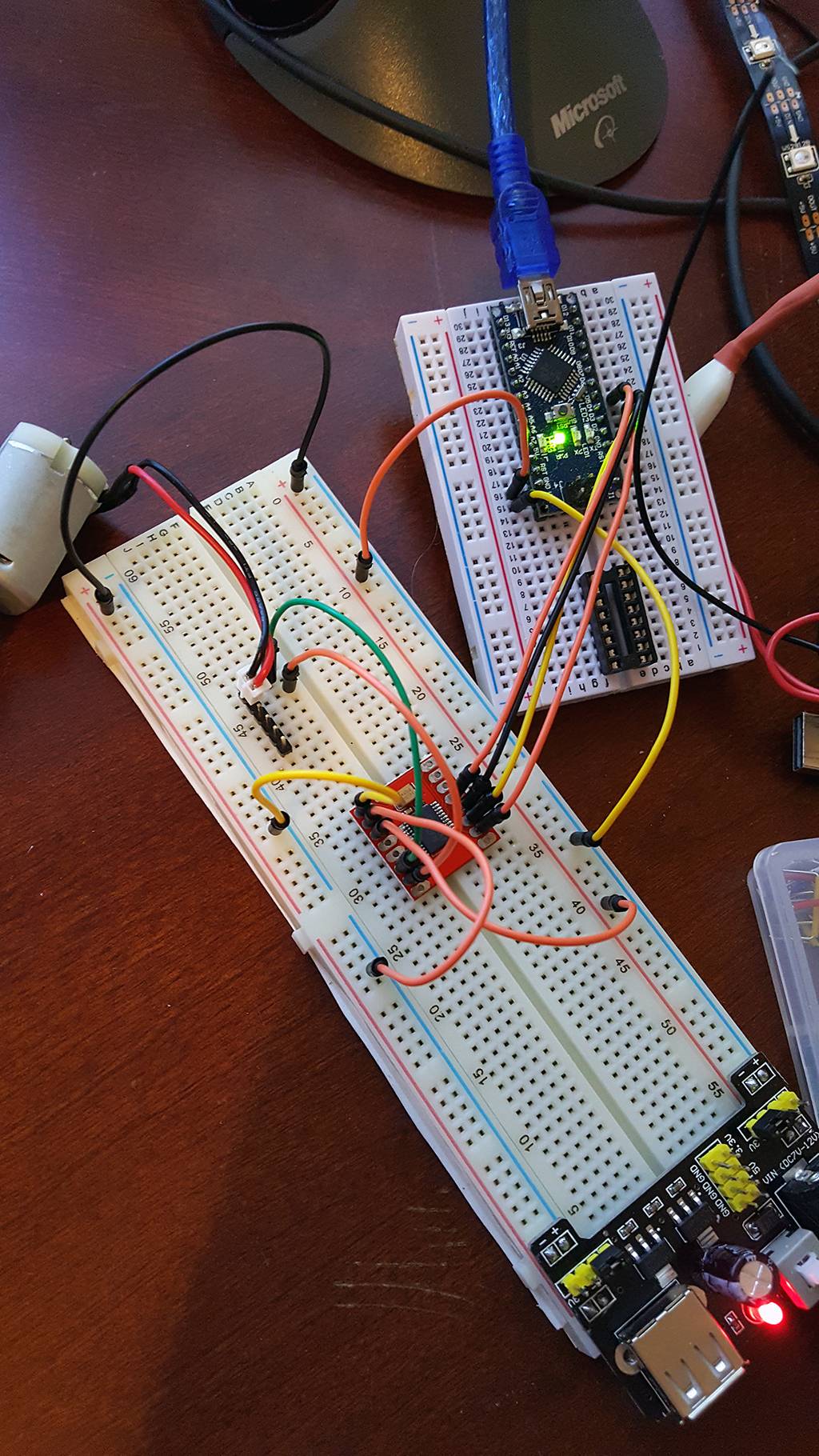

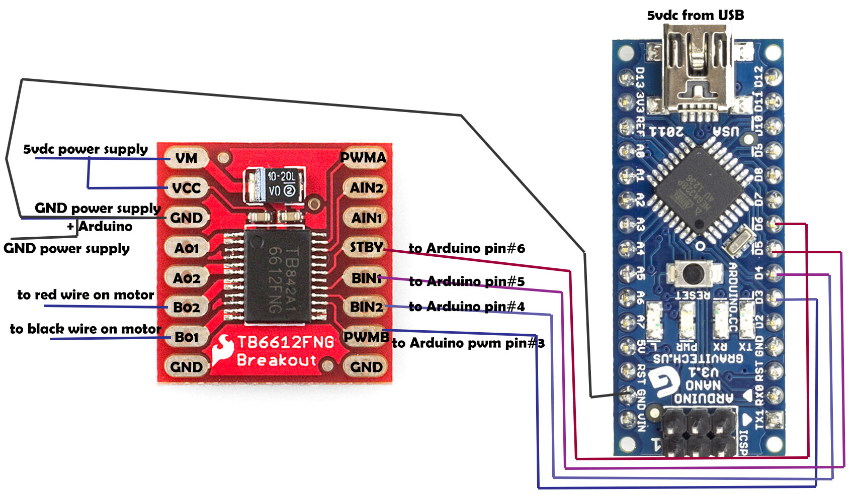

Well i hooked it up to the TB6612FNG and the Arduino and i got....nothing.

Ah it seems to be working now. YAY! :)
Just need to tweak the code a little and hook up the limit switches to the analog inputs and see if i get readings from them. That would just consist of grounding one side and running the other to the arduino analog pin, correct?

Alright so I finally got around to testing out the limit switch. Seems the Left pin is Gnd and the middle pen is voltage and the right pin is na.
Measuring the limit switch its 0vdc when not engaged and 3.3v when it is engaged.

You can use an analog in but the digital in would likely be the better way to go. Here is what I am getting at. Each micro (limit) switch has three terminals and they use two of the three. These are normally a Common, Normally Open and Normally Closed or C / NO / NC and either the NO or NC is tied to a ground. The voltage applied to the Comm terminal is applied through a 10K Ohm resistor (a pull up resistor). When a switch closes or opens depending on configuration the Common pin goes to either 3.3 volts or 5 volts (whatever the Vcc is. Now as to the Arduino I would give this link a read, Defining Logical Levels: true and false (Boolean Constants). You can use an analog in but what you really have is a digital signal, a Boolean True or False. It looks like you have 3 wires from the micro switches. The white appears to be common to both switches with the Blue and another wire I can't make out as the signal wires. I would measure Ground to the Blue and Other Wire when the motor is at limits and see what you get.
Also before I forget you will have a signal off a switch so consider switch bounce in there. You can't just say if analog in is greater than then... I would use a digital in and add a delay of 100 mSec to allow for switch bounce.

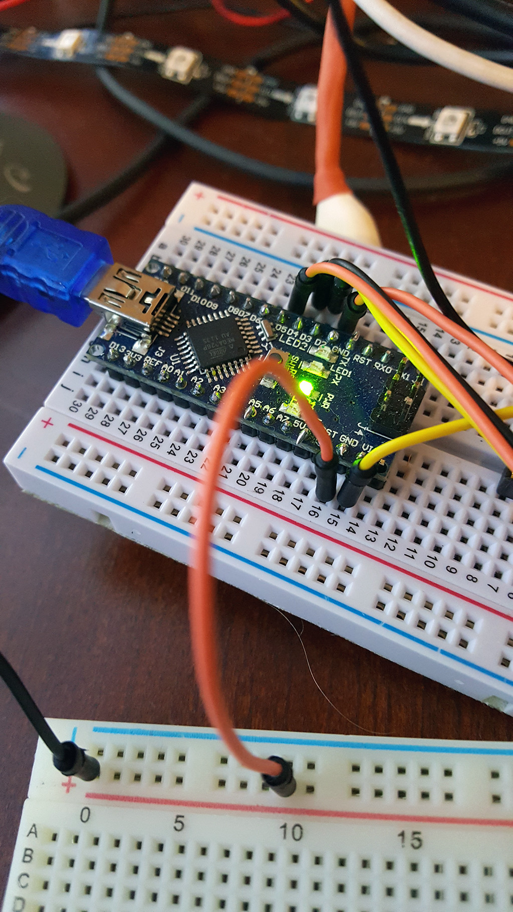

is this the correct way of doing it? of course it would be an esp8266 and not an Arduino board and using 3.3v instead of 5v:
My bad here, sorry. I have never used the ESP8266 which puts me at a loss. My understanding is you can do digital input and output but I have no idea how to set it up or code it. Hopefully someone here has some thoughts. I see examples like this one using a switch input.
Ron
