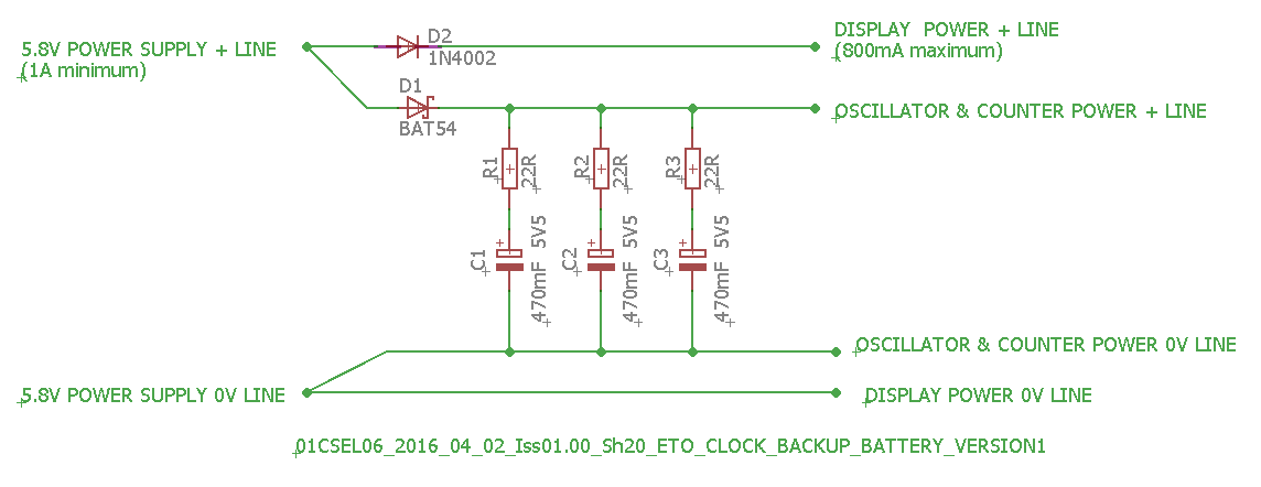

Just for the record: a supercap backup circuit.
spec
ERRATA
(1) Title along bottom should read 'Supercap' and not 'Battery'.
(2) Reduce supply voltage to 5.5V to 5V +- 250mV (wall wart).
(3) replace 1N4003 diode with a link (as a result of (2) above the IN4002 is no longer needed to reduce voltage to counter chips)
That could overload the power supply. When the capacitors are flat, the current in each resistor would be about 0.25 A, so a total of 0.75 A. If the display takes 0.8 A the whole lot would be 1.55 A. Depending on the type of the power supply, it might not work. Many power supplies would work, either by sustaining the overload, or the voltage would not reach 5.8 V for a few seconds until the capacitors are partially charged.
Also, if the oscillator and counter take less than 10 mA, the forward drop of the BAT54 at 25 °C will be less than 0.3 V, and even lower at higher temperatures (**broken link removed**) and so the capacitor voltage could exceed its rating.

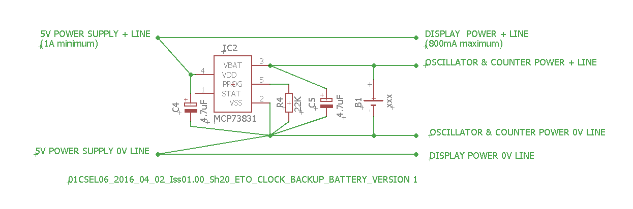

Here is a schematic for the battery backup approach.
The only thing is that the MCP73831 is hellish expensive: £0.43 UK :D:D
spec
UPDATE: 2016_03_29. This circuit will function, but if the clock is left unpowered for long periods the backup battery will discharge to a voltage below its design minimum. This can reduce the life of the battery. A revised circuit to take care of this problem and also to optimize the battery life is given in post #54.

(1) B1 now named as Multicomp LIR2450
(2) IC2 now specified as Microchip MCP73831-2-xxx (4.2V)
NOTES
(1) It is most important to get the earthing and decoupling right with this type of chip
(2) The 'Prog' input is very sensitive so the PCB traces should be as short as possible. Avoid stray capacitances.
(2) C4 and C5 are minimum values and can be ceramic, tantalum, or aluminum electrolytic types
(3) Supply voltage is 5V +- 250mV (wall wart).
(4) The battery charge current is set to 45mA which for a 120mA/hr battery should ensure a long battery life, especially as the drain current is extremely low.

Hi engineer,
Battery [1] above is the wrong type of construction for backing up a clock, where you want low leakage and not necessarily high current. It is a bit blood and thunder for this application, but nonetheless a useful battery, especially at the price.
Battery [2] is a nice package but the wrong chemistry, I am afraid.
Yes, I think the LIR2450 would be a good choice, especially as it can be stuck in a little holder and easily replaced, not that I would expect that to be necessary. It is not all that much bigger than battery [2] either. I will work on the circuit to optimize it for the LIR2450, if you agree. Even when the chip has been specified, so long as you stick with the same chemistry, you can change the battery model at any point anyway.
Note this is just an outline schematic and has not been fully analyzed
spec
ERRATA
(1) Title along bottom should read 'supercap' and not 'battery'.
Regarding the supercap version, note that the displays have a max current draw of 170mAh each, so that's over 1A for 6 of them :nailbiting:
This wouldn't happen irl though, the max current draw in the spec is when the numbers 0 and 8 are lit, but it's nice to know..
By the way, why is the 1N4002 needed in your design?

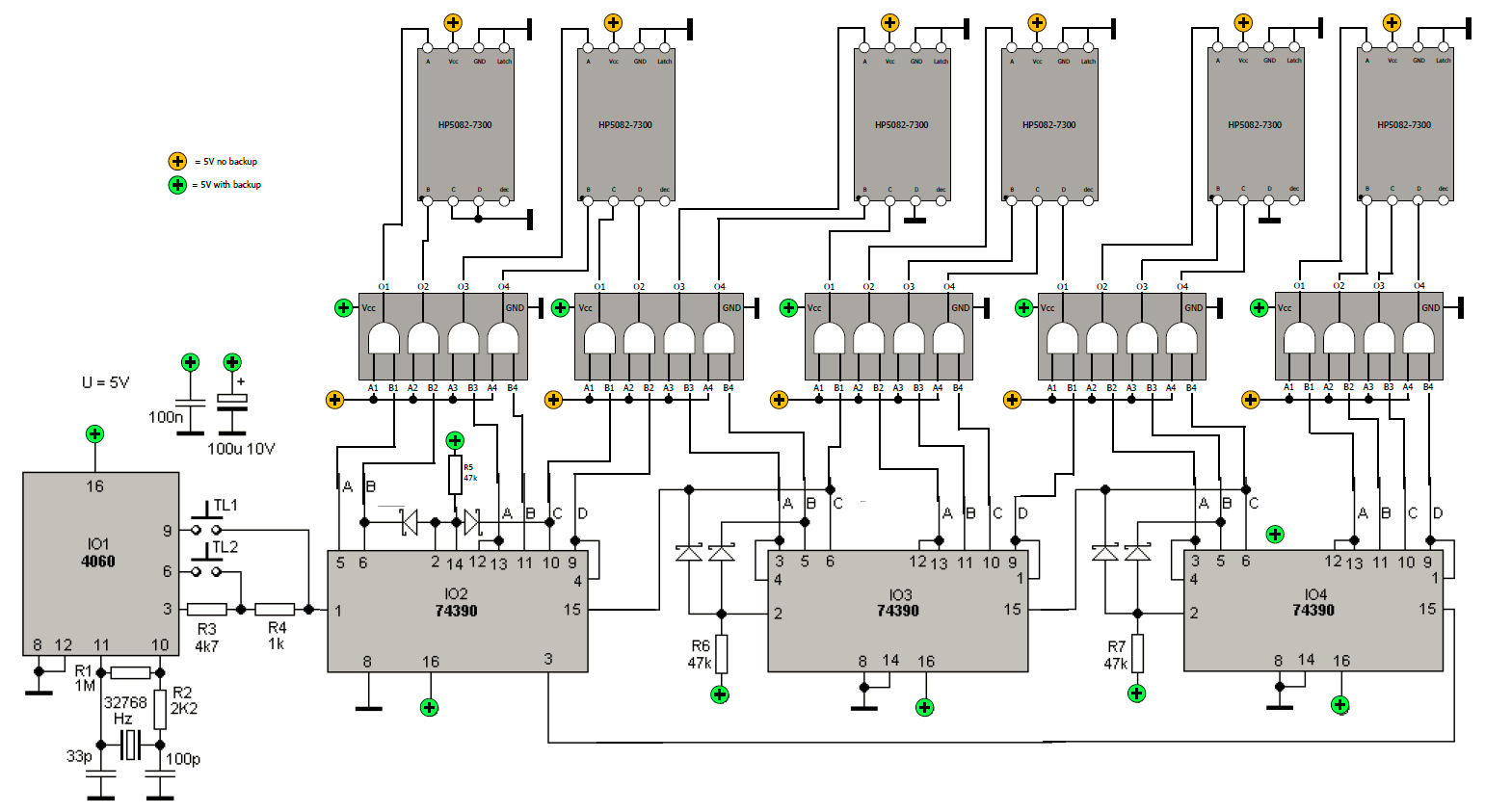

Here's the complete schematic with the AND gates (minus the backup circuit):
Hmm. On the lower right there's a runaway green +, pretend to not notice it and perhaps it'll go away. :facepalm:

I was aware of the special circumstance when the displays would be taking maximum current- it is just a worst case design consideration, not likely to be encountered in the real world.
The 1N4002 is only there to drop the 5.8V supply line to the display chips. On one hand I wanted to get the voltage on the supercaps as high as possible, ie 5.5V but that is also the maximum voltage that the display chips will stand. I will probably delete the 1N4002 and drop the 5.8V supply to 5.5V. This point was highlighted by Driver 300. Also the schottky diode will need beefing up to cater for the situation when the capacitor is fully discharged.
By the way, what is the power supply for the clock like? I would imagine a mains transformer/bridge/reservoir capacitor followed by an LM317 voltage regulator. I need to know because it impacts the 0V capacitor situation.
By the way, what is the power supply for the clock like? I would imagine a mains transformer/bridge/ reservoir capacitor followed by an LM317 voltage regulator. I need to know because it impacts the 0V capacitor situation.
spec
Regarding the power supply, I want to be able to use any 5V / >1A power supply - a simple "wall-wart" is the preferenced PSU. My current PCB layout even has a DC jack built-in. I don't want to have the power supply on my PCB, and I don't plan to build the PSU myself. There's too many chinese guys and gals that does that better and cheaper ;)
