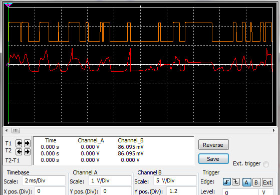

Okay, this is what I came up with. I only simulated it, have not built this before so no guarantee. Attached is a simulation I ran using a voice file as the input.
You can see the PWM varies with the voice which should brighten or dim the LED. You can substitute the JFET if you have trouble finding the one I used, just make sure it has a VGS of 5v or less. I also used a 5v regulator because the circuit would not function properly as the 9v battery dropped.
I included the netlist which should tell you what to connect. May be easier than following the schematic. It has been a long time since I have done electronics, so best if someone from here has a look at my circuit before you build it. Anyways, I hope this helps.

Very nice (but fairly complicated), Mike.
Doesn't your SIM program know that the minimum supply for a TL071, TL072 and TL074 is 7V?
Ah crap, thanks for spotting that. I will have to pay more attention, I started out with 9v and later changed that, maybe I ran the sim with 9v, but I can't remember. I will have to make a update and upload a corrected schematic. Glad you caught that, I'm such a dope.

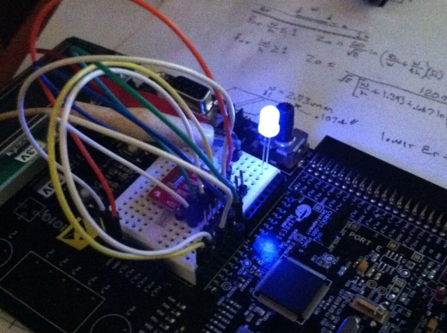

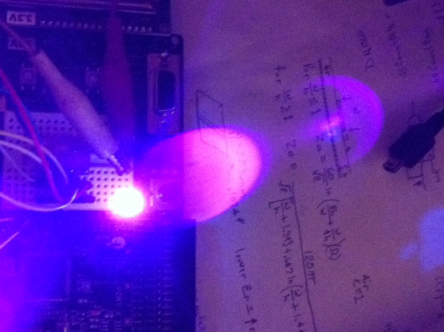

Having heard that there were purple LED's, I just had to see one for myself, so I went and bought a few. They looked more blue than purple to me. One interesting thing is the lens flare from my camera is purple. Here is a couple pics. My iphone is not good for shooting light but one can see the LED reflection on the pwb is blue. I wonder if that guy ever got his project done?
The lens flare looks pretty cool.
