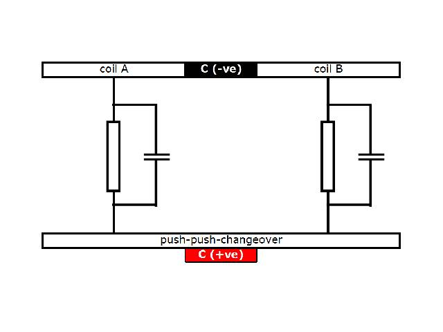

The simplest solution would be DC, with a simple push-push changeover switch, and a capacitor with a parallel resistor connected from each of the two outputs to the two points operating coils.
Power / positive to the switch common, ground / negative to the coil common. You should be able to easily find a 19V laptop charger (or universal replacement) on ebay to use as a DC power source.
I'd try eg. 1000uF 25V or 35V caps to start with and see if they give reliable operation. If not, try 4700uF ones.
They will pass current for a fraction of a second until they charge, then no current.
Add eg. a 1K half watt or preferably one watt resistor in parallel with each capacitor. That will allow about 20mA through the coil while powered which will not cause that to heat - the resistor will get warm though.
As soon as the switch changes to the opposite way, the resistor will discharge the cap ready for the next changeover. The only limitation with that is that you cannot switch back and forth very quickly, it will take 2 - 5 seconds for the cap to discharge to a low level.

Does this diagram reflect what ye mean? (polarity of capacitors omitted, and excuse rudimentary drawing from Microsoft Excel)
Ok, thanks.
What I don't understand is...... when a coil is powered during the charging phase of it's capacitor, why will it not continue to be powered (via the resistor) after the capacitor stops passing current?
It will, but the current will from one or two amps to 1/50th of an amp, which is small enough to be irrelevant.
eg. 1A at 20V would be 20W of heat, which would rapidly cook the solenoid. It also implies a 20 Ohm coil.
At 20mA (using a 1K resistor) the power dissipation would be around 0.008 watts, which is meaningless heat-wise.
As the coil is likely lower resistance, the heat at 20V would be higher - and the heat at 20mA even lower.

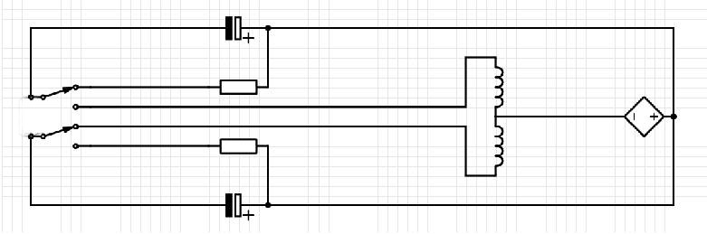

If you used a two-pole changeover switch you could use each pole to switch one of the caps between a solenoid or lower value discharge resistor, to eliminate the continuous current and give faster "reset".
I can't picture what ye mean by this suggestion. Can ye assist with a diagram, or further explanation please?
p.s. how the hell do ye know all this stuff???
Are you trying to use an embedded controller? Yes please make sure that you use a TIL111 Opto-isolator between the controller and the solenoids!
~~Cris
OK, one half, for one solenoid:
The changeover switch common contact to negative end of the cap. Positive end of cap to positive power.
Normally open contact to a solenoid; normally closed contact to eg. a 100 Ohm resistor connected positive.
The second pole on the switch works exactly the same, but exchanging normally open/closed so the solenoids operate alternately.

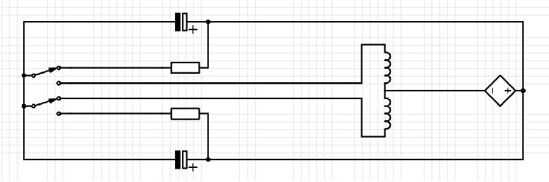

Almost; break the centre of the left hand connection so the two switch commons are only connected to one cap each.
That means each cap is either discharged via a resistor, or charging via a solenoid coil & pulsing that when switched.
Another point,for when you start constructing:
Add a diode (eg. a 1N4000 series rectifier) across each solenoid coil, with the diode cathode (banded end) to positive and anode to negative.
That's a "Flywheel diode", it prevents a high-voltage spike appearing if the connection is broken while current is flowing. It's a bit like an electrical equivalent of water hammer and can burn switch contacts or even break down insulation in coils.
