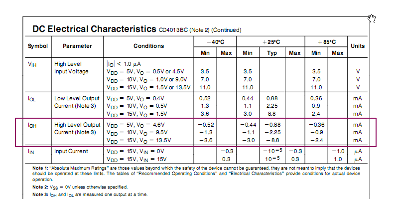

The simple answer you cannot keep the output voltage constant while increasing load current, its not a constant voltage source.
Look at this clip from the 4013B datasheet, showing the fall in output voltage for a given current.
This 4013 datasheet is a better quality print than your original.

what is Vo in conditions ?

Vo is the output voltage at the stated output current.

everything is working right but voltage drop at output Q will be beyond my understanding :-|
The 4013 is not strong enough to supply the higher current so it's output voltage drops.
